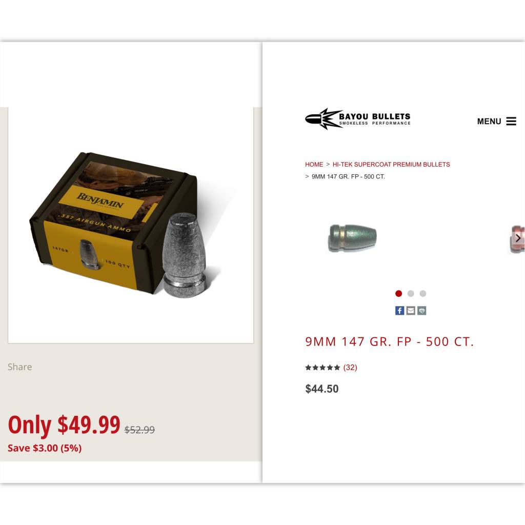

Just Seeing These Slugs Benjamin .357, 147 Grain
Looks like a decent hunting slug. I like the meplat. That ought to punch a nice hole. 100 for $49.99 that’s about $0.50 per slug. https://www.airgundepot.com/benjamin-flat-point-357cal-147gr-100ct.html

That's a better price than the Nosler, but I just don't like what I'm seeing. Are they lubed or is that the bare lead we see in the photo?

I hate to say this but, the airgun crowd is getting gouged to hell on big bore ammo. That bullet is the standard subsonic 9mm Para that has been used for decades. You can find it everywhere in 500 count boxes for the same price....maybee a bit more for the coated varient.
@babaganoush I’m not surprised. Do you have a link to a reputable source?
edit: They do look very similar
