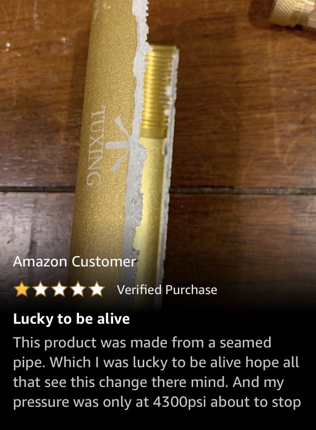

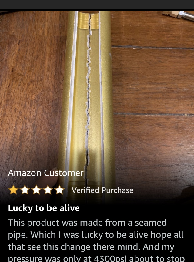

Just saw this catastrophic failure...thoughts?

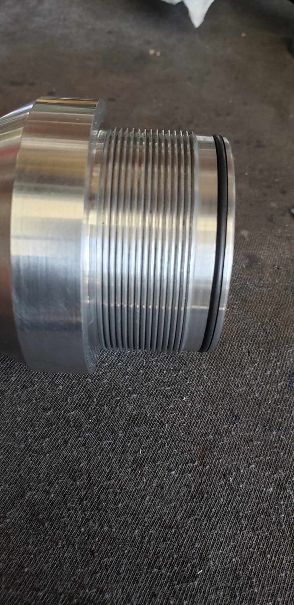

Also poor design. O ring should be in bound like this.
Haha I had thought that too because the seal is dependent on over compressing that oring

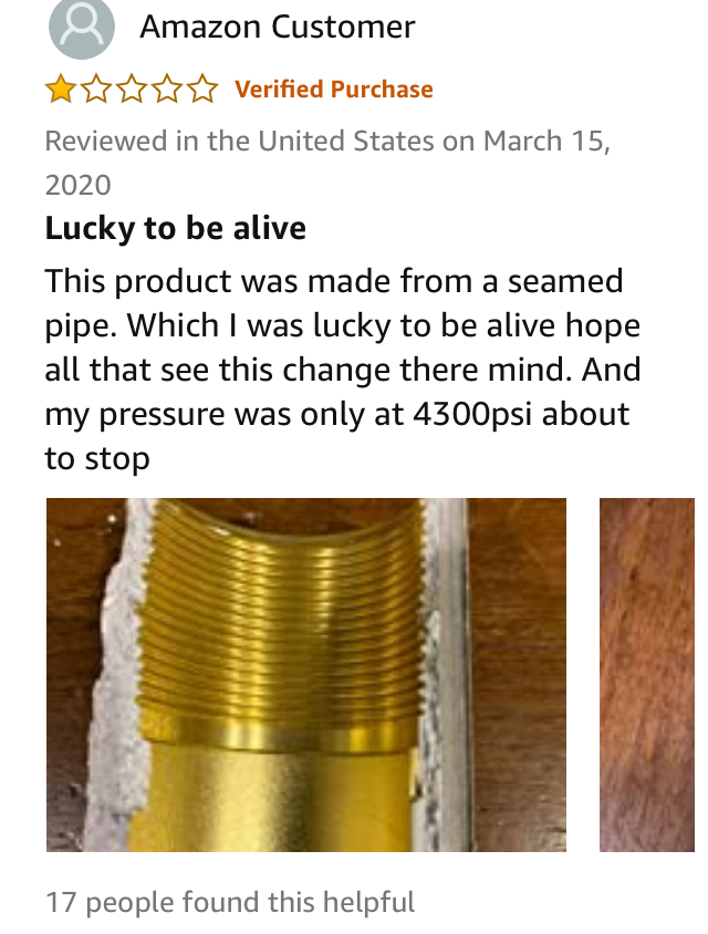

Here is the review in total. The date it was posted was March 15th, 2020, so it couldn’t have been the James you are referring to. So I guess that is two catastrophic failures potentially?
I would like to know too since everyone is referring this brand as the go to. But I wouldn’t expect a Chinese company to cough up and admit they have had some mini grenades go off.
https://www.amazon.com/gp/aw/d/B07KQVC5SZ/ref=cm_cr_othr_mb_bdcrb_top?ie=UTF8#cm_cr_carousel_images_section
Looking at the user reviews based on a lot of the member feedback here and saw this catastrophic failure that recently occurred. If it is indeed seemed, that is a big no no. Thoughts guys?
I'm calling this out to be bogus. The unit pictured appears to be cut and pried apart. I suspect that this was staged by a competitor that is losing business because his own product can't compete on price. These things are definitely not seamed. Look at the supposed seamed edge, do you really think that that edge was just butted together with some sort of adhesive? It would be impossible to conceal a joint like that. Don't believe everything that you read, folks.
Could definitely be bogus. I thought the same thing about a competitor. The seam is pretty torn though. Another possibility is the guy doesn’t realize how hard it is to seam aluminum, and that a stress fracture along the length of it blew open, and after he cut it on the opposing side and called the crack a “seam” when it was a fracture to begin with and nothing to do with a seam. Combine that with someone else named James complaining a year ago, makes me rethink this purchase. Does anyone know what James post is referenced above?

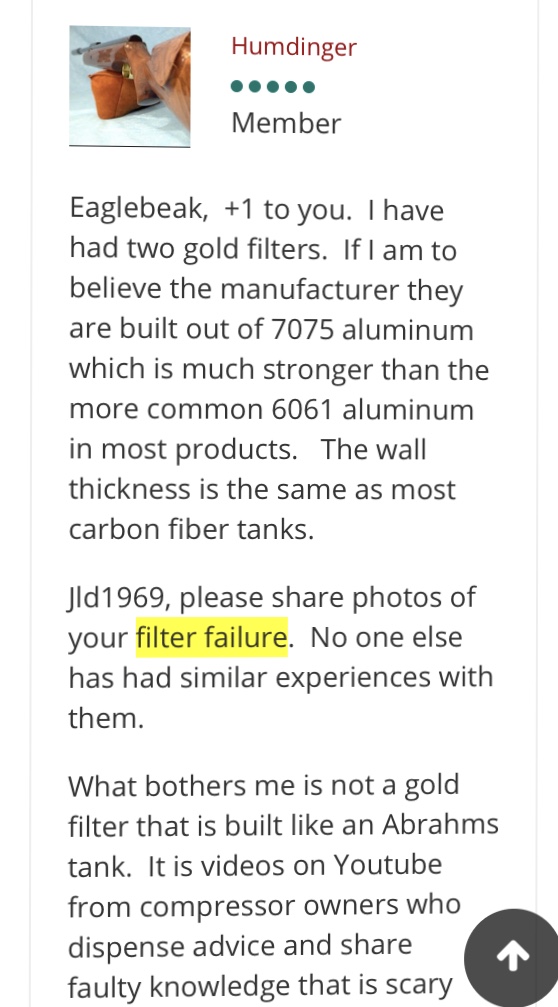

@Humdinger
...I searched around for your claim about a guy named James, and found that you’ve mentioned it a couple times and you also had this interaction, with this username, and it appears the member is still active here. I searched his threads but didn’t see that specific post on any of his threads. Can you direct me if you have the original post? Thanks.

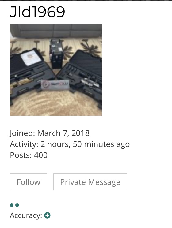

@Humdinger I finally found your conversation you referred to earlier, and the member that you mentioned is still active so I am going to PM him and invite him here. So that would be 2 cases now of the same catastrophic failure, based on what his post and this review are saying. Attached is the screen shot of his username and original post, as well as a link of that interaction:
PS looks like his name is John, and I have already invited him here...He is active recently so with any luck he will come over.

I remember seeing this thread before and the guy did not provide any photos of his blown-up gold filter despite asked by respondents.
I am definitely no expert on the subject but my understanding is that seamed pipes typically have relatively thin wall. Can think-wall aluminium pipes such as those used for making the gold filter be made with the same process ?
Hmmm then only thing that I can think of is that there must have been some kind of obstruction to build enough pressure to get them to blow up like that. Maybe a dead head at the end just to see how much pressure the compressor can actually build up and used the filter as a pressure test vessel. IDK....
Based on the thickness it couldn’t be seamed and polished that well on the inside. So the claim of seamed is out the window. Therefore, it would have to be a fracture and the guy on the amazon review doesn’t know how to identify the root cause/doesn’t know how to identify a seamed pipe ...perhaps some hygroscopic agent caused some deterioration in the aluminum’s integrity and a small fracture formed over a couple fills, ending with a sudden pop. Idk. Hopefully this John guy will come over and give us some details, as his experience looks similar to this amazon review but given the dates of this review it looks as though this is two different cases from the outside.

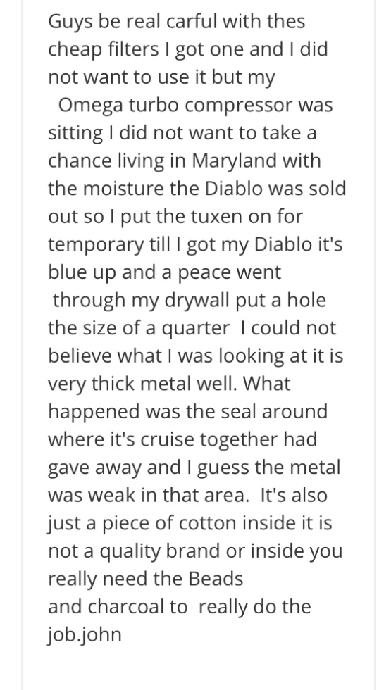

Hello guys after what happened to me and I shared my experience with everyone I had a lot of guys saying I was not telling the truth of what happened I still don't understand why I would make it up but ok?
I would have absolutely no reason to make something like this up I had a family emergency and had to fly out of town a day or so later after this post. But what happened to me was I got a tuxing but looking back it was gold and said tuxing on it but it did not look like the ones in this photo? mine was much thinner still 6061 aluminum but my cap threads was not very good or deep.
It broke at the end cap it sounded like a gun shot and a peace went through my drywall. I will never use Chinese high-pressure parts again after my experience when I got back home after my family emergency I trashed the filter. I just did not want to debate exactly like what's happening now they are a lot of guys who Love this Chinese filter and I was not wanting a argument over it I spend thousands of dollars on my air guns and I just did not think taking a short cut with moisture and rust was a good idea after this experience I learned a lot about filters.
I now use the Omaga filter it does a way better job it is tried and true I did not want to come on and start up with this group on if it was true or not but this group who obviously loves the Chinese knock off's. but yes it happened to me as well and I also seen similar things happen to a few more people once was enough for me.
I also have the same few guys and a lot of guys who also swears by the young hang compressor I had 2 and both was crappy but again I posted my experience and guys went crazy saying it's the best compressor and they have no problems at all what ever?? I don't like keeping buckets of ice and heat gages to see how hot it's getting not my cup of tea. but again the top half of my young hang blow apart it stayed together but air exploded out scared me half to death. The 2nd one would fill for 3 min and over heat so bad it would burn you even with ice water. Life is to short to go through this much work just to fill a tank or gun.
i can well afford a nice compressor and filter I don't need to take any chances on my airguns or my life over cheap Chinese crap. I got this compressors and filters when I was just starting into airguns but it was not long before I realized this is not the way to go I spend thousands on scope guns and why take a short cut on the most important part the air.
Also guys am a contractor who owns my own business I travel a lot I went to Japan and China on work and some play I Went to a few factories that makes roofing and building products to see the difference I did not go to tuxing co. As for where I live I have a home in 3 states so This is not a case of you said you live in Nevada but now you are in Arizona but now Maryland??? I work for the government on embassies so I travel a lot for work. It's not a fake account it's my life. 😂😂😂
My take on this whole situation is that both gold filter failure claims are bogus. When the original post was made the claimant's profile description said he was from Navada (sic). Then he was from Maryland but traveled to China to see the factory where these housings were made. Now his profile lists him as in Arizona. This is between 2018-20. He never provided any photographic or other evidence to back his claim. When challenged he went zero dark thirty. His numerous grammatical errors, misspellings, and words used out of context undermined his expertise a credible source for me.
The second review on Amazon doesn't list a name at all, just "Amazon buyer". The seam failure claim is ludicrous. The failure appears to be intentional and the housing appears to be manually broken. Neither claim holds up to the light of inquiry.
Airgun.cal, if you personally examine one of these cylinders you would see that they are extremely well made and have no seams. Don't buy one if you are unconvinced. It's a free country. There are literally thousands of these in the hands of compressor owners. My feeling is that both posts were fakes that were motivated to send buyers in the direction of competitors.

Humdinger The picture of that filter that I posted (NOT THE ONE POSTED BLOWN UP !!!) was actually bought from you it had the beads & charcoal wrapped in a thin plastic sheet lol I got it from another member . Going to send you a P.M. later . After looking at the filter inside & out it is as you claim very well built .I plan on using it , as far as the o-ring placement it seems that all these brands or should I say types of filters are in the same place .I haven't seen one with the o-ring on the end of the threads as someone has mentioned but would like to know that brand .No pissing matchs please just would like to see what others are using .
Agreed. Based on the picture you posted above, there is no way that it has a seam on it so that amazon review was false about the seam. My idea is maybe a fracture occurred on one side, and then the other side the reviewer cut open based on the straight edge.
@Humdinger, based on the images @Kayaker shared I would trust that specific filter easily, as I can see how thick that wall is. I think you are on to something with something being off about this whole thing, most probably, a counterfeit product.

Just my 2 cents but John doesn’t have a reason to lie. I also looked at his profile extensively, and he is a pretty trusted seller. The Omega is made in Korea, and I doubt he is working on Omega’s behalf in some cooperate espionage/conspiracy...kind of a silly accusation if you ask me. Your original post on this thread pointed at me as though I was John, when I clearly stated in my original post that I merely came across the review and images while shopping for a gold filter and asking for everyone’s input. If someone sees something or says something contrary to your experience they don’t automatically have to be part of a larger conspiracy. John was good enough to come over and reply to the thread about his experience, and if his post doesn’t persuade you that is totally fine, but coming up with a grand conspiracy is silly, especially since he hasn’t constantly mentioned it but rather only by request for comment.

Guys, I am an M.E. and responsible for failure analysis of castings at work. From the picture, I cannot really tell the failure mode, but looks like a bad casting "failure" or could be a stress point from thread machining of a bad casting. I have a Tuxing Oil/Water separator myself so I am definitely going to look at my unit very carefully. Most high pressure failure modes is due to hoop stress created by a stress raiser. If these tubes are cast as someone pointed out and the aluminum is of low quality and not made to ASTM/ASME Pressure Vessel Code ( I doubt it very much) most likely it failed due to a bad casting. I would be of the opinion that these Tuxing units are machined from solid Aluminum stock rather than a casting but coming from China, anything is possible. This has me worried now!
