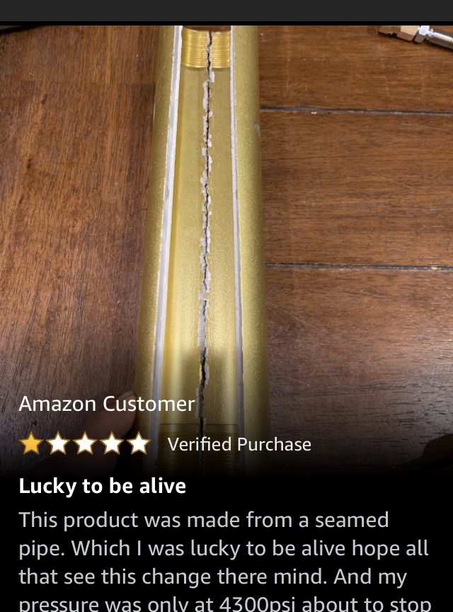

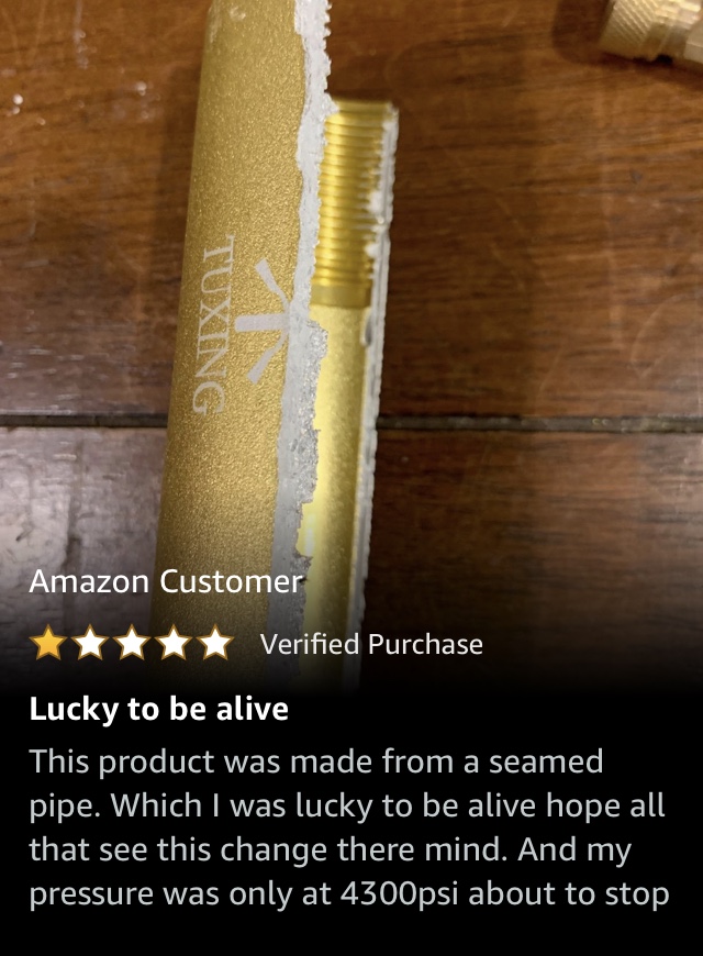

Just saw this catastrophic failure...thoughts?

I posted an update to the OP/1st page so as to inform people that the item I found on Amazon could easily (and most likely) be a counterfeit product based on the images other members have provided of their gold filter. I think that both things are true: the filters often recommended here are probably very strong like “tanks” as most people have experienced, and also a possible counterfeit product has failed potentially. Since various gold filters are available on aliexpress, most notably the Tuxer brand, and nearly all of them have a good reputation, I would wager that these two cases above shouldn’t tarnish their reputation unless more evidence comes out.

The only thing that is counterfeit about the unit that is in question is the way it has been portrayed as faulty. There is no way that a pressure-related failure could cause that type of damage. There would be evidence of bursting and distortion around the initial failure. There are a few different brands of this type of unit on the market. Some of the earlier models have a coarser thread. Otherwise, they are all the same. I get the impression that you are looking for a filter to use with a handpump. This type of unit is not suited for that use for the simple reason that it is too large. It will take more effort to pre-pressurise the filter than it will, to top your gun up. When you bleed the fill hose, all that effort spent priming the filter will be lost and you will have to repeat the process every time you fill your gun. If you are looking for a high-pressure unit for your handpump, look for something much smaller. The same goes for direct gun filling with a small compressor. It is just not necessary for such a large filter for the small amount of air required. There are much more appropriate units available.
