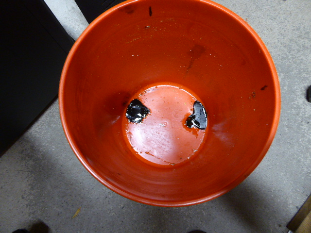

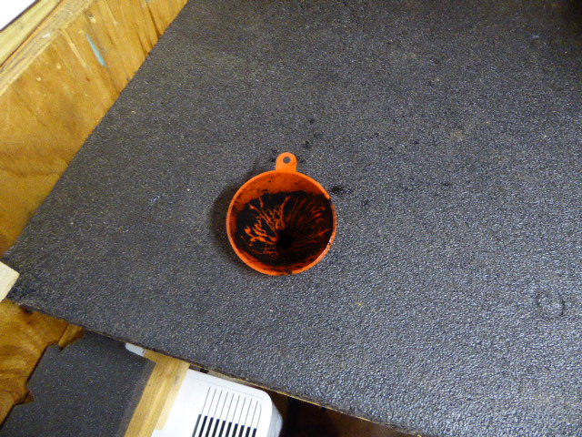

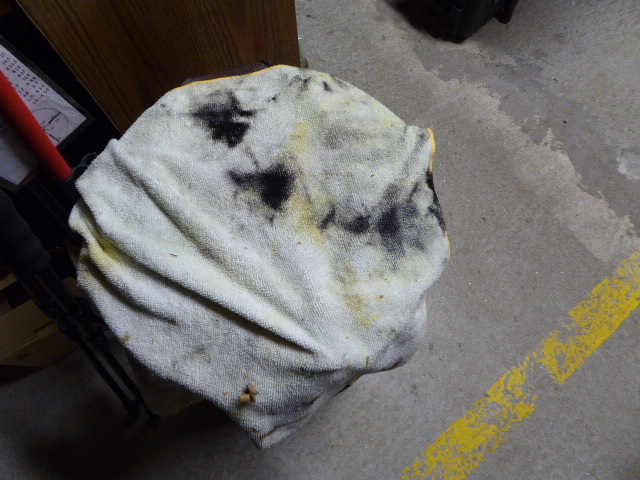

Jking, I am planning on getting it replaced. Thinking back when I did my 10 min breakin they ask you to do in the owners manual. I run it without being hooked to a compressor or dead head for 10 mintues. Every two minutes I bled the oil/water separator into a white rag and each time I bled it this black oily stuff purged out. This morning I went out and checked it over again. The new oil I had put in it was about 3/16 th of a inch below where it was suppose to be when I filled it up. I drained the oil out of it and refilled it again. The oil that came out was on the dark side and it was almost clear when I put it in. I turned the water pump on and then the compressor. I had put a dead head in the fill hose line to watch the temp and pressure coming up. I also noticed the water tank was still full but the water wasn't circulating through the clear hoses. About the same time the pressure guage was reading 3000 psi the clunk sound stated and immediately shut it down. The compressor never come close to over heating and about a half hour later I noticed the oil level was low again. So something is definitely wrong with this machine and from the breakin period. I'm going to take some pics of what was coming out of it from the breakin run and at 3000psi when I purged the O/W separator after I shut it down. First pic is the white rag I reference. The 2nd pic is the plastic funnel that the purge went into that was attached to a hose that captured and drained it into a 5 gallon bucket. The 3rd pic is funnel/tube setup into the bucket. The fourth pic is the results of the purge into the bucket after I shut the AV down. Sometimes pictures are better than words.
