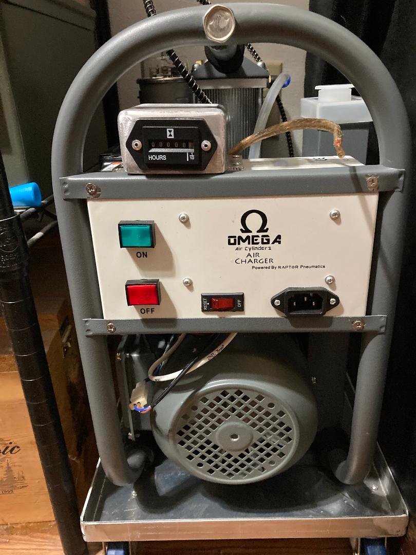

Here is my setup put the hour meter on and made a cart to roll it around when i need it

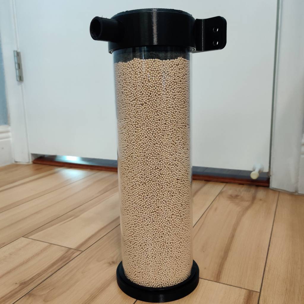

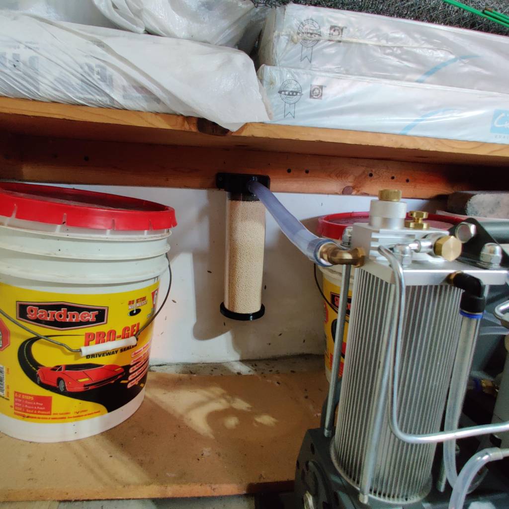

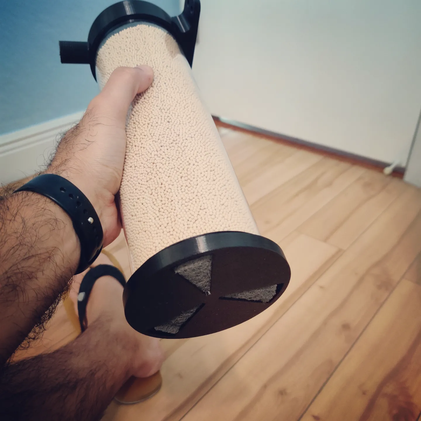

Just open the bleed valve slightly and fast while is pumping and this will release the water in the system, so far no water comes out with the filterI built for the intake, let me see if I can find a picture.

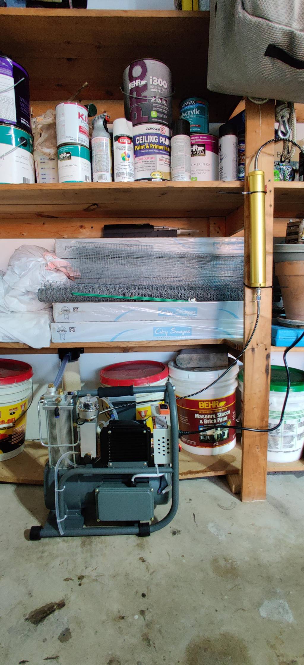

I'm filling the tank using the stickman from air tank plus and it's very straightforward, I just plug the hose I normally use to fill the gun, open the tank, pressure goes up in the hose, then connect the compressor hose to the other fill port on the stickman and fire the compressor, when the compressor pressure is higher than the pressure in the tank the tank will start receiving air, very simple.
So far very happy with the compressor. Fill the tank from 200 to 300 bar really fast less than 20 mins.
The other day a friend brought an empty tank, a 75 cf one. One hour run put the tank from zero to 200 bars, I stop it because I was busy doing something else and I like to keep and eye on it while running.
This was a great test for my filter. One hour of running without bleeding at all, at the end of the run, still zero water coming from the compressor. It was not a super FL humid day. Humidity will be higher in the next few weeks, will keep testing and learning before recording any video about it.
