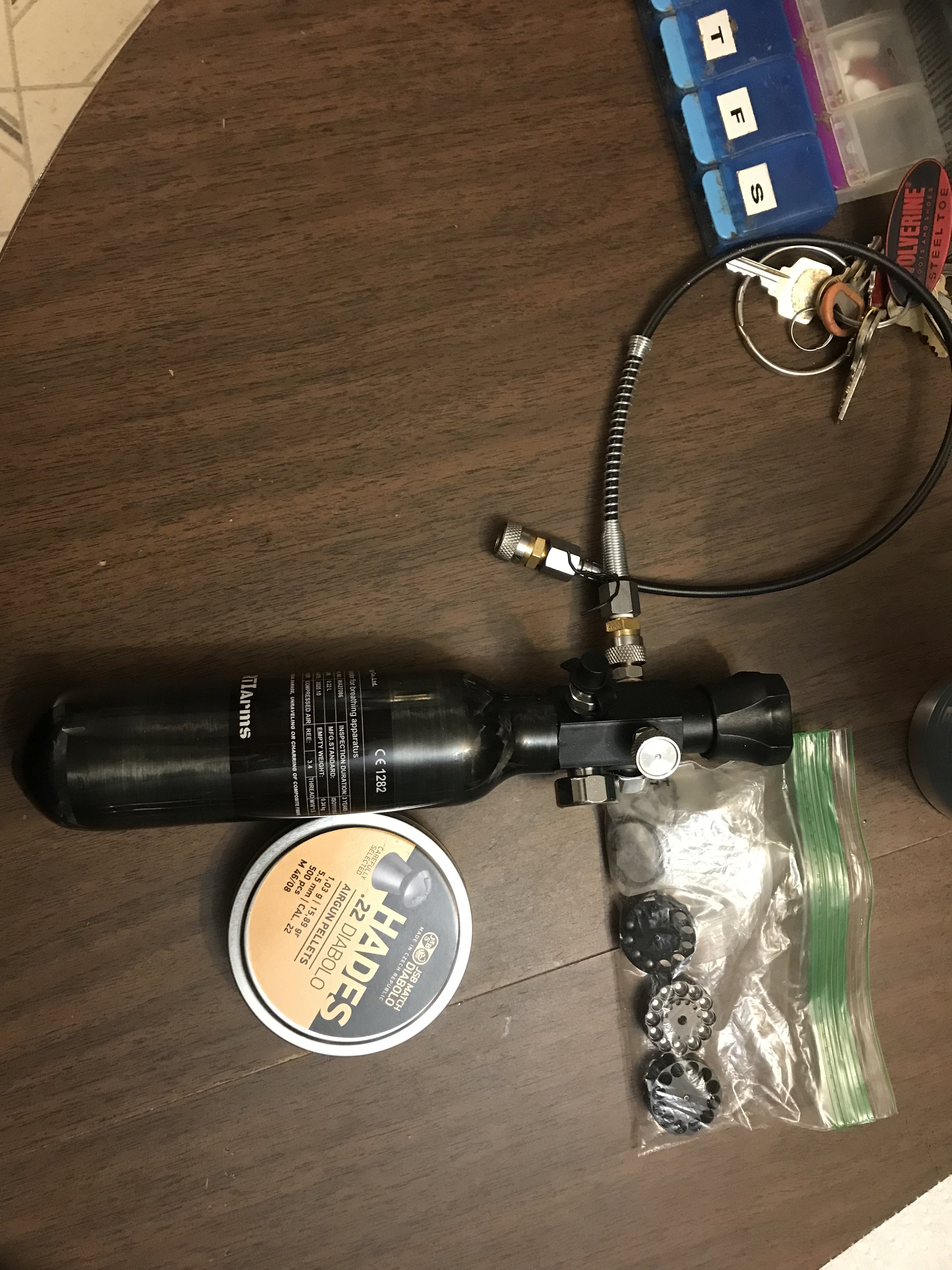

If I pull out one of my non bottle guns , Mutant,Veteran,Vulcan, oops not the Vulcan 177 it gets 100 shots per fill,
And I want to shoot 30 to 60 times , I put a valve on my little tank and it works for one fill, Maybe a little more had not tried seconds with it.
Alway thinking of the easy way, LOL.

Alway thinking of the easy way, LOL.View attachment 465413
Where did you get the valve for that little tank?
