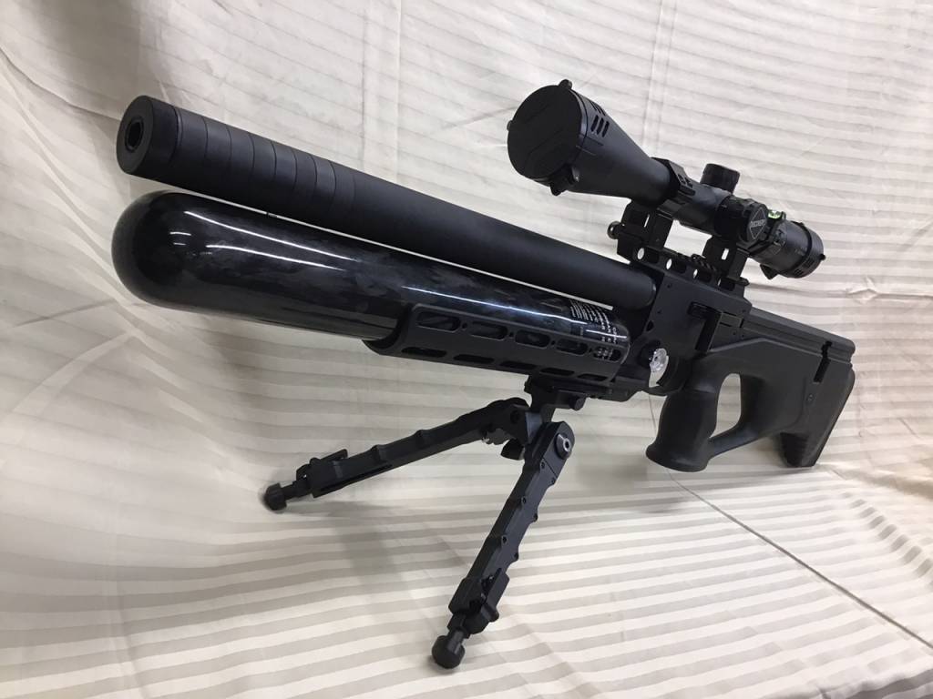

I’m so excited to have my new Uragan in my hands!
I want to give my first impressions but first give a big thank you to Tony at Talon Tunes for getting it to me! Thanks Tony, it’s everything I was hoping it would be.
I got the standard (not compact, not king) with a synthetic stock in .22 and had Tony swap in the Huma reg to get an overall larger plenum space. I told Tony that I planned to shoot pellets (not slugs) and wanted to be able to shoot up to the 33.9 grain Beasts to hopefully fight wind better when shooting longer distances.
I ran a small sample of the various weights I have on hand over the chrony just to see where we are out of the box as it came to me. I haven’t checked to see where things fall off the regulator to know where it’s set but Tony informs me that it’s not quite maxed out and there’s a little room to go up if I want to.
