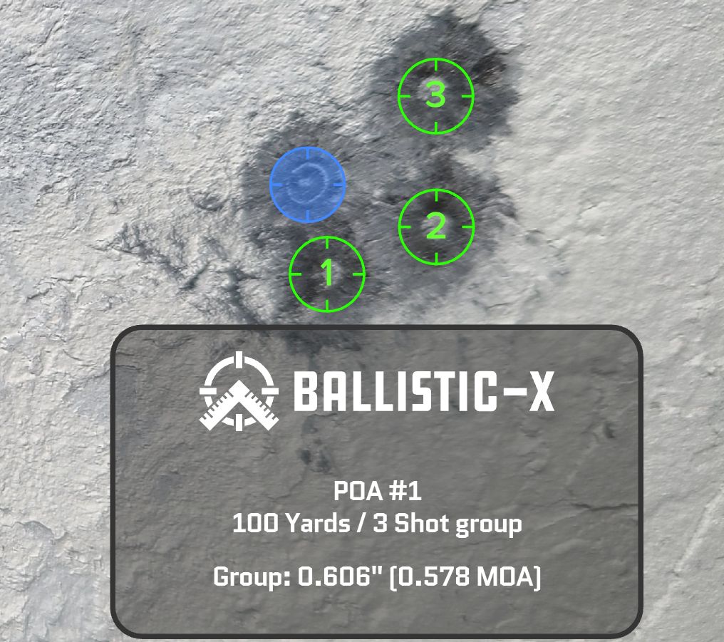

Ace 3 shot group to confirm zero.

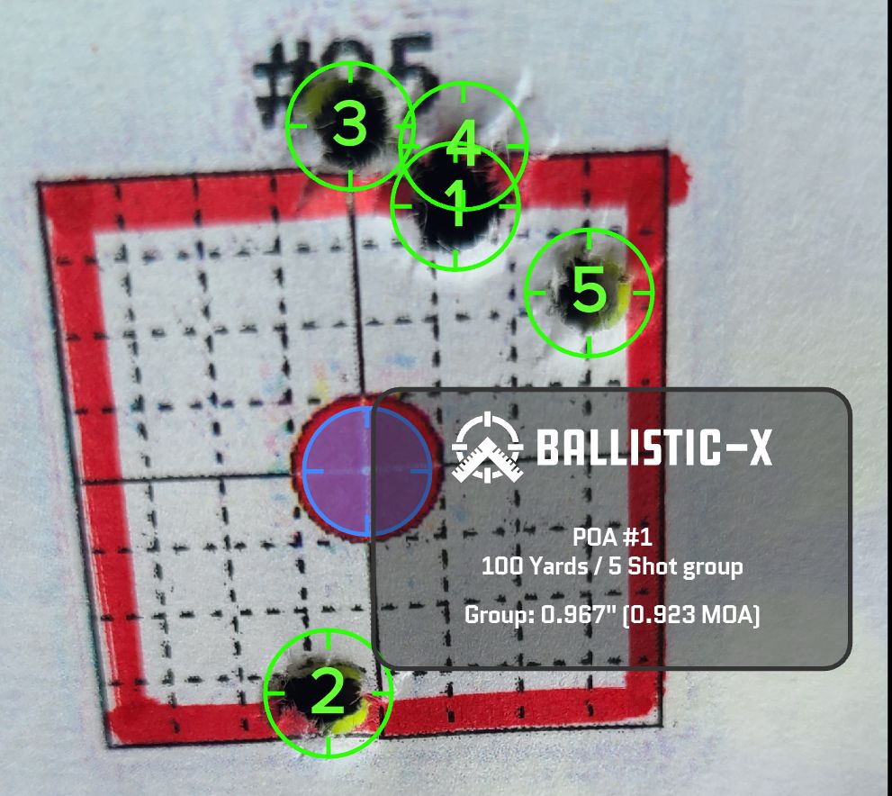

5 shot group that followed
I consider #2 shoot shooter error.

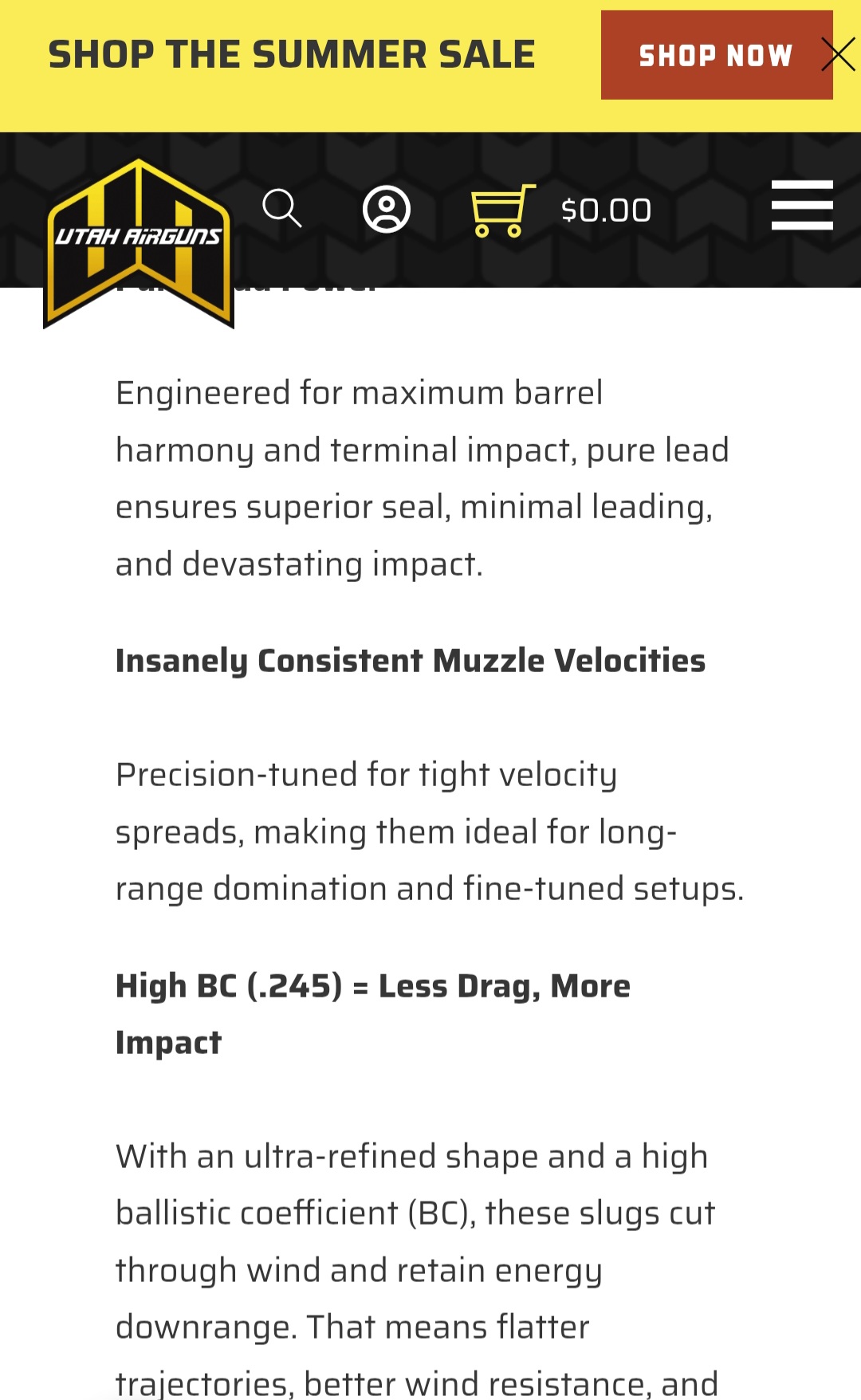

This is where I got the BC

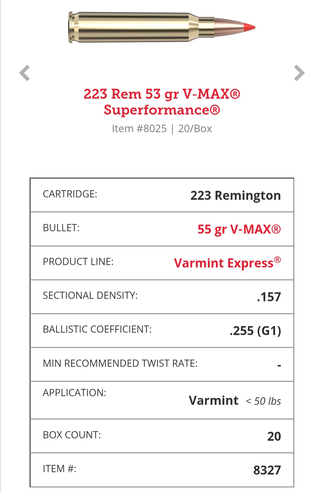

Could it really have a BC close to a 223 Remington 55gr V-Max ? ?
In Dub-dubs video, he got a believable 0.195 G1. Like I said in my previous post, mine was about 0.160 G1 from similar 1:16 twist 700mm barrel.
So 0.245? I do have a bridge to sell in Manhattan if anyone is interested 😂

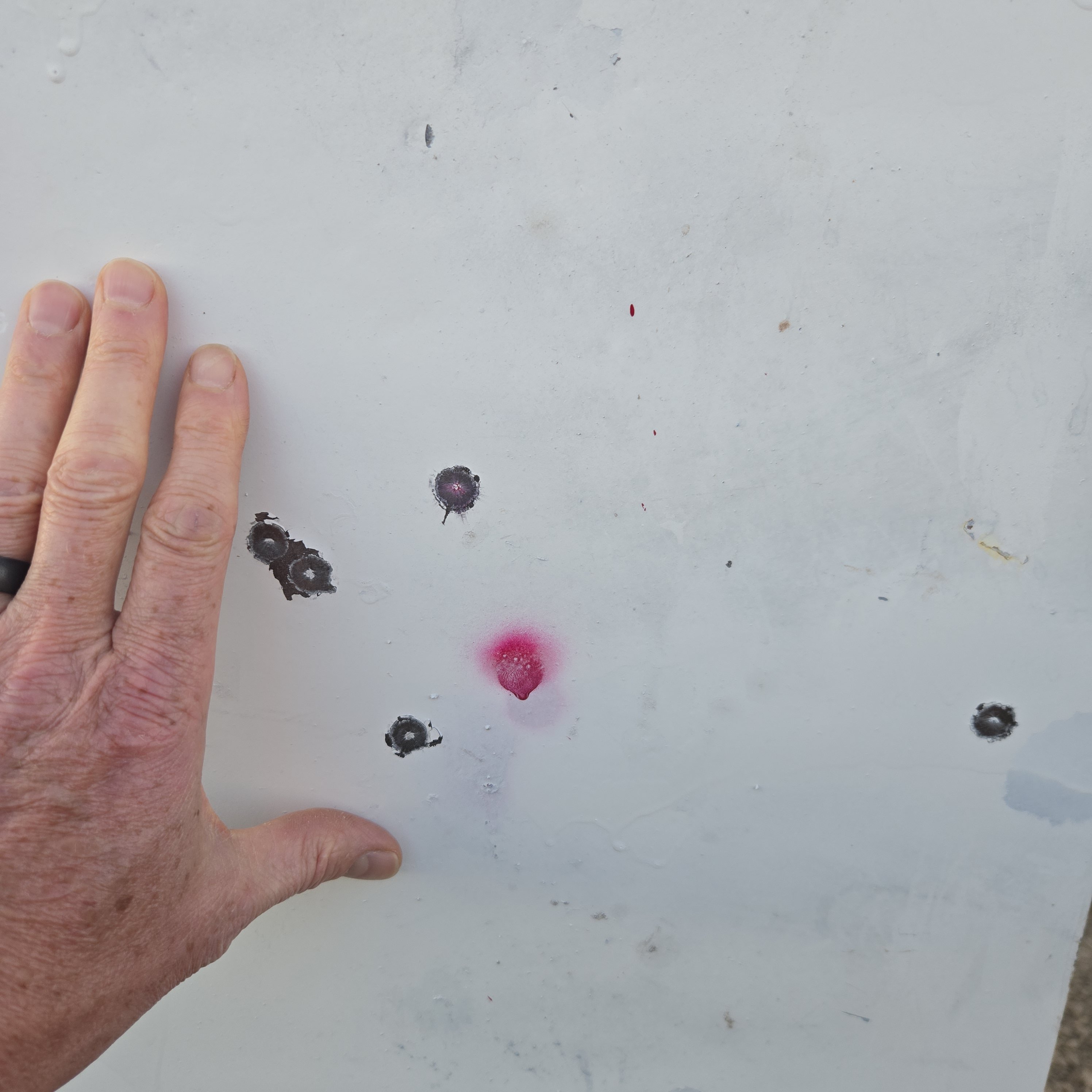

I got a chance to shoot these in almost no wind out to 400 yards. Out of my 700mm Panthera at 997fps groups at 400 yards looked to be right at MOA. I didn't walk out to measure but it was fresh painted steel. Very good groups for a liner that has less than 100 rounds thru it. My FX chrono had a BC average for these slugs at 0.244. I punched in my numbers into Hornadys Ballistic app and it also comes up with .24 as a BC using my dope. So I think they are very close to the Altaros slugs. But this is just my findings with one gun at one speed. But the more I shoot these slugs the more I like them.
