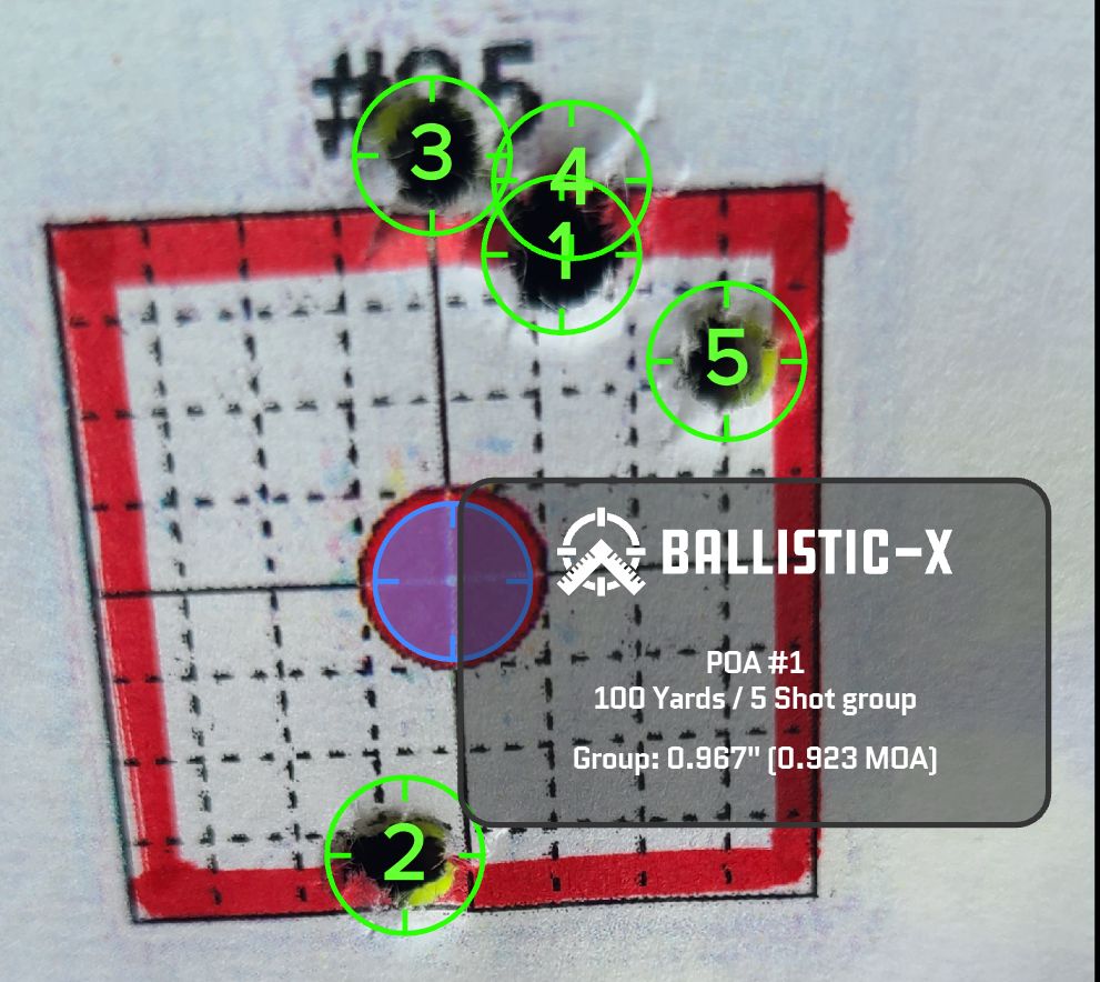

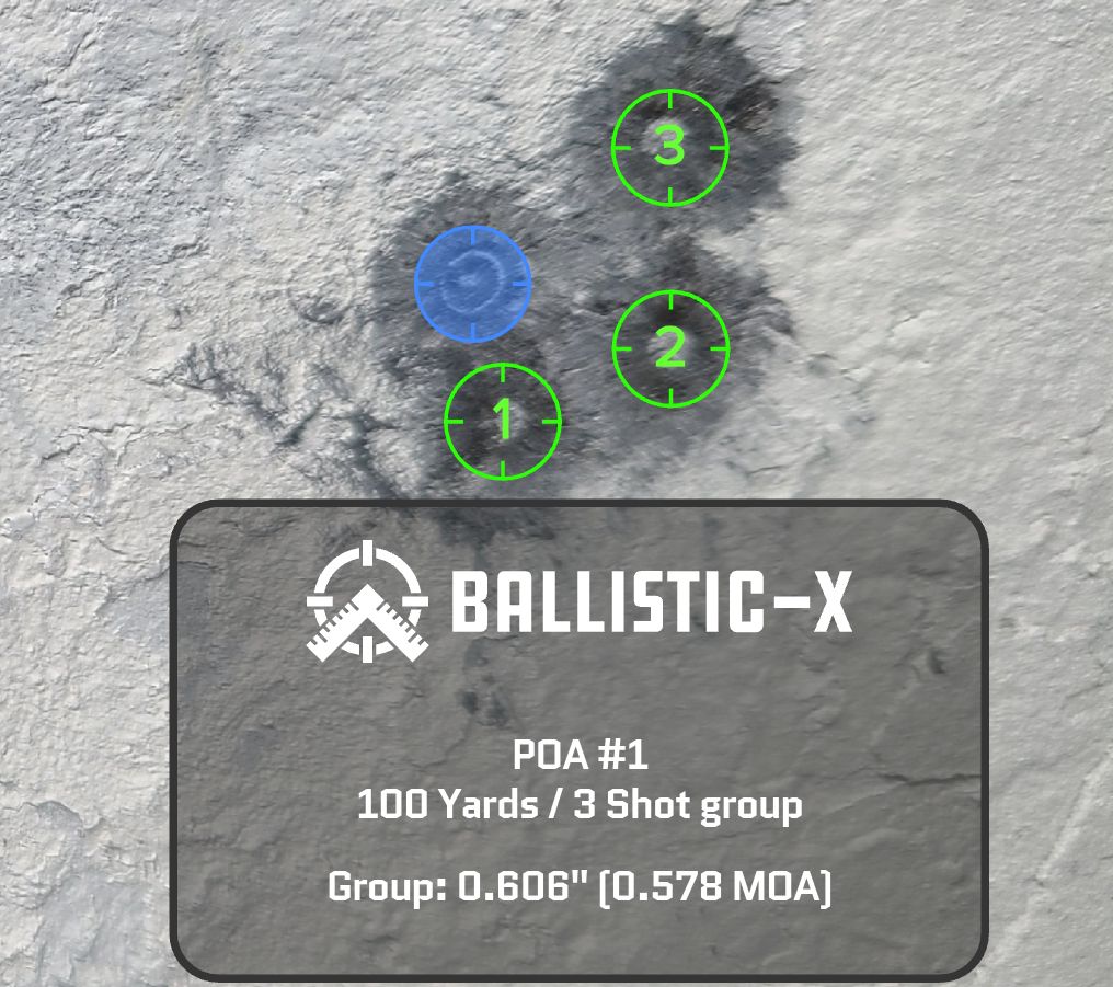

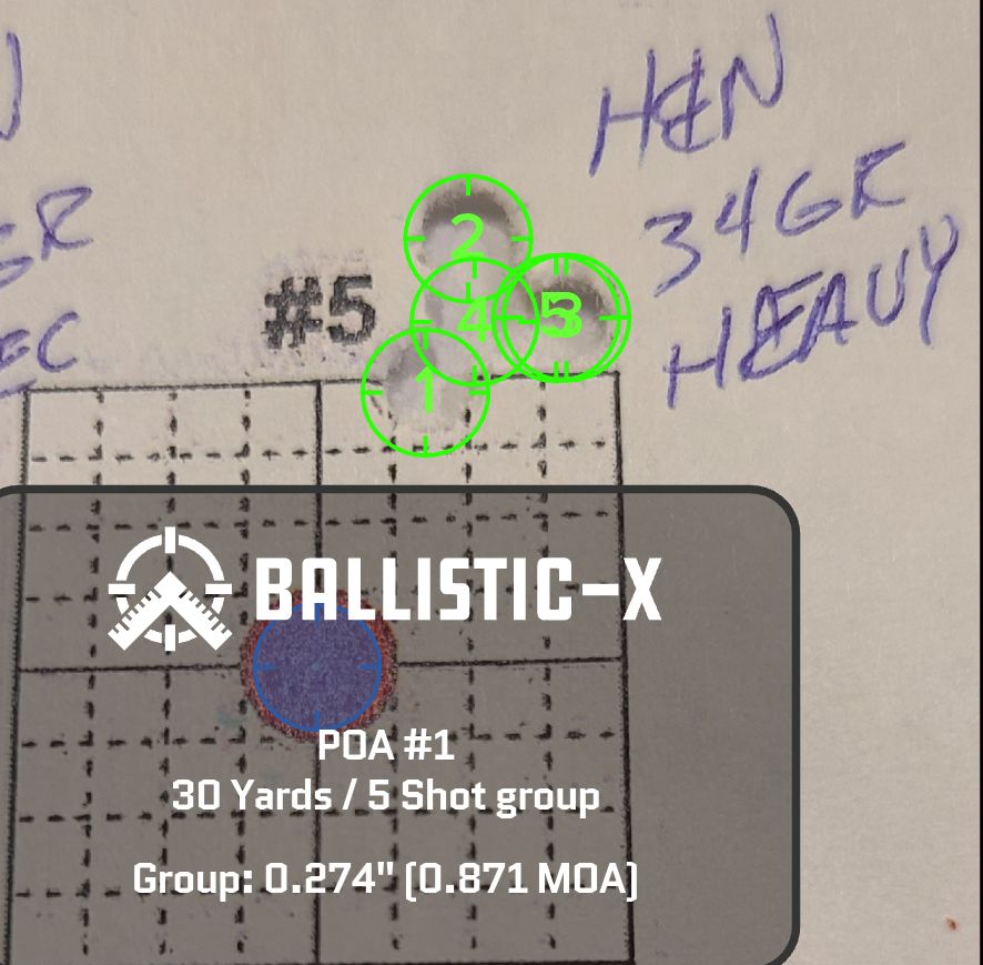

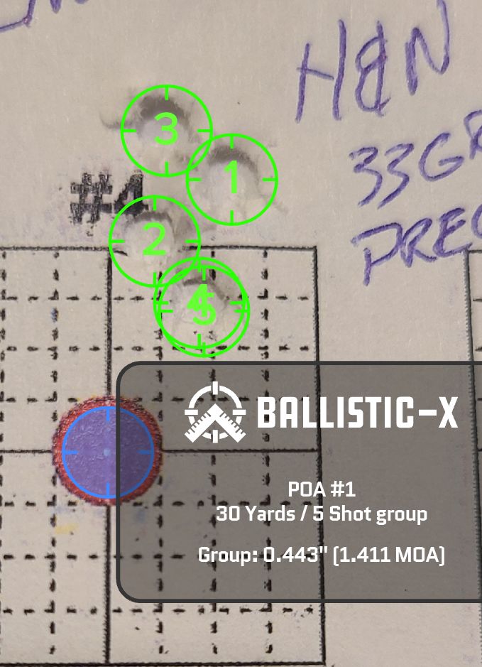

This is the 1st 10 shot group at 50 yards from my DRS Classic 22 700.

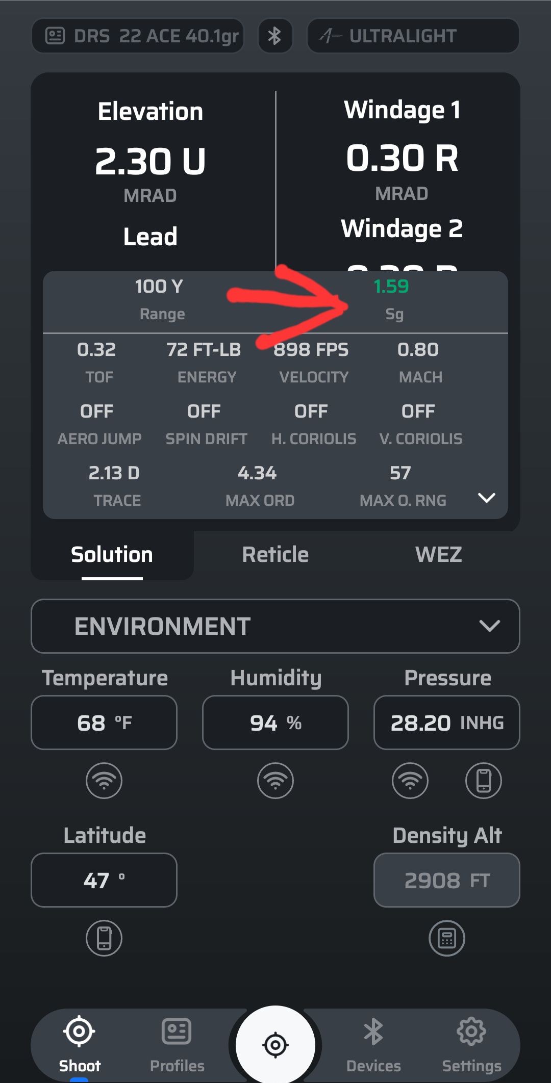

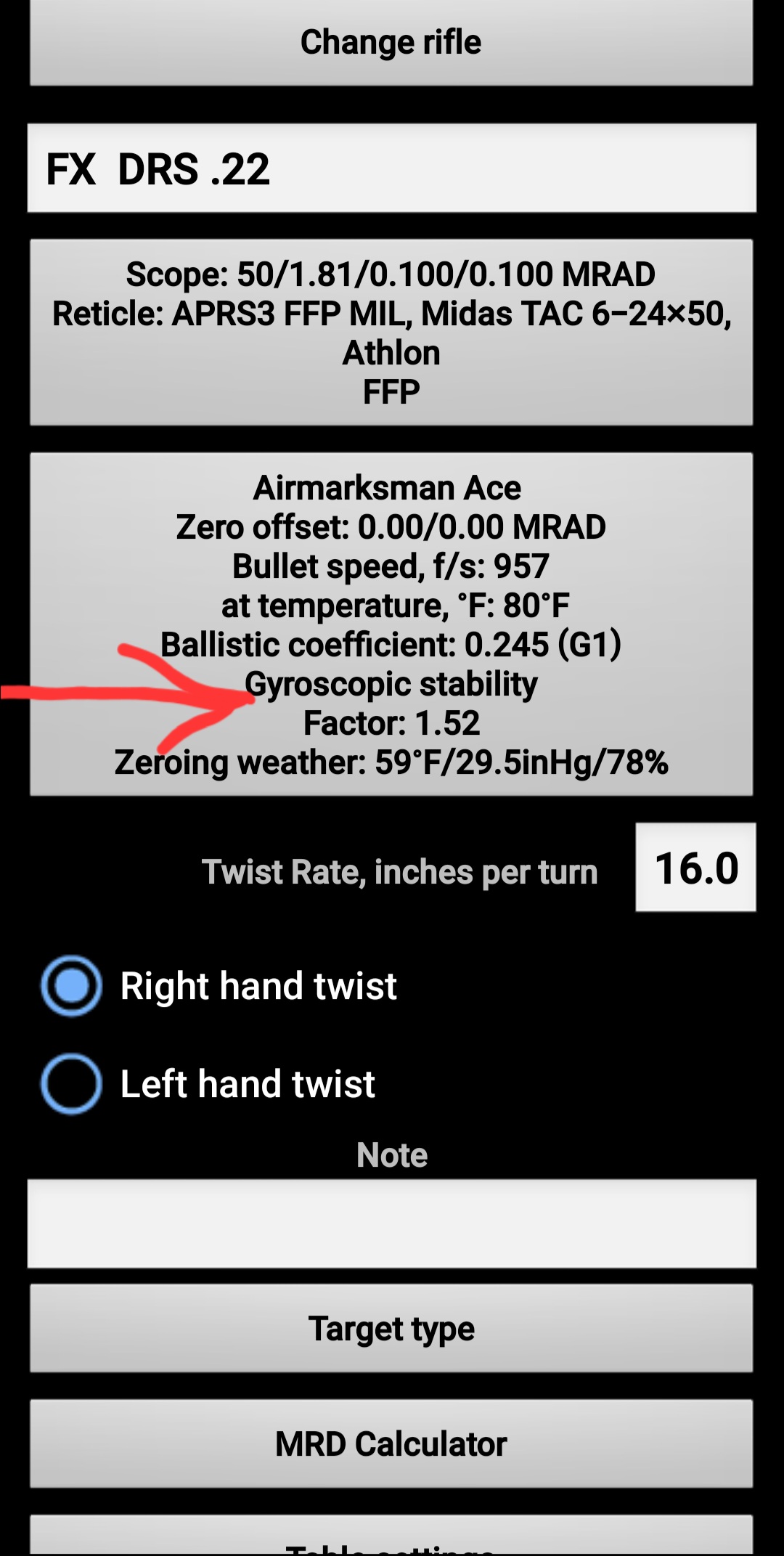

I have it set up shooting the H&N 34gr Heavy slugs at 975fps. I did not change any settings to shoot the Ace 40.1gr. slugs, they were going 937 fps.
After 5 sight in shots this is the 1st 100 yard group in gusty 12+ mph wind. I held .2 mil to the left for wind.
#7 was shooter.
The hole in the target is ⅞ of an inch.
Hopefully Airmarksman comes out with a high BC Boat Tail Hollow Point for hunting.

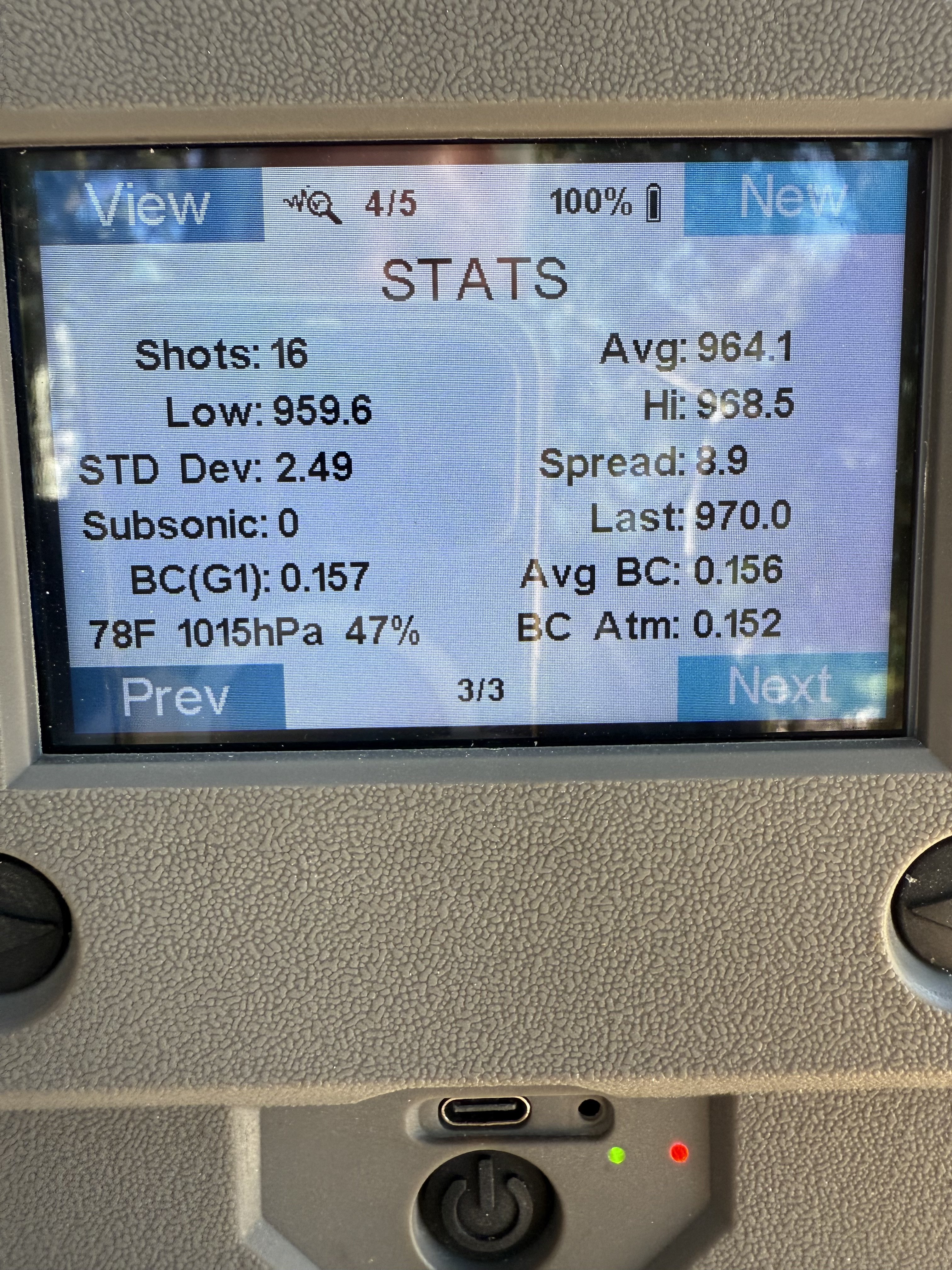

I received some of those Tuesday, and shot about a tin today. 700mm .22 cal 1:16 twist Superior Heavy liner in a Skout Evo.
I shot them at 950, 975, and 1000 fps at 104 yards. All speeds were very accurate, but 950 ish fps was best.
One thing that surprised me was BC G1. It seems many of the “Influencers” are getting crazy high BC. For me, that wasn’t the case. Over the three speeds tested BC was about 0.156 to 0.160. Not bad, but not in Altaros territory.

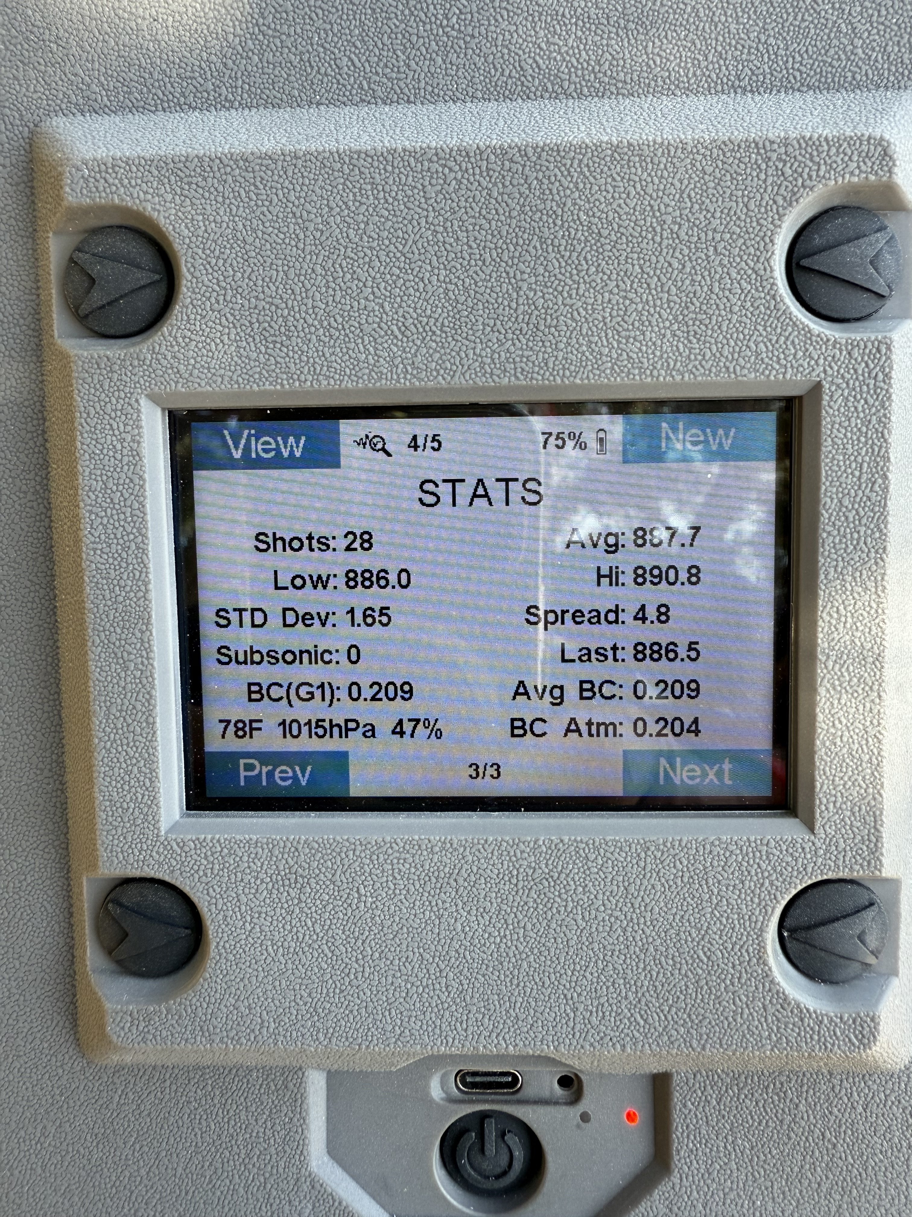

Just to make sure things were good, I shot my old standby .25 Panthera 600mm with @Altaros 49.5 grain slugs at 888 fps. BC was the usual, today right at 0.209 G1.
Can you reduce the velocity of the Ace slugs down to 890fps.
