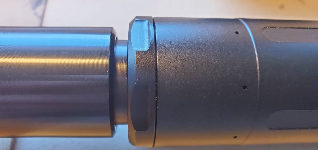

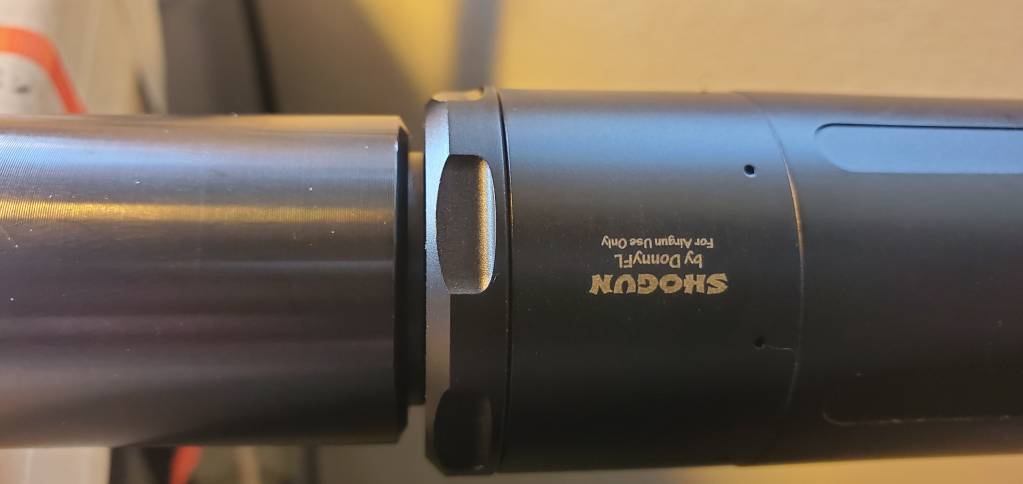

Tuning Just came in today! 4 the fx fans the new barrel tuner!

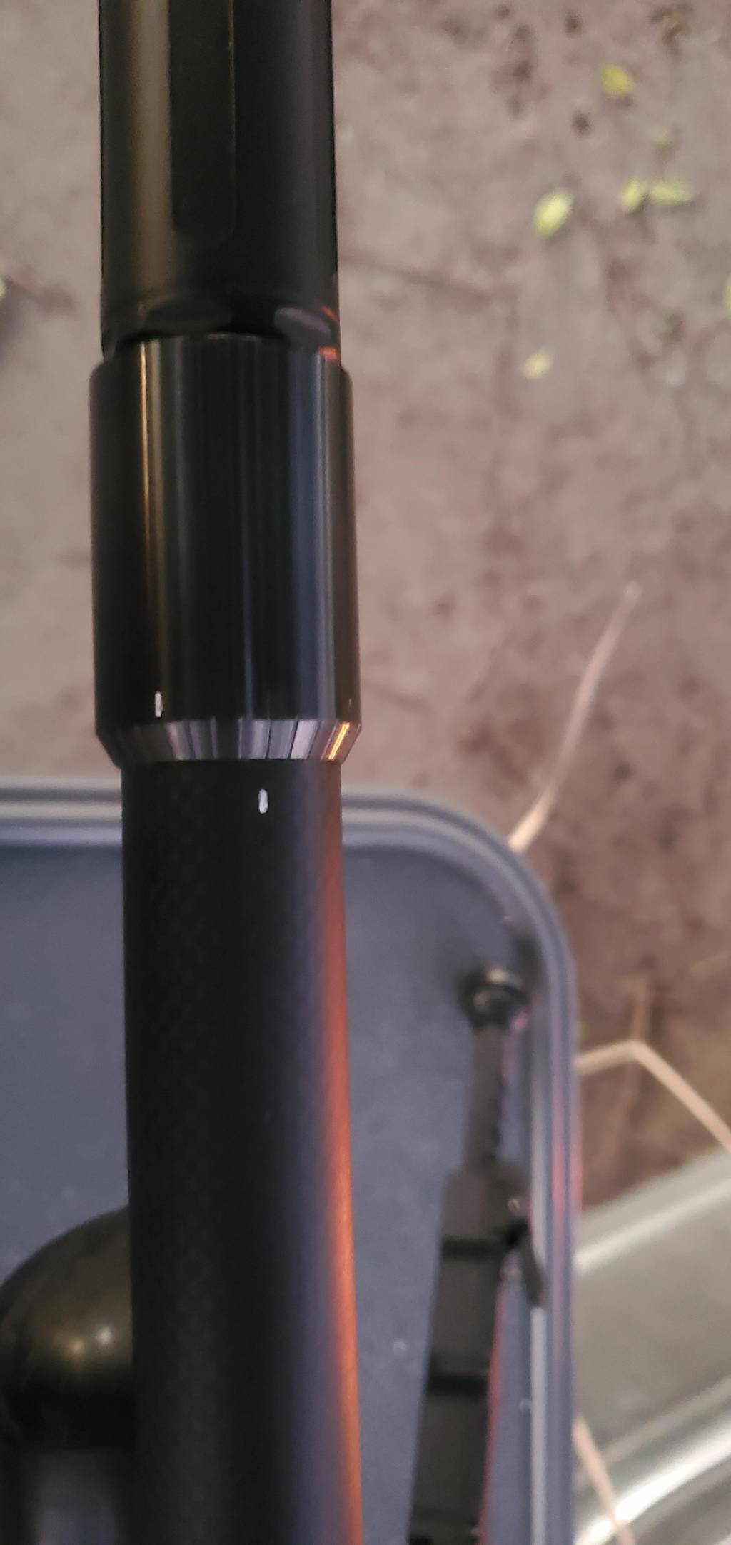

Oh look after the moderator is threaded on and i twist the weight, it comes inward. So I assume that the moderator is the stop for the weight going out, and not to be used as a lock nut for the moderator 😁

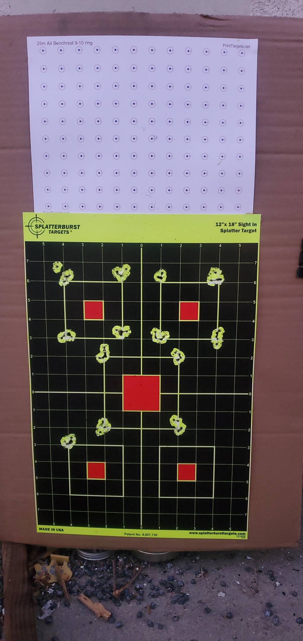

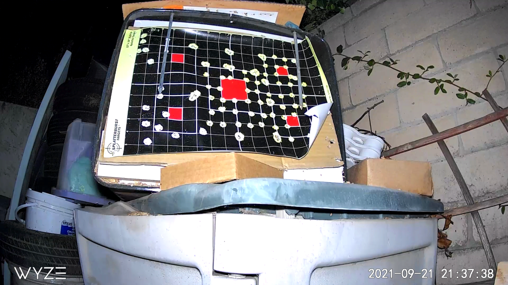

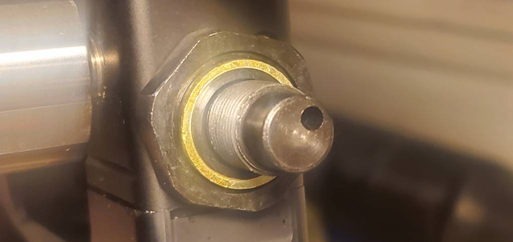

So i started. This is at 50 as thats as far as i have at home. There are some long hash marks and short has marks. I'm shooting 5 shot groups and rotating to next long hash mark then shoot a group rotate and again for about 2 rotations then measure groups. But in theory that should mean i should be able to find the smallest group and go back to it right? Well i developed a leak at the o-ring where the bottle screws on and can't test that theory. 😔

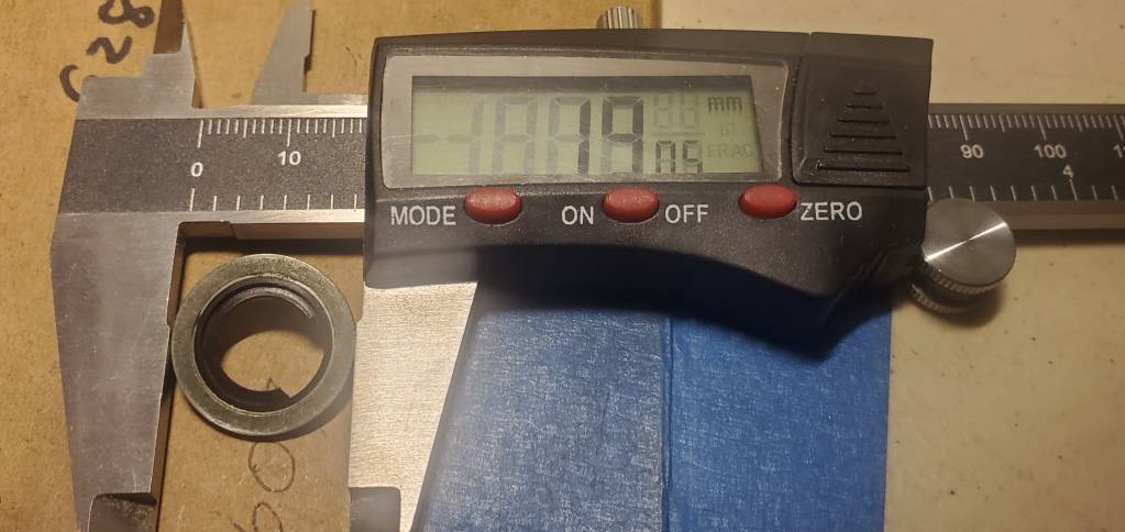

Okay so i got a seal to work on the bottle.Ā

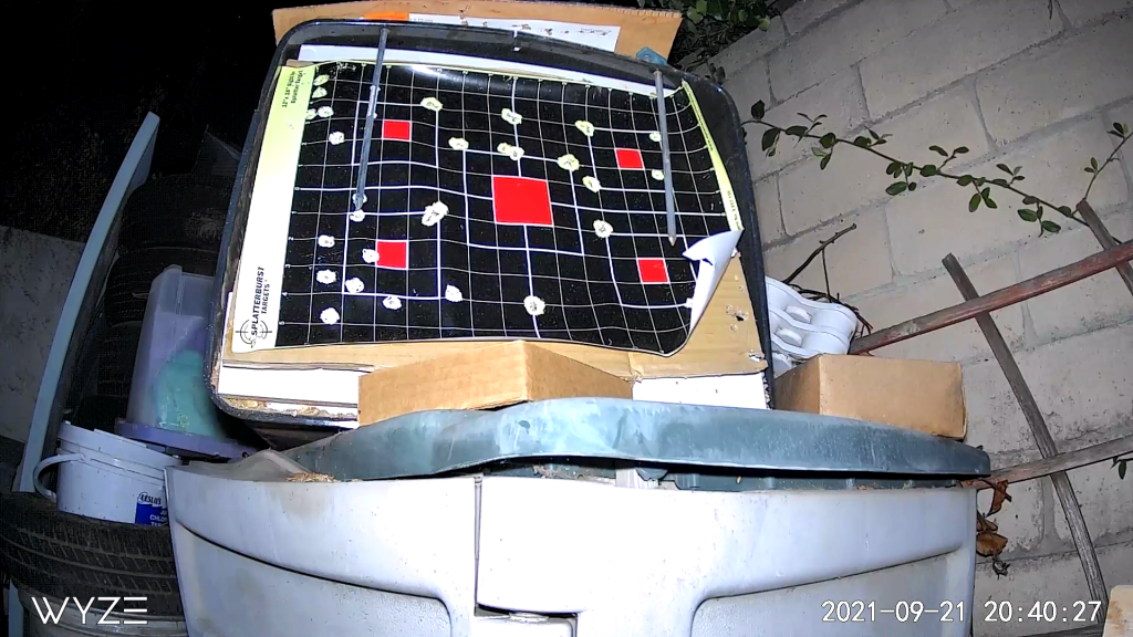

Its a 12mm,Ā outside diameter is a little small and its a bit thick but it will work. Its late. My base tune was basically a quickie as i had a .30 barrel firing 840 with a short 500mm barrel. Now it has a 700mm with a .22 firing 18.1s at abou 910 fps. Base on the previous 5 shot groups i adjust the barrel weight to the tightest group which was the 3 group above. It was late so i just fired at the the 35 yard target just to see if the groups were tighter. It was! I decided to fire off some single shots at the lines where they crossed and did better than i thought. Not only did i get better groups with the barrel tuner but i got better shots even with a half assed tune!
