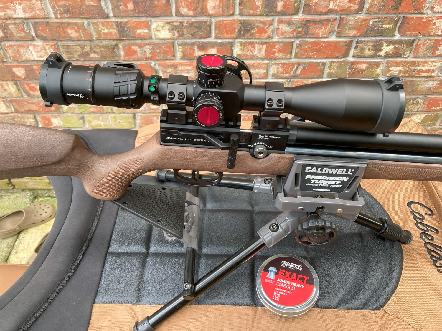

Got mine today after saying no no..ignore.
What are your hammer spring settings for your best shot string, turns out?
Angie at GTX presented this shot string at two full turns out “strangler” at 5:
11:11 on her video.
I’m waiting on new scope Thursday to check these results. Aired rifle up to check for slow leaks. Two test shots, rifle very quiet but spring or ping noise still present. Not an issue, for me, as long as it’s quiet in stock form.

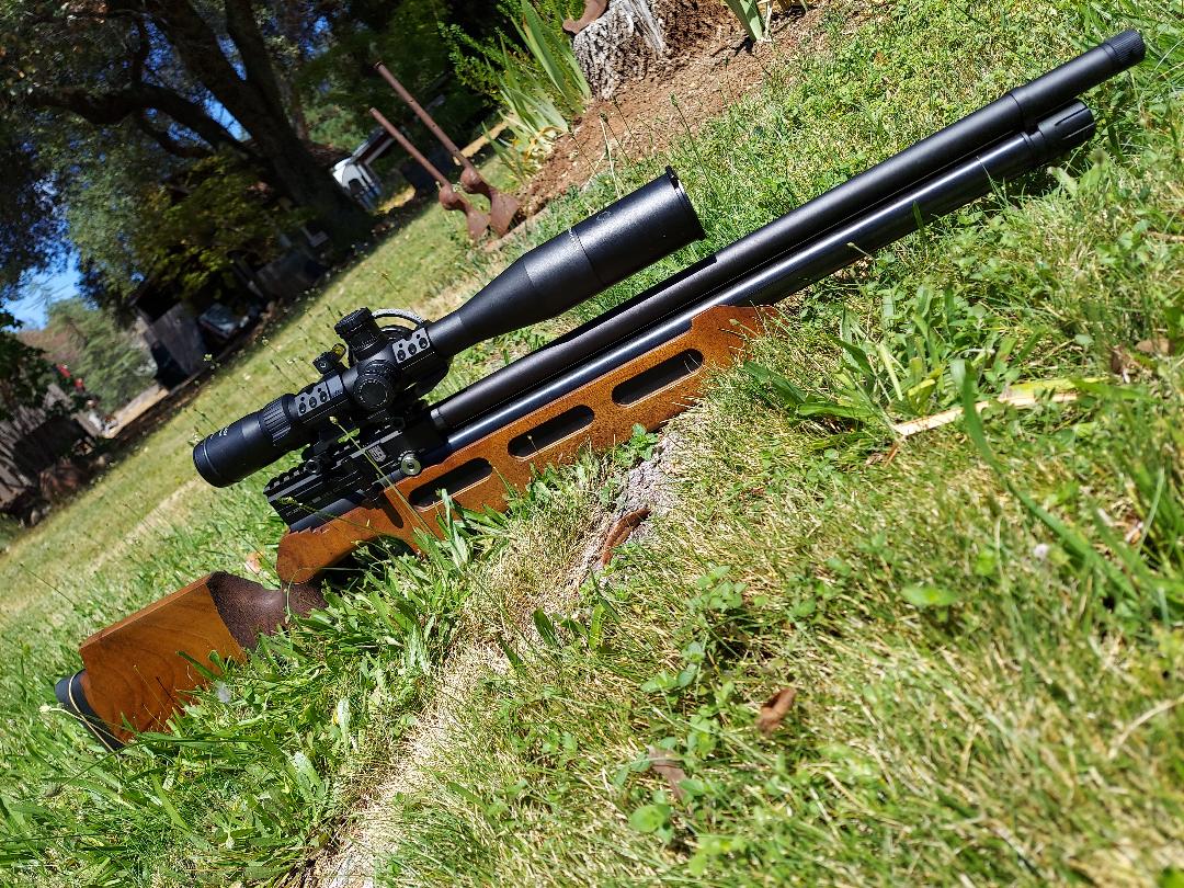

Also ... One can put in a regulator having the standard operate very similar to the max with added benefit of external power adjusting via the transfer restriction knob.
I have done this to my early STD in .22 cal. It runs wide open on adjuster about 28 fpe and makes 5 magazines on a 3K fill.
LOVES Crosman 14.3 or JSB 15.9 weights set up as such. Very accurate & very quiet.
Does have an SSG anti-hammer bounce devise however ;) along with a custom stock :love:

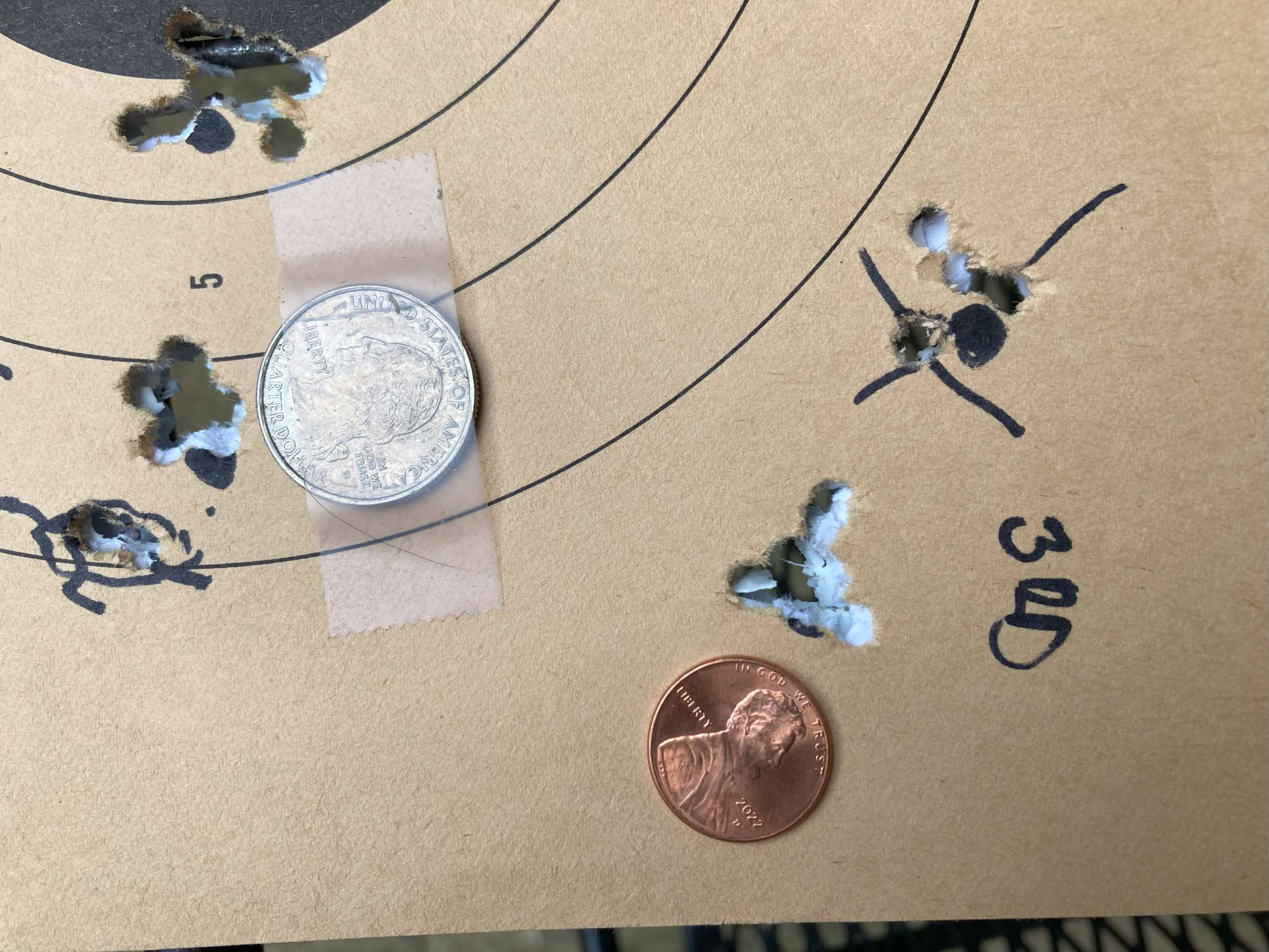

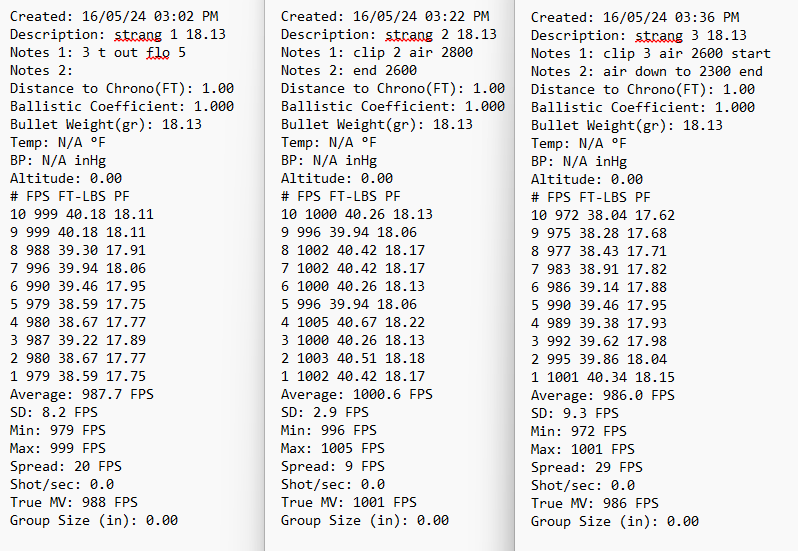

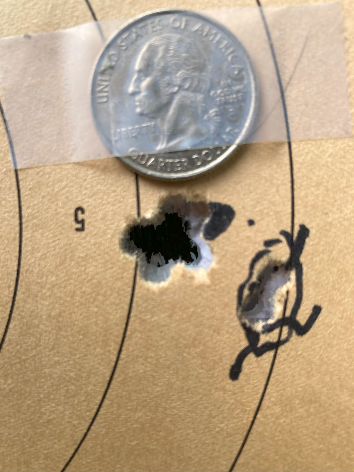

Broke out Chrony today to see what my new “Strangler” would give me. I used the already on hand 18.13 JSB that my Talon SS hated. Hammer full 3 turns out with flow on 5 wide open.
Only did three clips for this “hunting curve” All 30 inside a penny but don’t think squirrel would care? Target shows clip 1 and clip 3 only. Shots pulled in clip 3 trying to follow black marker aim point. I did three separate chrony logs to break down the non regulated shot spread.
