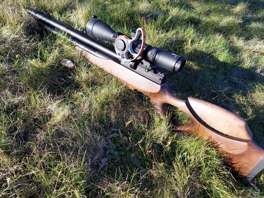

Here is my personal .22 MAX set up for some Field Target duty in "Hunter PCP" class.
While .22 is not ideal for FT ... it can be used w/o issue outside easier splits and a loopier trajectory profile.
Going to shoot DIABLO match next weekend with it and see how it does.
