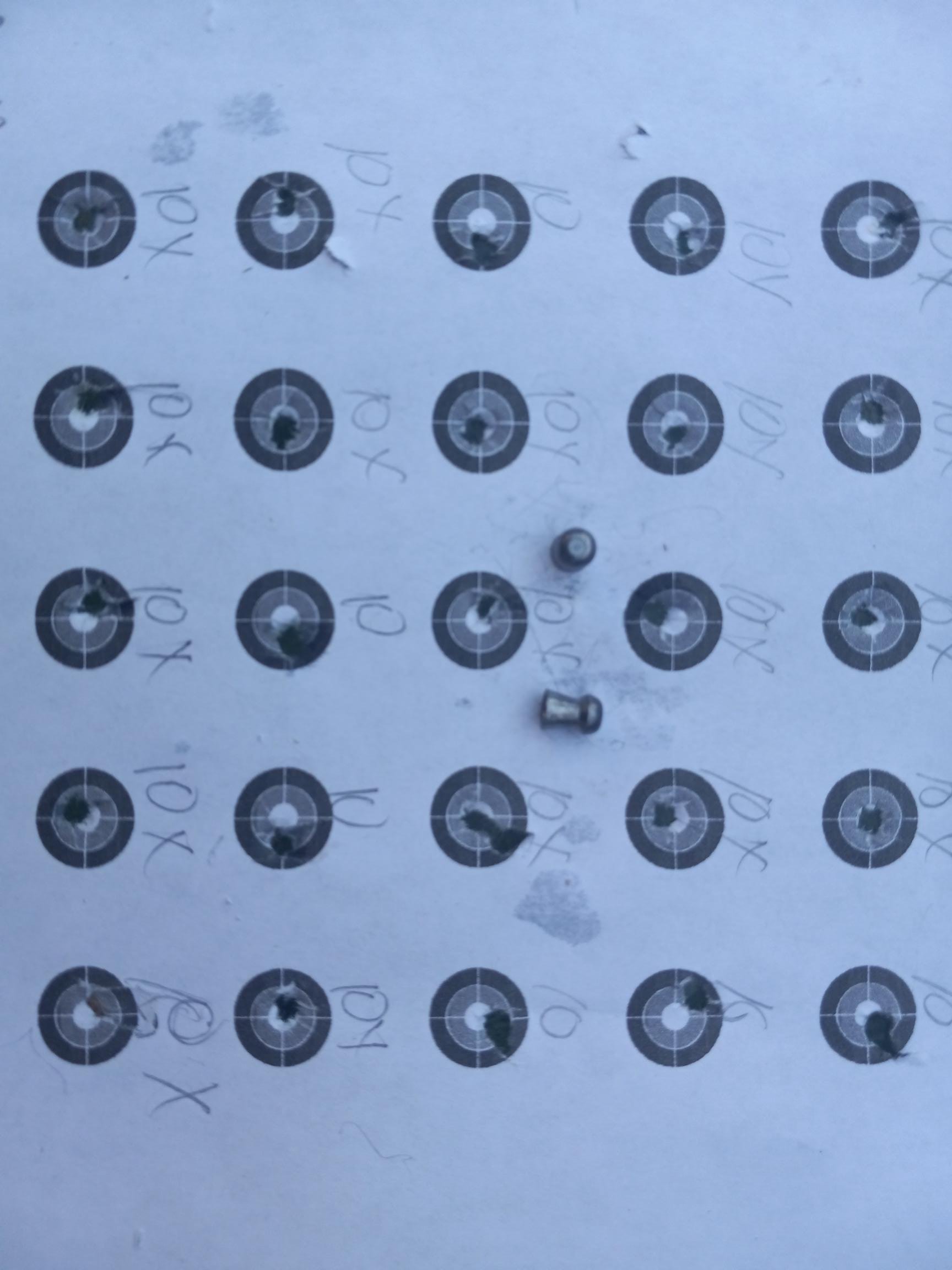

Have you tried the 18 grain ? I have benn shooting them out of my vulcan 3 at high speed of 980S and scoring in the lower 240s I have tried the 18, 21, 22, and 25 gr and the vulcan likes the 18 gr best with the 22 gr next We have a once a month indoor 50 yard match at Piney Hill In Luray VA. Here is a target I aced at 35 yards in my yard . I can only get out to 35 in the yard

Reactions: Dairyboy

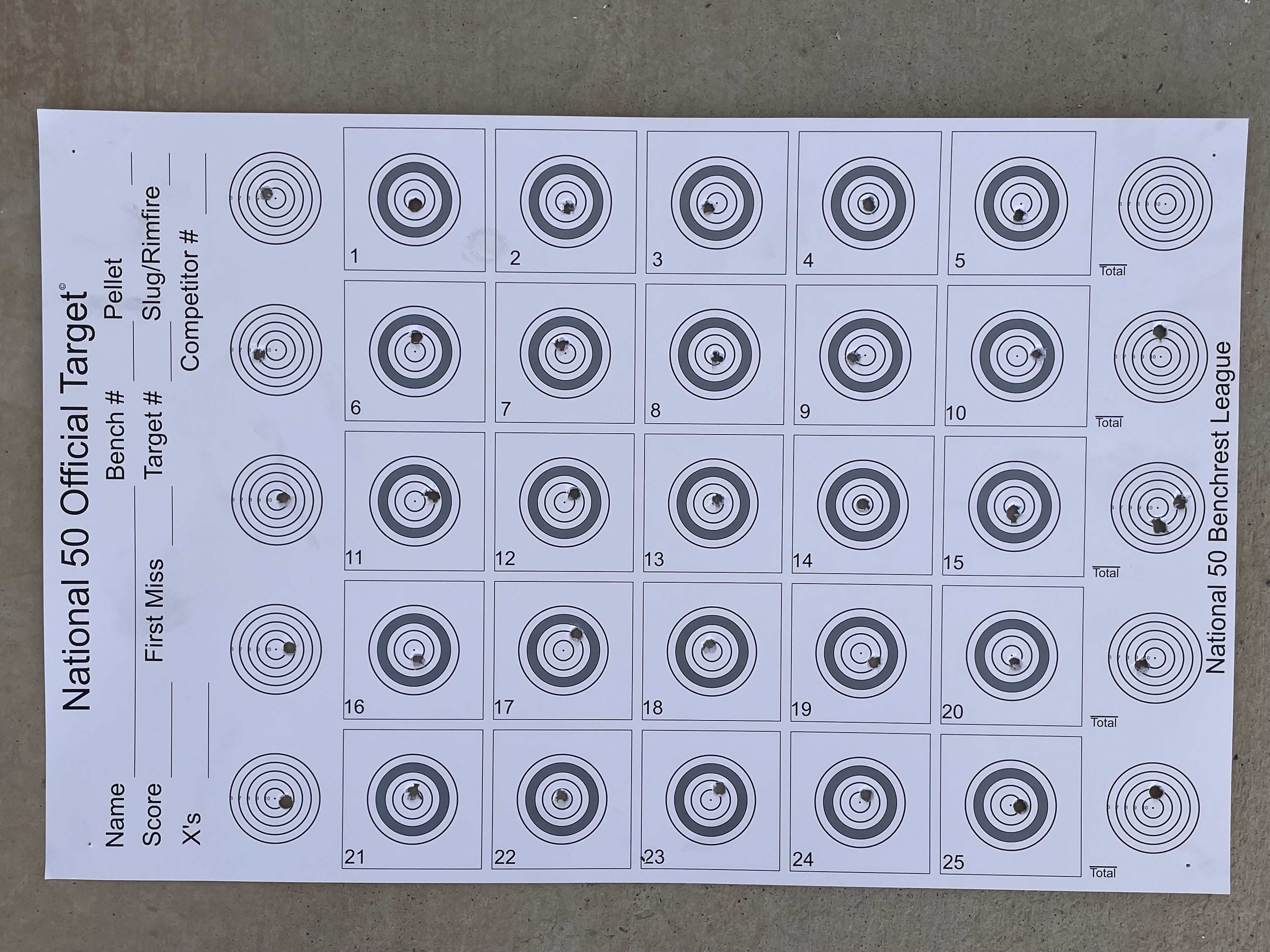

You know you are going to see a good N50 card, when almost all the sighter target bulls are ‘10’s.’ 😀 My sighters need a couple/few shots before I land a “10.”
