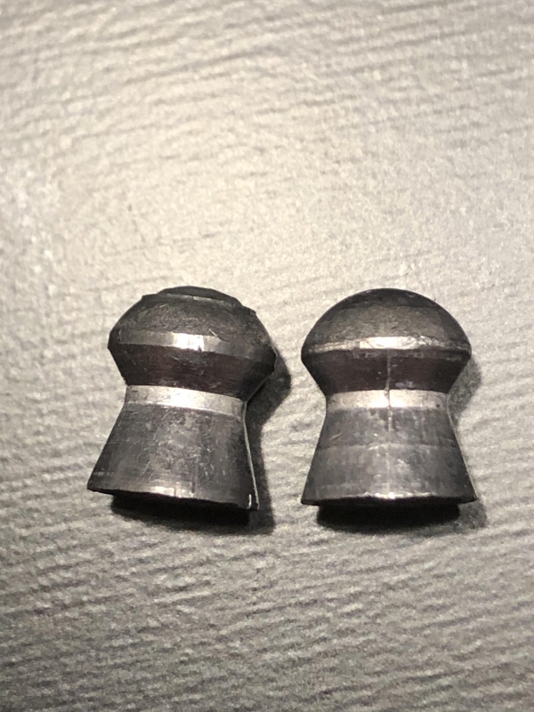

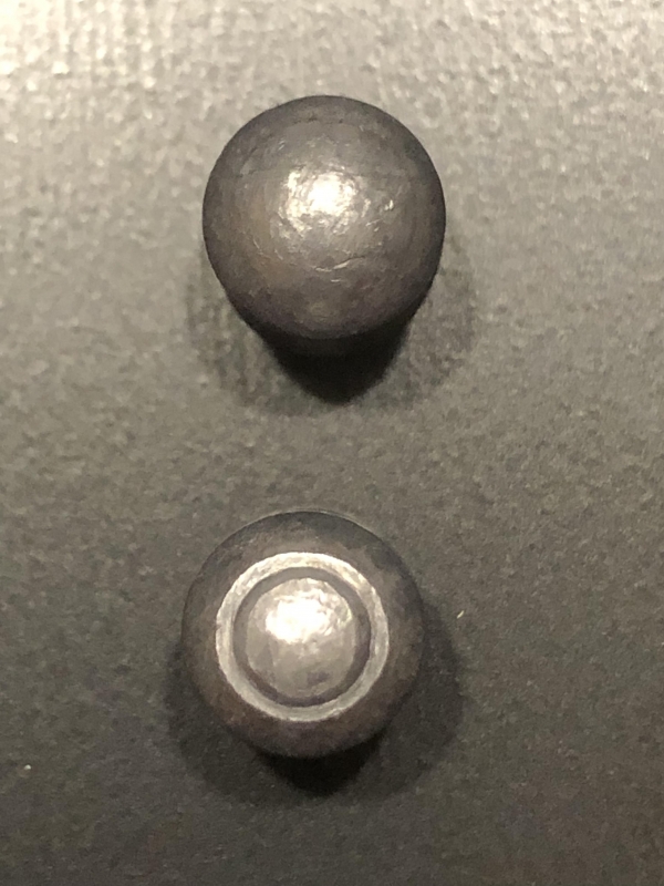

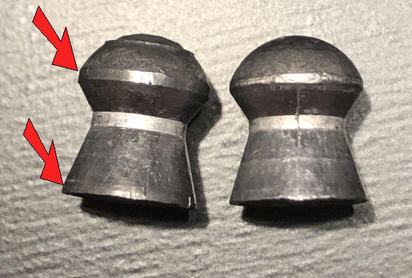

A friend of mine has a .30 cal impact and had a tin of 44.75 JSB’s that looked like this. They had an auidible “zing” to them when shot.
These were purchased from PyramydAir and the tins had the large white circle sticker on the bottom so no date,die#,employee #,batch #... after watching the JSB “Shot Show” video and they talked about each and every pellet being inspected by a group of 32 women I have some doubts. Anyone else see anything like this?
Is anybody getting tins with the red “ID” tag on the bottom anymore or has that ship sailed? He has a few year or so old tins from AOA when he purchased the gun that have the red tags.

Are you saying the entire tin was like that? If so, then I'm pretty shocked.

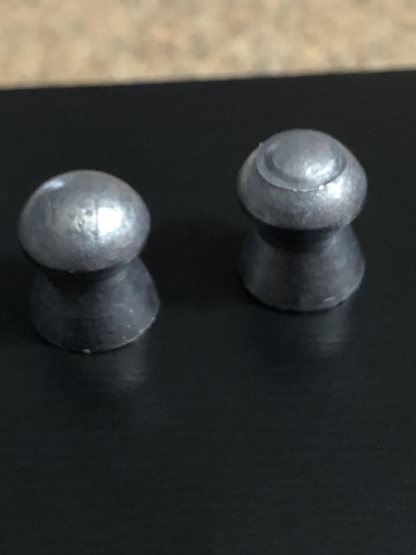

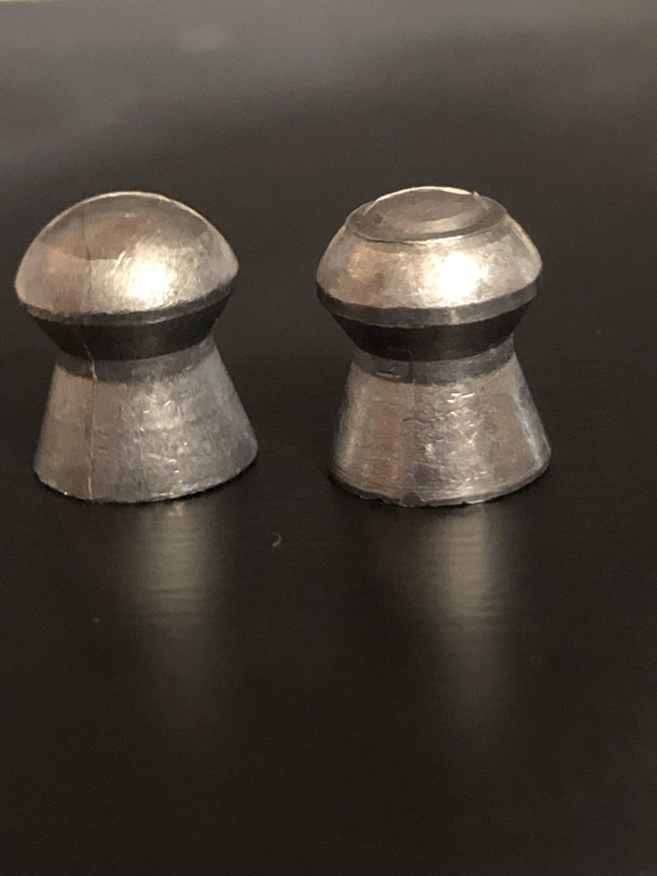

If not - I hesitate to say it but, I can see that happening during the shipping process. That looks like the bottom of the skirt of another pellet being smashed against the head of the affected pellet. I'd bet it matches up perfectly. This is the same thing that causes smiley's on the heads of pellets.
I've questioned the "Carefully Selected" claim quite a few times and have found easily identifiable variations from tin to tin. I accept that you can't catch everything and I accept that it's manufacturing and things happen. It's easy to accept when you put it into the perspective of a couple million pellets.
I'd like to see them put about 25-50 less pellets in the large tins to help stop the smiley's. But then, would the pellets bash into one another? It's a delicate balance of "danged if you do, danged if you don't." But, this is why we sort out pellets.
If the whole tin was like that... wow! I've had some rough tins in the past but, nothing like that! PA has always been happy to replace a bad tin without hesitation. Maybe, give them a call. Then, shoot the "zingers" just for fun!! :)
Tom

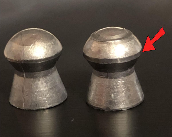

Looking again, I just noticed some more differences, other than the obvious. The rim around the edge of the head is a different thickness, the "waist" is also a slightly different thickness, and in the 2nd and 4th pics the angle of the skirt looks different as well.
