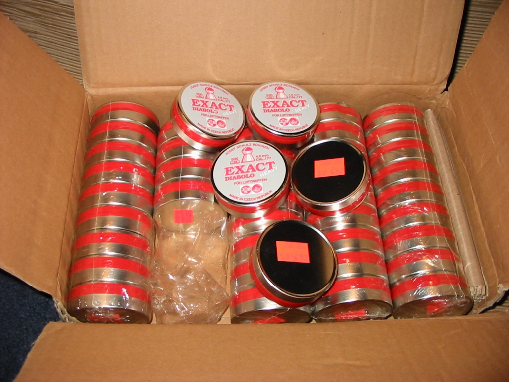

JSB pellets?
I'm not going to blast them here on the forum, that was never my intention. I needed to find out myself if they (he) were lying to me about how jsb packaged their pellets. I'm sure they tampered with my tins of pellets, they must sort for their favorite customers and think Barry from NC want know the difference. I've been shooting pellet rifles since I was old enough to buy my first one, I am 64 now so I am not new to the pellet adventure. I did not post to bad mouth JSB, just the opposite, in my first post I said I like JSB pellets and I do. The quality issue came from the bad vender that at this time I'm not ready to expose. They want miss my business, next time you order pellets and they are poly wrapped and not individually sealed send me a PM and I will tell you who my vender was, the vender will probably match mine I'll bet. Thanks for the ones who posted. Barry

Ok, what I have observed ordering jsb pellets from 5 different venders, all venders are not created equal. All of my jsb pellets ordered have all been sealed reguardless of the calber and have all been great less one of the venders. One of those venders sent me unsealed pellets, damaged tins, poor quality pellets in their regards to grouping when shot. Their only response was i must be using the wrong caliber pellet in my gun. That vender also stated that jsb pellets were sealed sometimes. Very disapointed in this vender I am glad to know this about them before I ordered an air gun from them. Hope that vender reads air gun nation. Barry
How are they going to knows its “ them” unless you tell us who “ they” are ? Do us all a favor, who is it ? You are not blasting them, you are informing us and them that there quality control needs to be better. How can they fix something if they don’t know it’s broke.

To date, I've never gotten a tin of JSB's, whether they came sleeved or singles, that didn't have red or yellow sealing tape holding the lid on. Will that change in the future?? Don't have a clue, just my experience with JSB up to now.
I won't get into damaged, weights or anything else since it's not what the OP asked in his post.
Been away for a while, didn't know this topic had been revived. I called the vendor "AOA" their response to me was that my accuracy problem with their unsealed pellets was due to me shooting the wrong caliber pellet in my wrong caliber guns. That really ticked me off, I think in 50 plus years of air gunning i can distinguish between the calibers. I will never do. Business with aoa again, I don't trust them. These are the facts! Take care Barry
