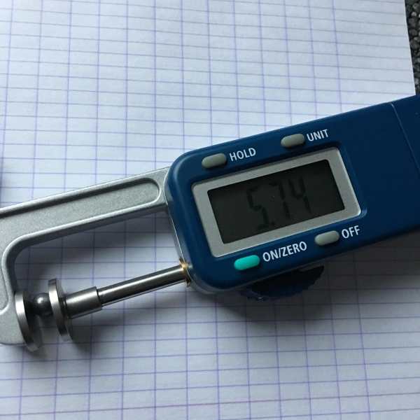

can someone explain to me why I buy a tin of 5,52 mm size JSB heavy if all the heads measure 5,50 and the skirts 5,74 mm ??
Yes indeed , the weight is one issue that I realized long time ago . That’s why I weigh my pellets for target shooting . The only thing I never checked where the diameters of the pellets . Generally a tin of JSB 5,52 results in much tighter groups then a tin of 5,50 .
whets funny is that almost the whole thin have the same headsizer ( 5,50 instead of 5,52 what the tin says ) but the skirts of each pellet have a much bigger size ( 5,74 ) ? ???

Check out my Field Target Tech Channel videos on U Tube, I describe all of the dilemmas mentioned above, and how to sort and cull them. You also might not be getting accurate readings, due to the use of calipers. I can measure the same pellet several times, and get several different numbers. Calipers are generally not used for accurately measuring headsize.

As far as H/N pellets go of the 3 tins I sorted out they were much more consistent in weight than the JSB's but all three of the tins I checked all and I mean ALL were 4.49 and 4.50 head size when the can was marked 4.52 ! and by the way I use a" pellegage" not calipers to do my checking Mr. Holland so I do believe I am getting good info. Not bashing H/N but even when I had there pellets in the correct size in the past they did not group as well in my rifle like the proper size JSB's. I have also checked a few tins of Air Arms pellets for friends and they were very consistent in weight but much smaller than marked on the tin!! (4.49/4.50) I don't know why the makers even bother putting the size on the tin if they can't do any better than they are at making them!!! J.L.
JL, I pretty much found exactly what you found, and it seems no matter what company is producing them, it seems to be a crapshoot on what's marked on the tin. Pelletgage is pretty accurate, so your info is pretty reliable, because the Pelletgage is reliable. The caliper comment was for the gentleman in the post that was using them above. Keep sorting, between all of us on this forum, our findings and observations, we are bound to make these companies make a better quality product in the long run.
