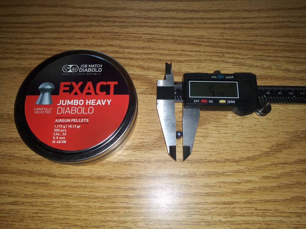

Kind of hard to see, but 5.54mm
Checked across three tins.

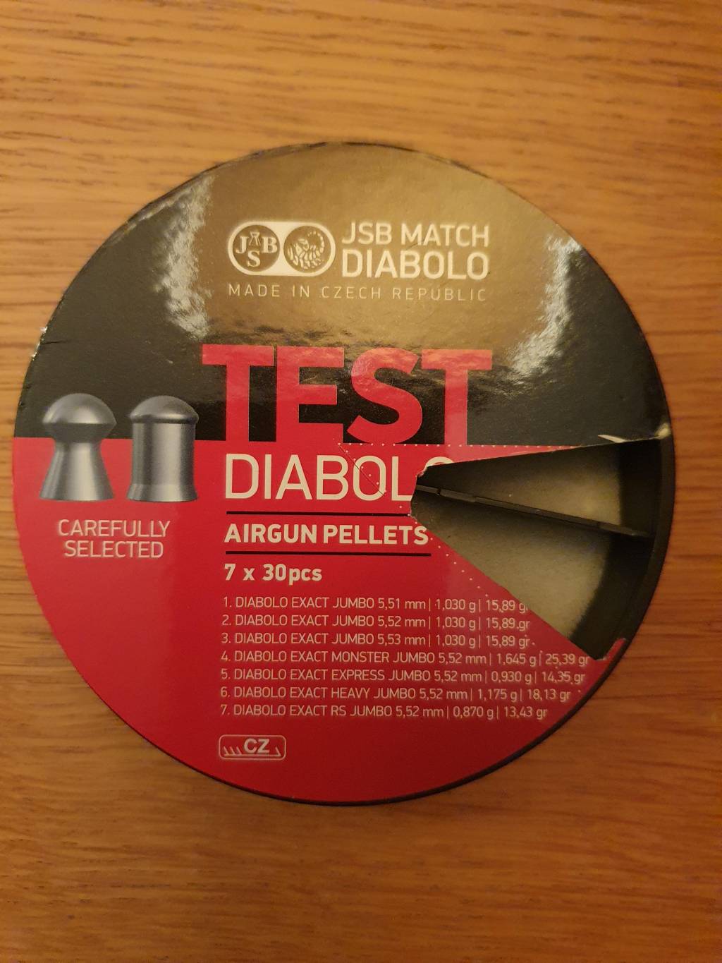

This tin helps selecting the different sizes:

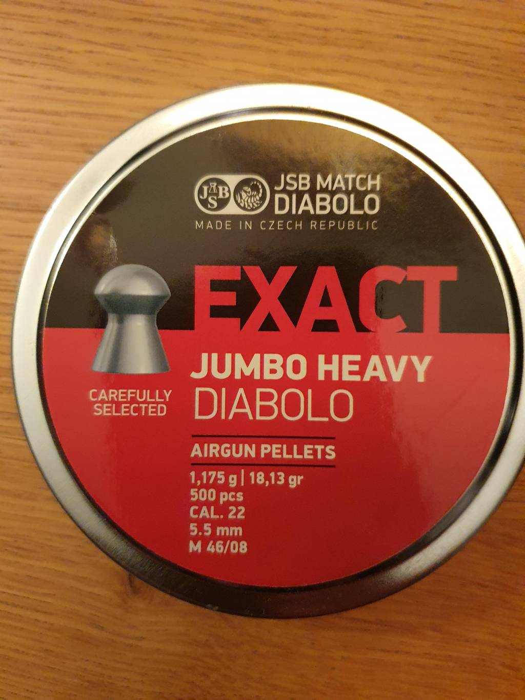

Regarding labels: front:

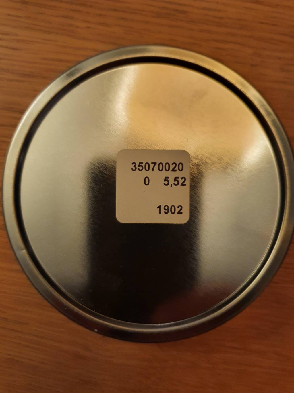

back:
If the US importer covered the factory label with its own, maybe it's possible to peel it ? All tins usually have such a label.

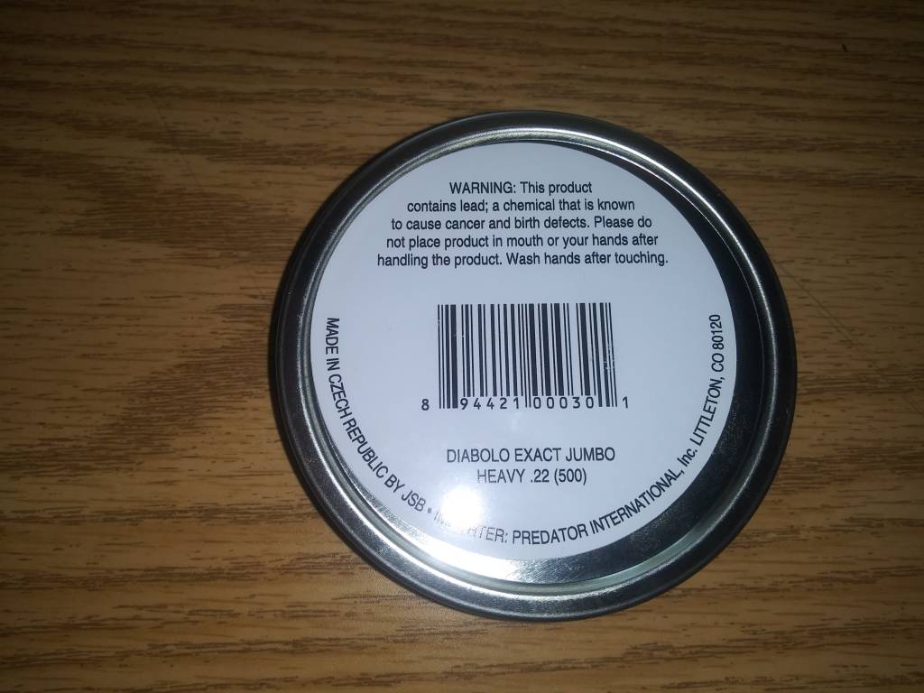

The bottom picture is the label mine had on it but said 5.53
