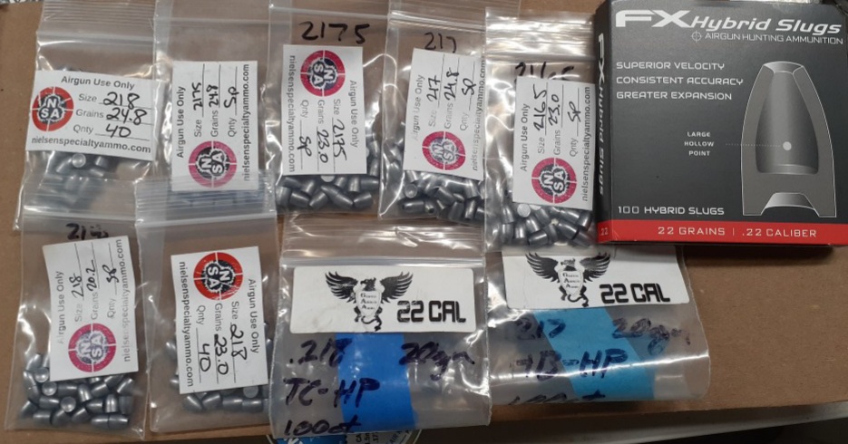

The only real answer to "How do I know which one to try?" is that you try them all.
This is how many slugs I tried before my rifle 'told' me it liked .218" 24.8gr NSA slugs, though I did pick up some JSB knock out .217 to try.
My rifle likes both the JSB jumbo 18.3gr and the monster 25.39gr with me currently preferring to use the monsters as I can leave the hammer and reg settings the same for the pellets and NSA slugs and just re-zero.

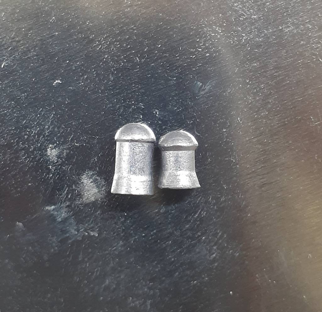

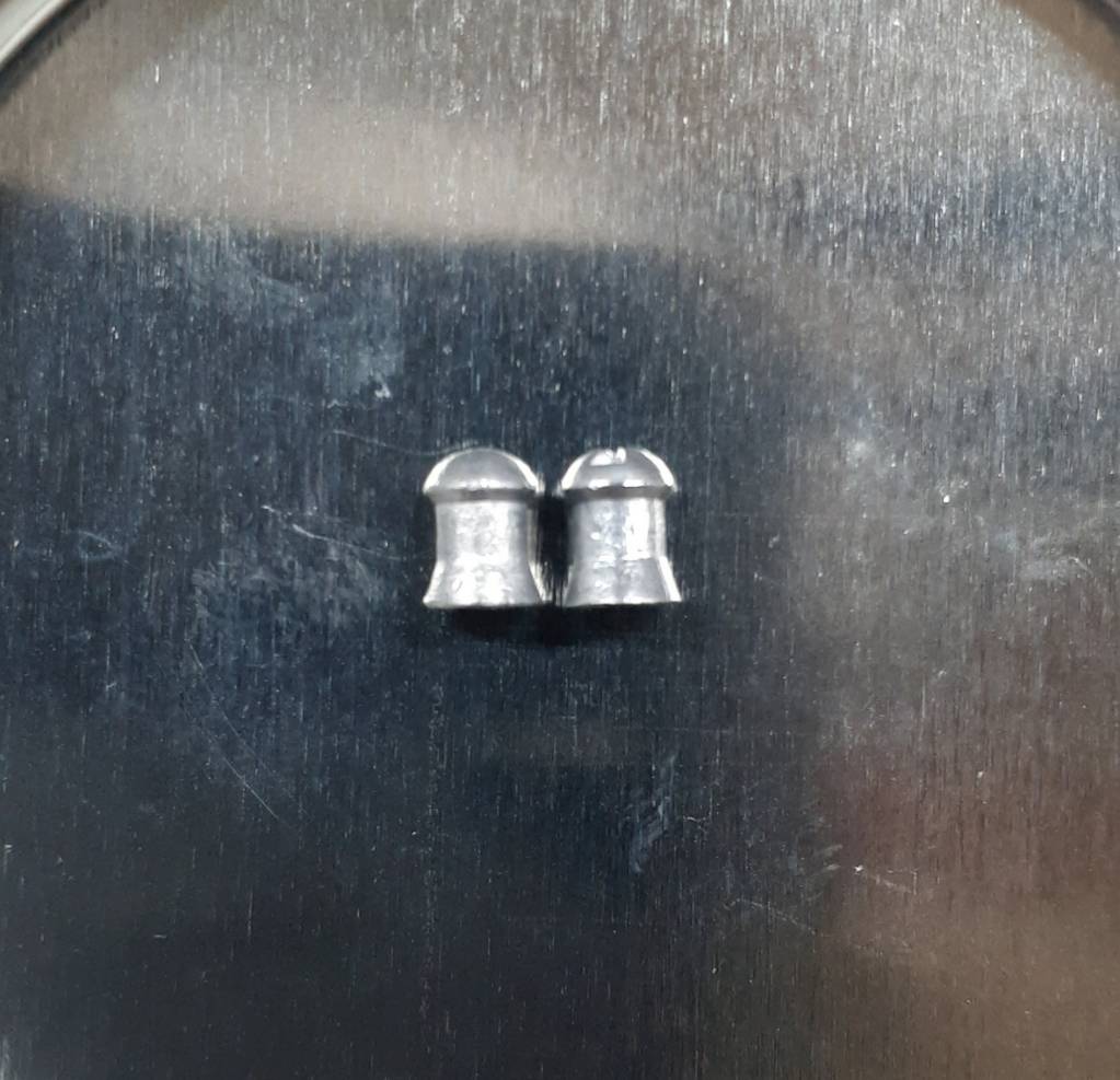

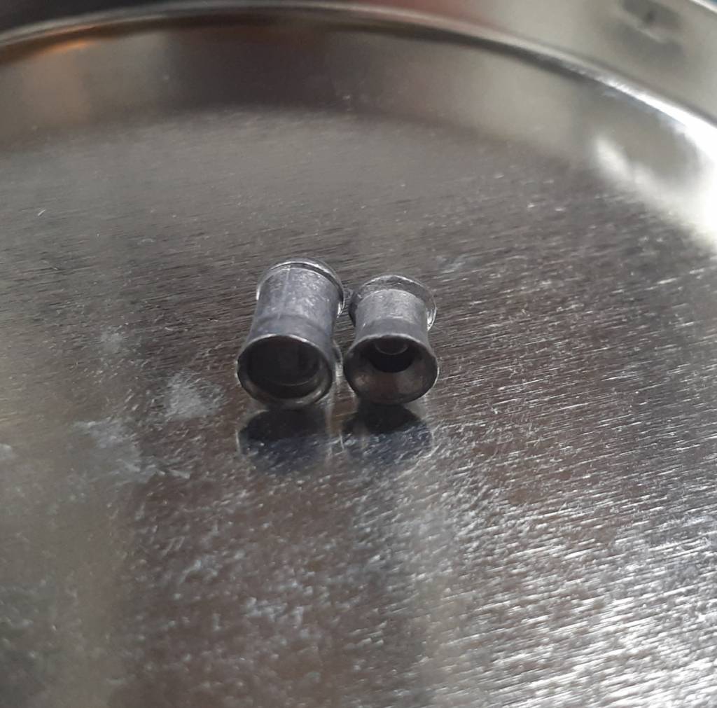

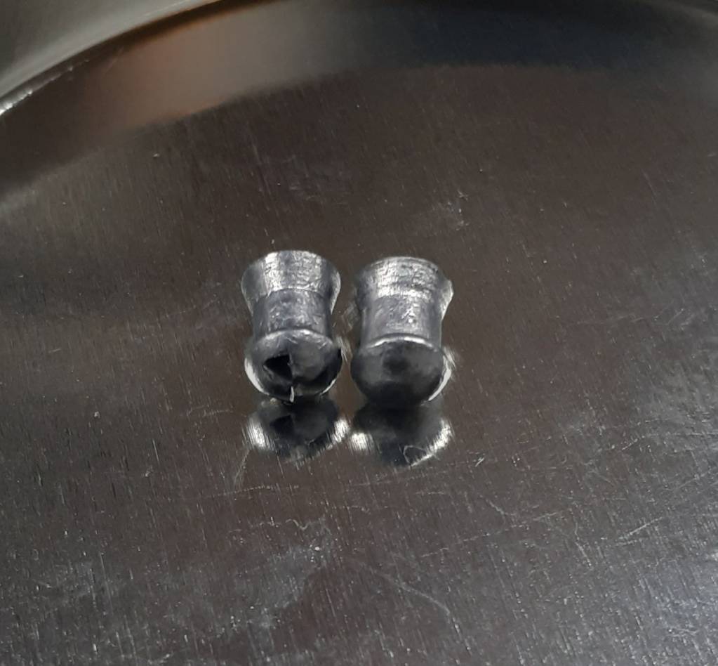

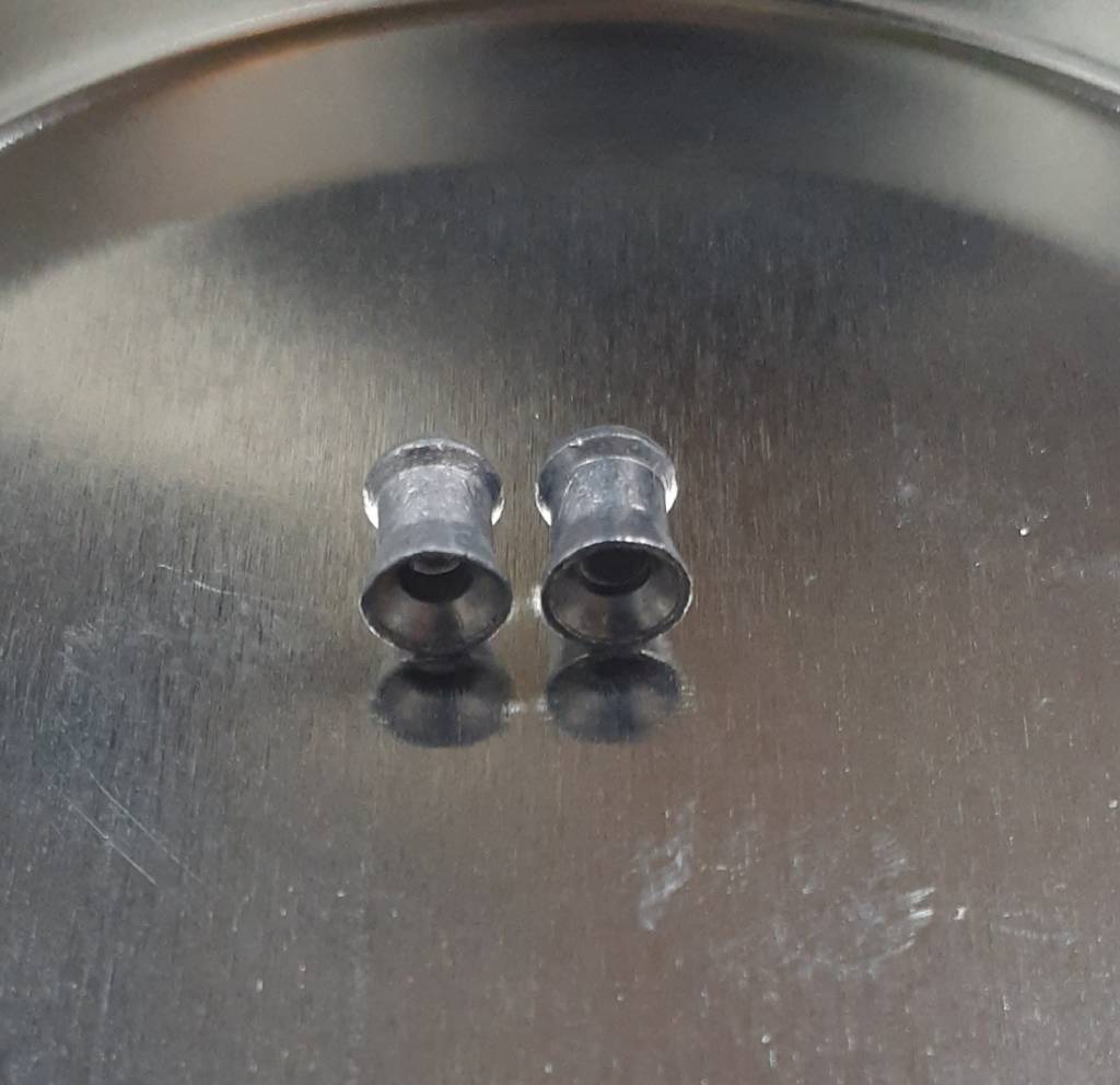

I don't know much about the strattons but the hades in .22 are the jumbo heavy with the hollow tip which reduces the weight. The difference between the hades and exact jumbo 15's it's that there's more lead in the middle where the extra weight is added for the 18.13. I have both the 15's and 18's which I can take a pic of for you later.
I also have the hades ams they're exact counterparts in .177 which I'll also show you
So it turns out I lied about having the 15's and 18's. I currently only have the 18's and my .22 hades are still in the mail.
I can compare the. 177 jumbo heavy and the .177 hades.
As you can see they're 'almost' identical.
And here's the difference between the .177 jumbo and beast.
The difference between the .22 ones is similar.
