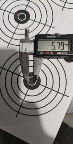

Jsb monster and jsb knockout 25m test on P15 with Lothar Walther Poly
Today i take some times to test my setup with jsb monster and knockout.
no possibility to test farther, but i'm already happy with the result..
1st target 5 jsb monster at 25M
Second target jsb knockout 25m
the pellet probe need some tuning for slugs on the P15 but i'm pleased with the result
Thank you
Thierry
Thank you pat585, first modification was the trigger, i replaced the m3 screw with a longer to make the trigger more sensitive, now the trigger is absolutly perfect. second was a plenum of 66cm3. Reworked the poppet valve to allow more airflow. added a 3rd barrel support to drive harmonic.. To follow i must install a custom valve housing opened to 7mm
Huma reg inside, the original was very good on mine but in the beginnng i added a plenum addon who work only with huma.
i can too put an fx liner on it, this is an adaptation from my friend Tudor.
