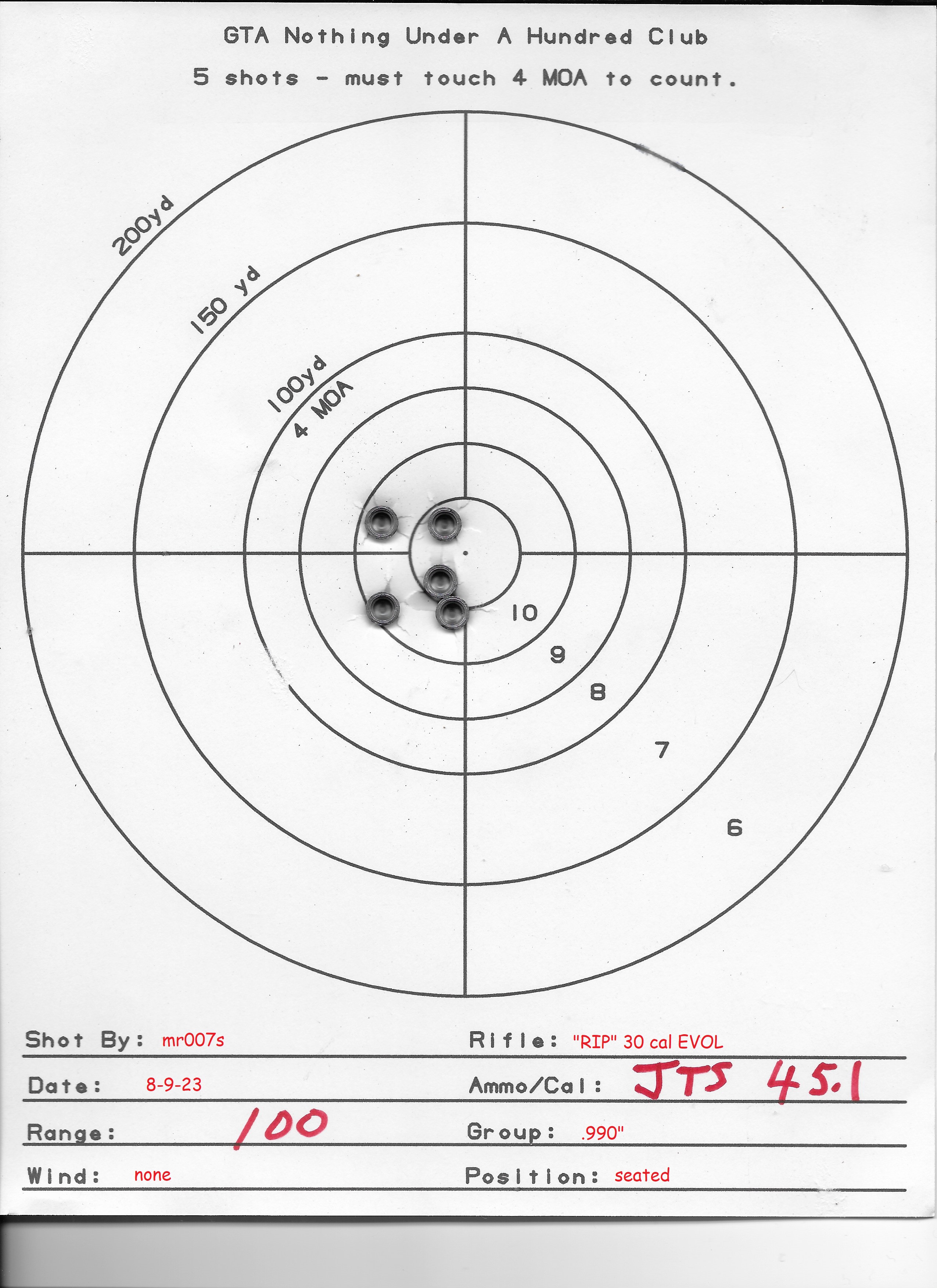

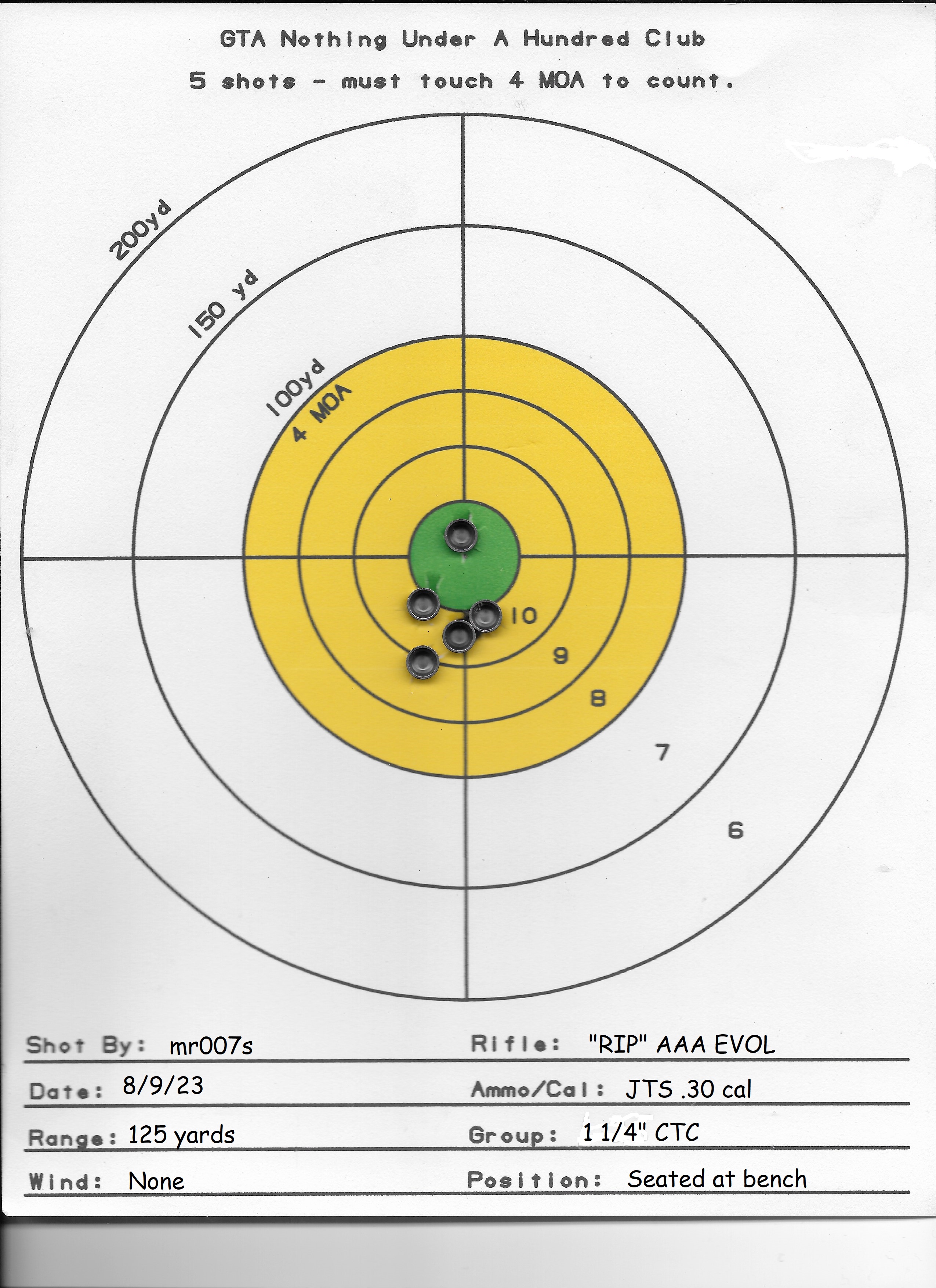

I have attached photos of several groups shot side by side on the same morning. Both were under 1 inch CTC. Also, I placed a 100 yard target used for the GTA NUHC at 125 yards just to see what I could do.
Turned out to be pretty dang good. I plan to share this post on a few other forums so you may see it again somewhere. Thanks for reading my post!
