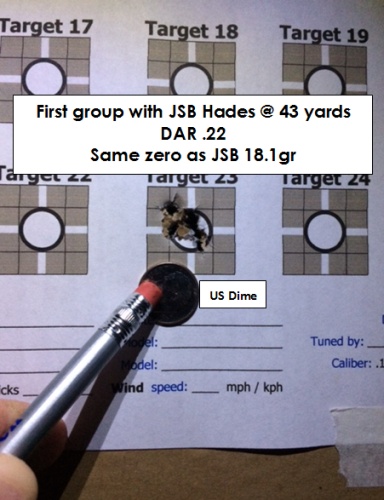

They do well up to at least a bit over 900fps:
Being semi-wadcutters, they shed velocity quicker than the equivalent weight dome. They don't expand to any meaningful extent in live game so don't worry about trying to push them fast in hopes of getting them to open up. They will do decent damage anyway due to the geometry.
