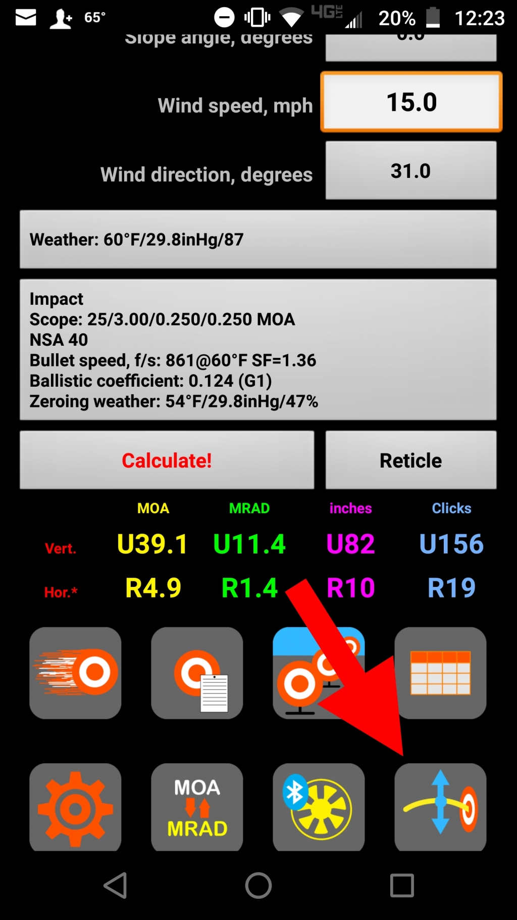

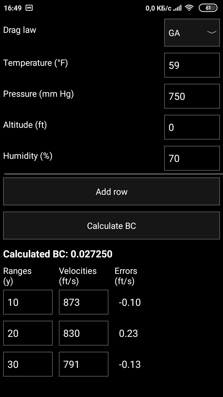

Are you familiar with the trajectory validation feature in Strelok? It will calculate the BC for you.
1560054307_18344812185cfc8a23e0b8e7.82297542_Screenshot_20190609-002319_1560054270843.jpg
Reactions: Fate

To revive an old thread - I noticed the Hades wasn't matching up with the Strelok reticle using the assumed BC of 0.031 for the Hades in my Pulsar. I'm shooting at 973 from the muzzle. So, I did my own ballistic coefficient calculation using my Caldwell Chronograph for velocities at the muzzle and 50 yards. I was very surprised at the result but when I used my calculated BC in Strelok it was right where the pellets were actually going. I know my calculated BC of 0.017 seems very low but the actual trajectory up to 50 yards (all I have) matches the Strelok calculations. I did the same test for JSB Exacts and JSB Heavy and pretty much matched the published data on these.
My data:
.22 Hades 15.89
Daystate Pulsar standard
Muzzle velocity - 973
50 yard velocity - 674
Calculated Ballistic Coefficient using the Pyramyd Air calculator 0.017,
