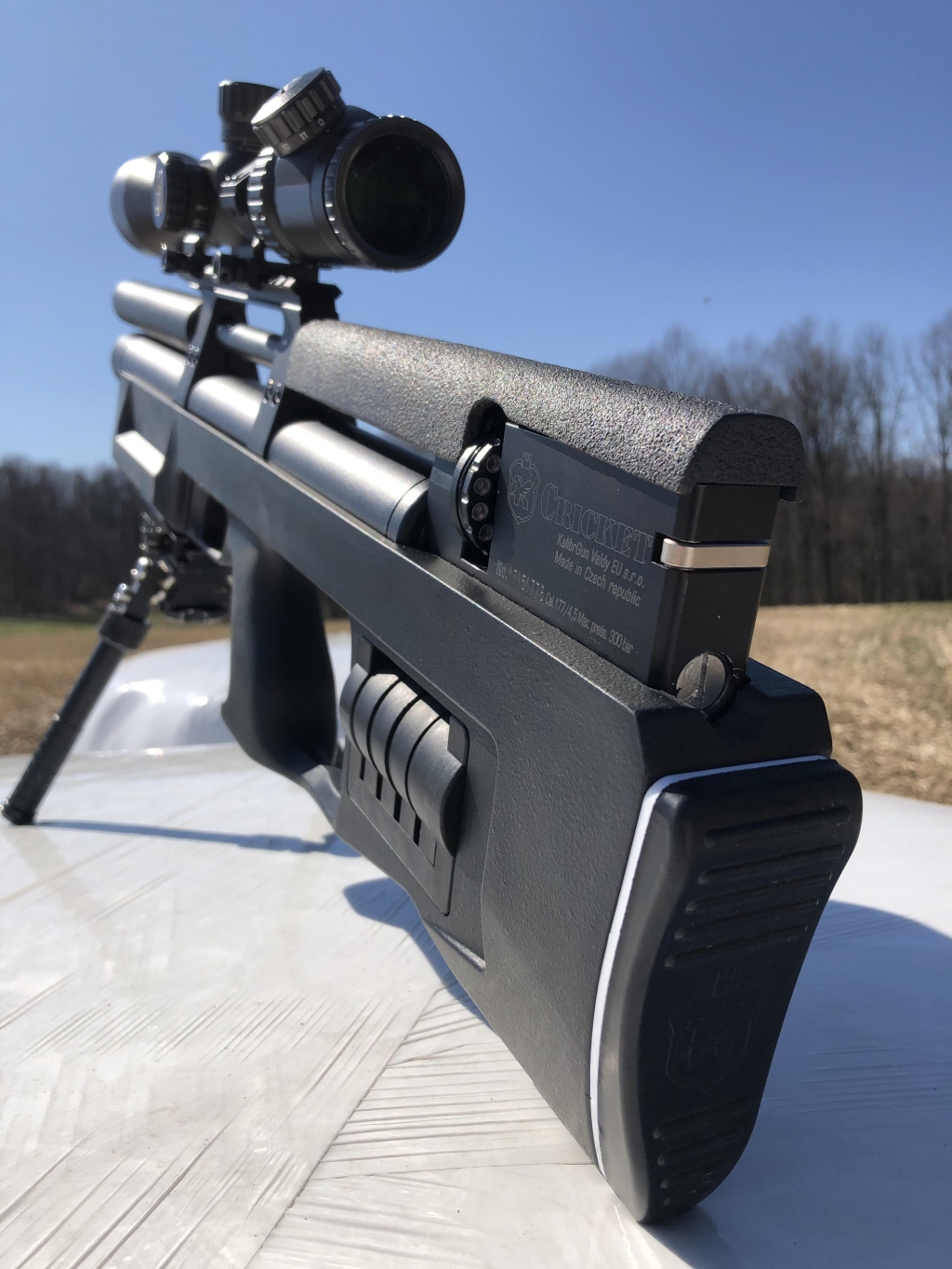

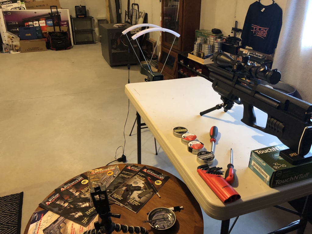

I just started using a Kalibrgun Cricket Compact .177cal and tuned it for the JSB Exact Diabolo Heavy 10.34g at avg. 885fps and It shoots pretty good in moderate wind out to 50yds where I’ve tested it so far.
This gun is a laser, makes shooting tiny groups a breeze, this gun as it’s tuned will produce over 100 shots per fill. Currently testing other pellets at 115-120bar setting and find that this setting allows me to shoot my favorite pellet (10.34g Heavy JSB) at approx. 885fps but that reg setting also allows for me to shoot several other weight pellets at speeds that still maintain accuracy. Example: the reg currently set between 115-120bar will let me shoot the 10.34g JSB at 885fps but will also shoot the JSB Exact 8.44g & AA Field 8.44 at approx. 930fps while still maintaining accuracy, I can also shoot the JSB Monster 13.g at 810fps while yet again maintaining accuracy. I believe 120bar is the factory setting. This gun is really fun to tune!!!
