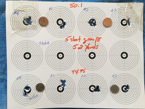

I went through that testing last year in preps for EBR. However, my gun is an ST barrel, not an STX barrel in a .30 FX Bobcat Mk2. What I found was that at 52 yards, both the 44.75 grain and the 50.1 grain were almost identical in accuracy. I finally decided to use the 44.75 grain pellets since they were slightly more consistent at 75 and 100 yards. I may end up using the 50.1 this year due to its significantly higher BC and the swirling winds encountered at the range we use at EBR...I shot the 44.75 grain at 885 FPS, and the 50.1 grain at 850 FPS.

Nice. Mine came shooting the 45s hole in hole at 50yds at about 827fps. I will be hunting a lot and needed more, so I tuned it up n started with the 50s. I found a couple tunes that the gun loved, but not the pellets. Gun was slinging em very consistently but they were not stable anywhere from 790-890fps. Turned the reg down again n started over. Hit another sweet spot for the gun right at (according to the fx manometer) 150bar. Hammer spring tuned all the way to max n valve stop waaay open. Extreme spread 6 with a SD of 1 in 14 shots. Next 14 ES of 6 with an SD or 2. So super consistent. 853fps avg. pellets one ragged hole at 50. 853 awesome 849 not lol. I even tried like 865fps, moved hammer to 5 for 855fps, then tweaked valve stop to avg about 850fps. Same velocity basically but the gun hates it. ES like 25 with SD of like 12. She wants to be wide open.
