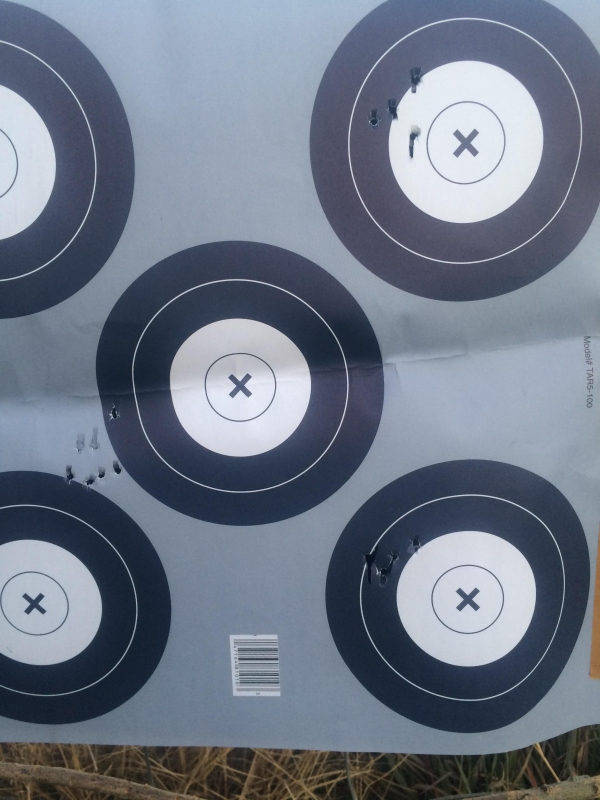

Heres a test I did last year with my Royale 500 to see my wind drift at 100yds. I had a consistent 6mph wind right to left. Air Arms 25gr were shooting 910fps, 34gr MK2 were 810fps. Top right target were MK1, lower right MK2, center were 25gr. Holdover was full mildot between the 2 sizes. Today I shoot the MK2 at 825fps in the Royale 500, the group shifts closer to center. I defiantly like holding less for wind with the heavies. I recently went back to 25gr in my wildcat and had to relearn my wind drift with them. I was only able to get a max of 815fps with factory set reg pressure. Eventually I plan to turn up reg pressure to get into 830+FPS to run the heavies again.
