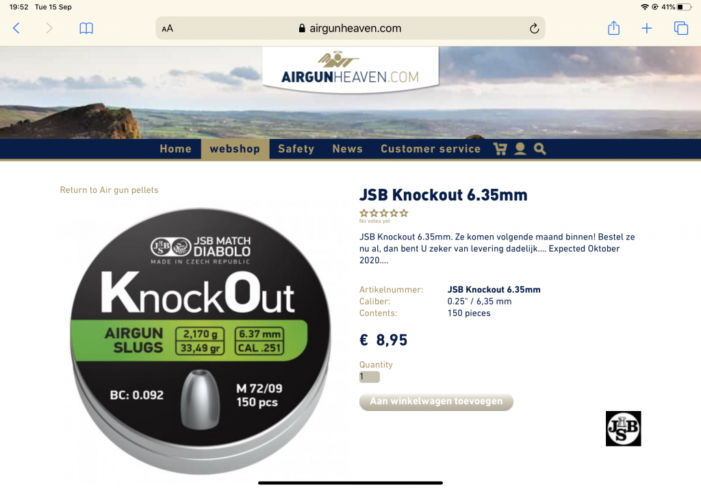

Here is a store in Netherlands / Belgium you can get the 25 jsb slugs from, if you want them bad enough. If they won’t ship them too you and you still want them bad enough, let me know and we can route them through me.
https://airgunheaven.com/en/air-gun-pellets
