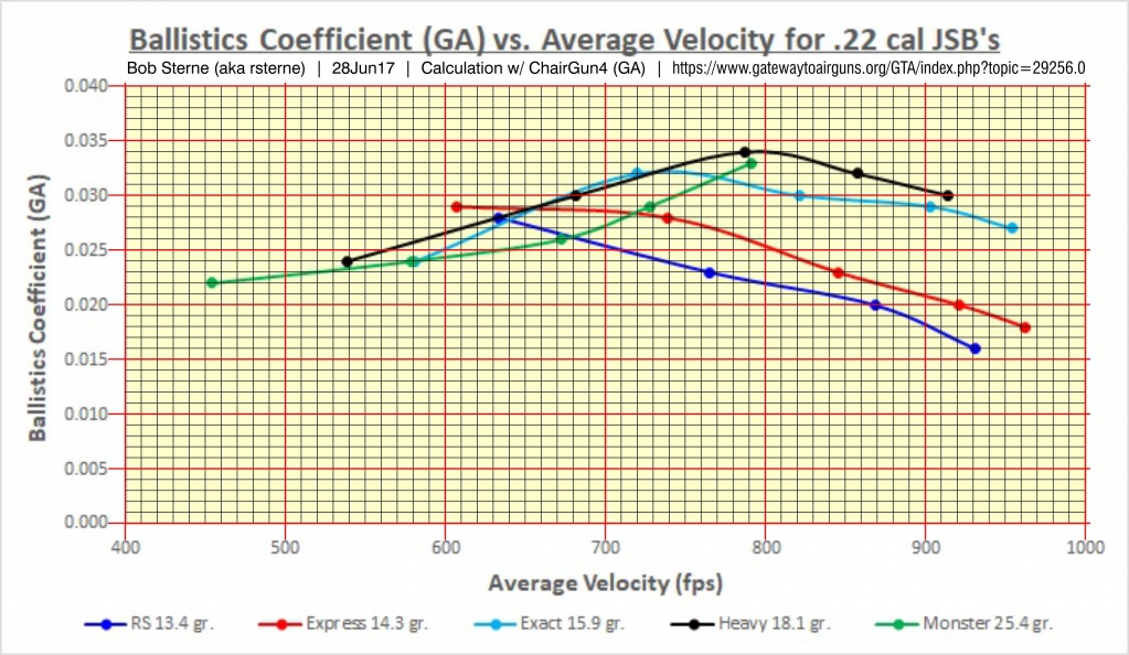

However, the biggest difference for the BC for the same pellet/ slug seems to come from the velocity (muzzle to impact).
Bob Sterne did a very helpful graph for the domed JSB line in .22cal, cf. below. And Strelok Pro allows you to enter various velocity-dependent BCs.

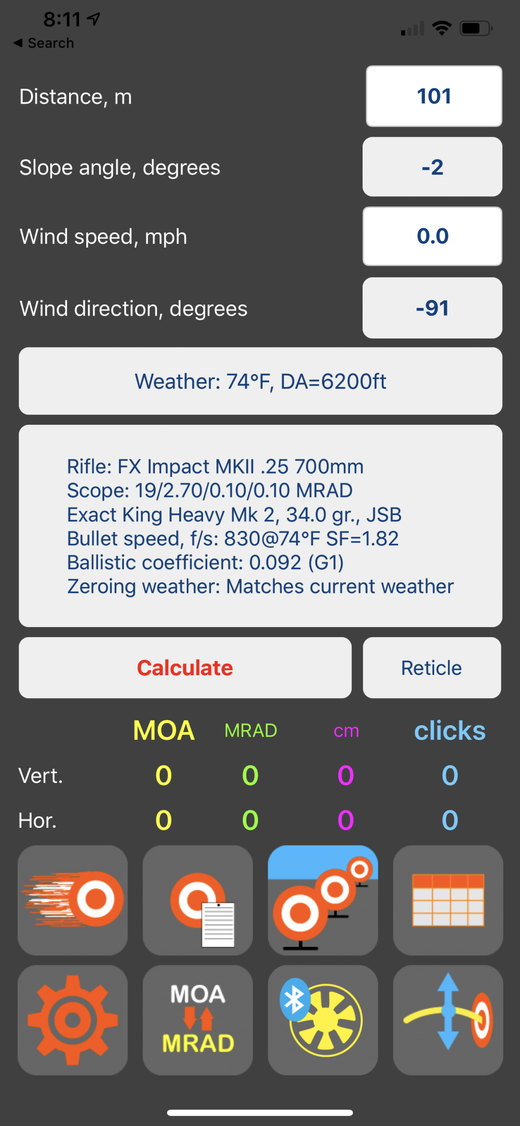

I left it on G1 because G7 BC doesn’t go down to pellet granularity. I used 2 separate ballistic calculators and the same calculators have been pretty spot on at 1200 feet. I also only changed BC in the same ammo profile, not a new profile. I’m at lost too.
as you can see Sig’s app automatically updated the altitude and temperature and validated with my buddy’s Garmin GPS unit. This is Hades’ data, probably could use a little more BC to align 100 meter shots better.
Same environmental also in Strelok and lines up identical with Sig app calculation on both ammo so I assume calculation is correct and alteration to BC would align both app’s calculation with my POI at ranged targets up to 120 meter or 130 yards.
