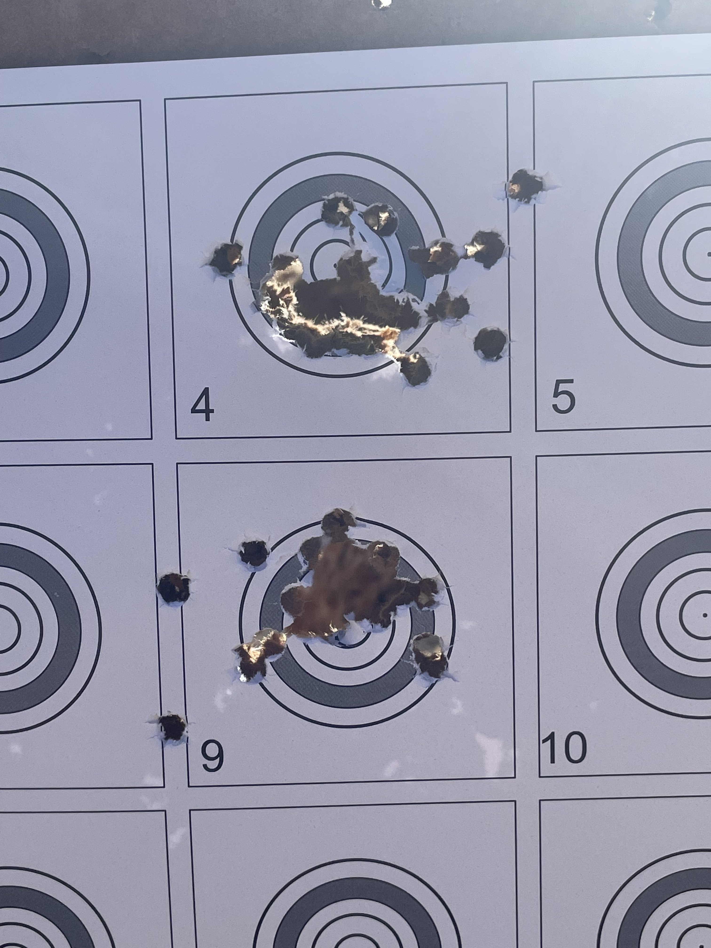

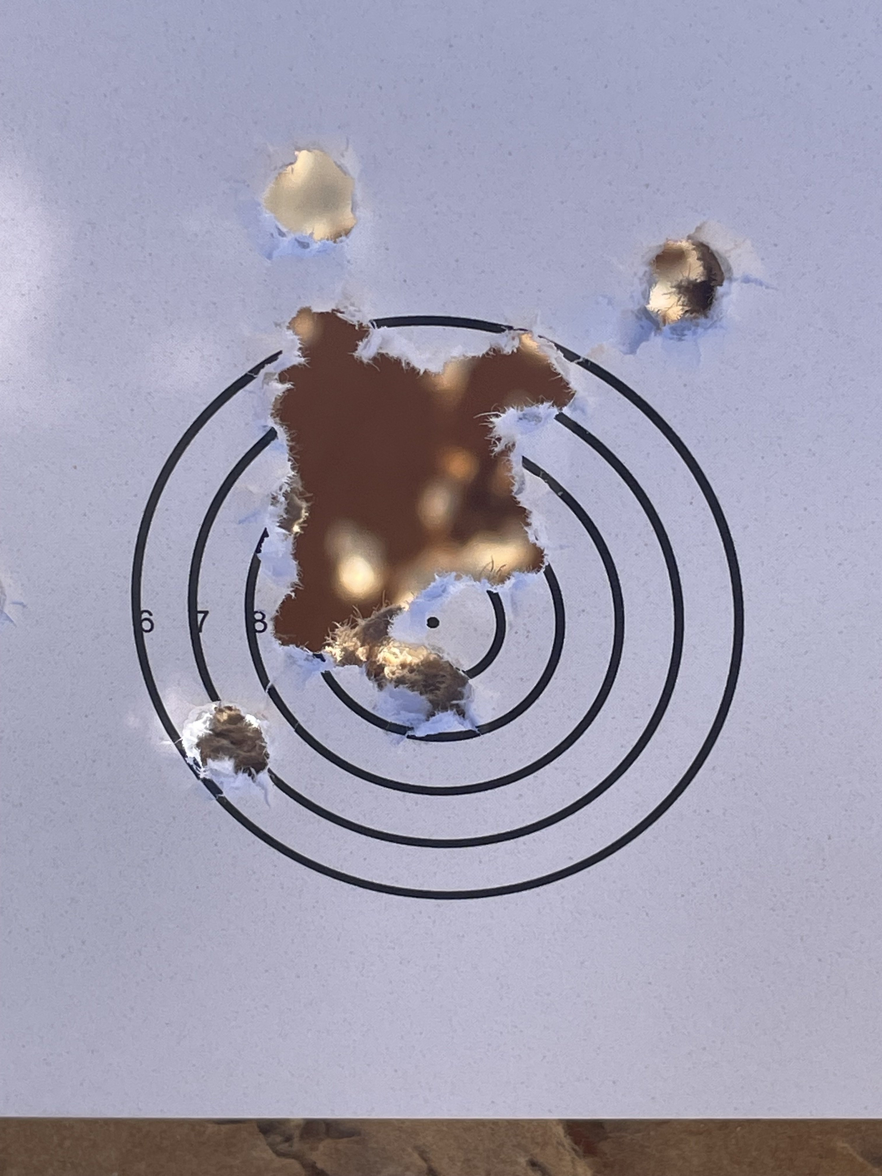

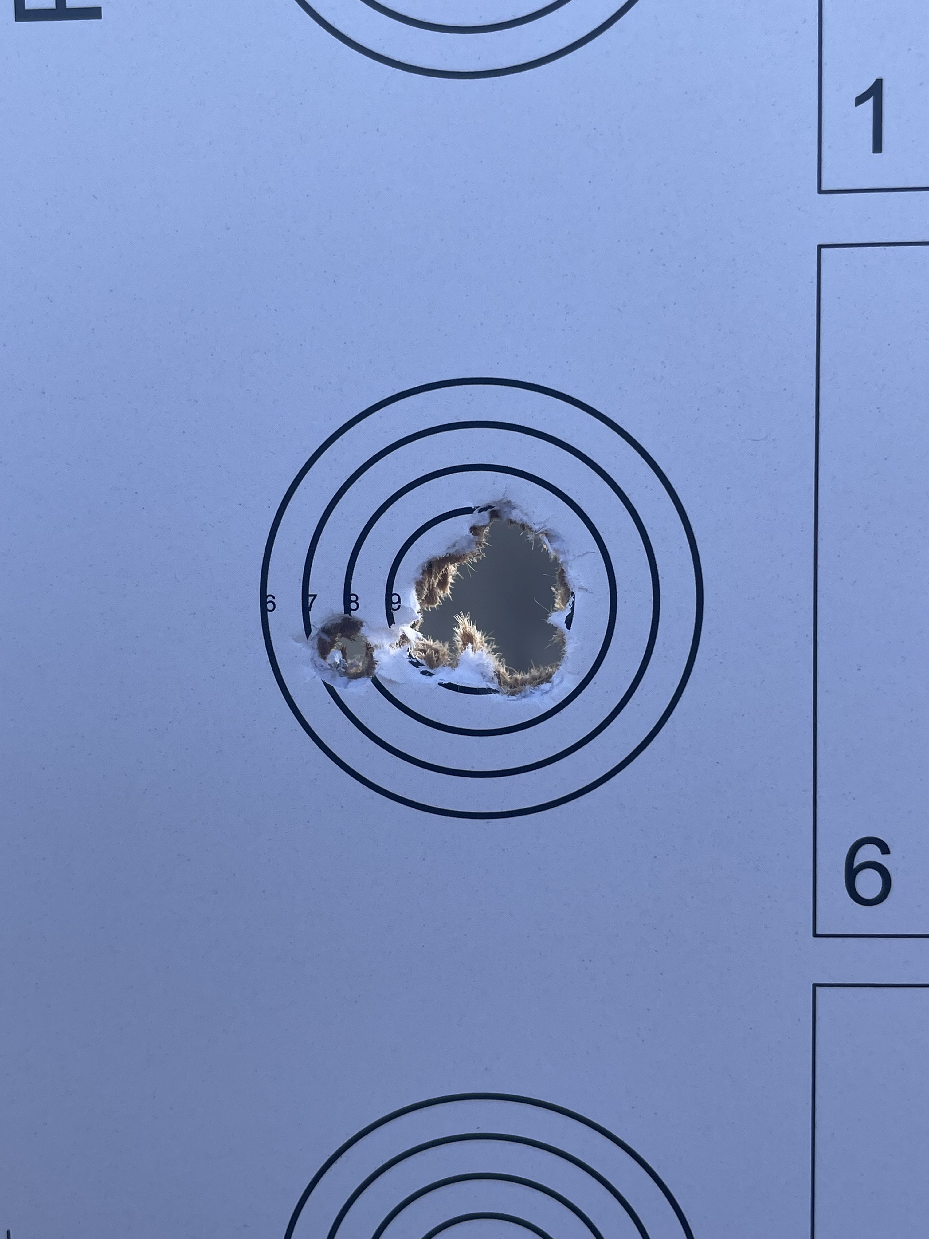

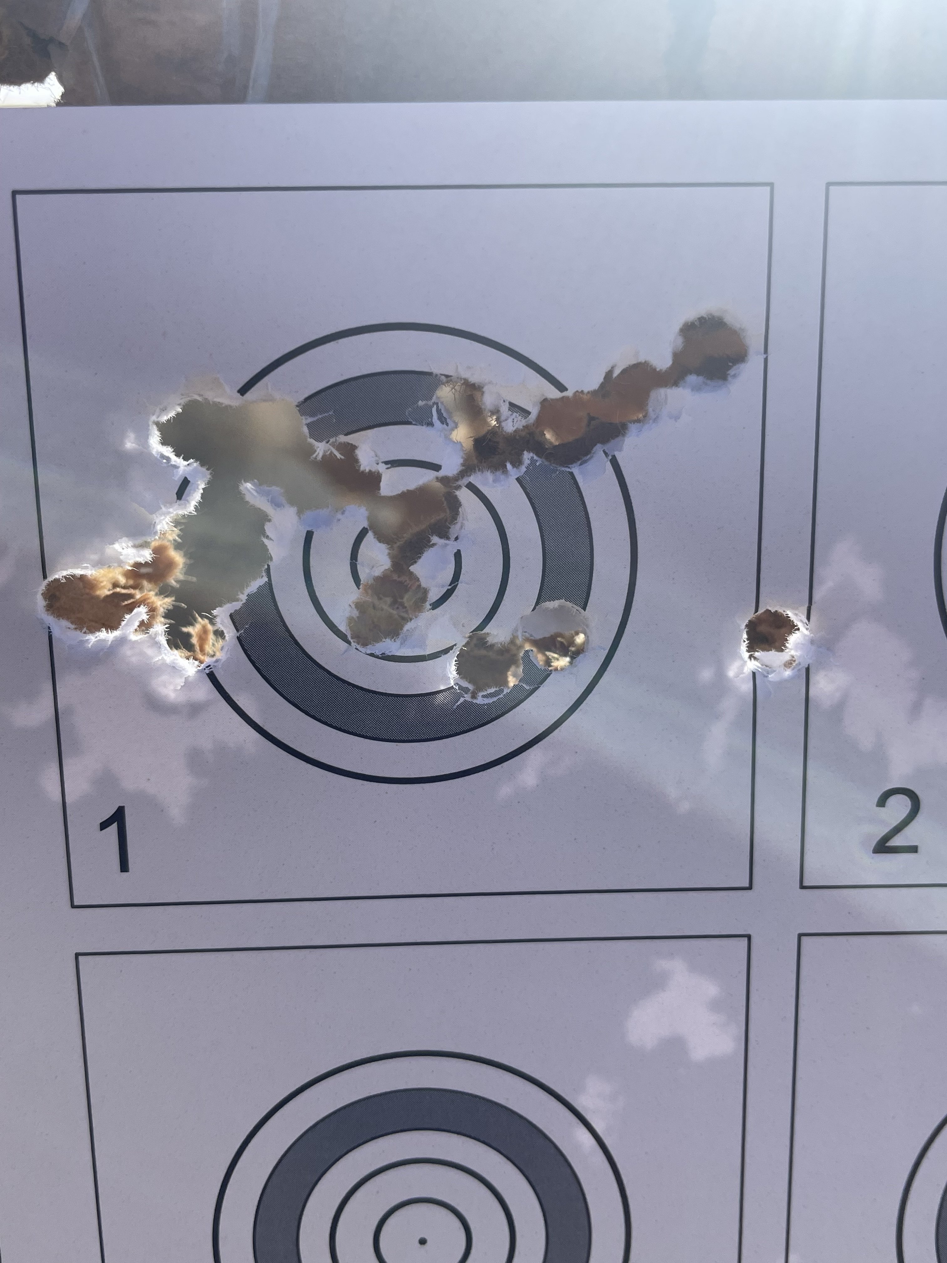

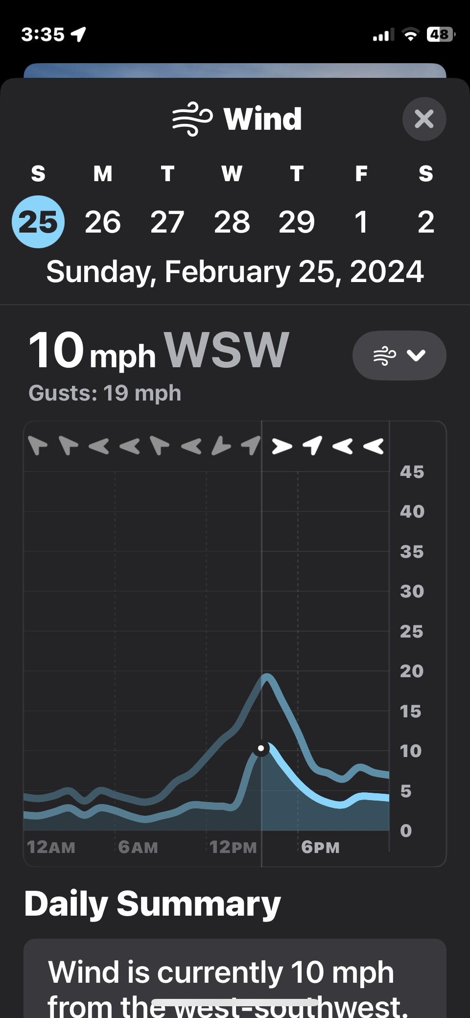

Here's a few 25 shot groups at 100y yesterday. The best group was FX pellets straight from the tin. The wind was fairly heavy quartering over my right shoulder at 10 to almost 20 reported. I was holding 2-3 bulls to the right for these groups. I also shot one 25 shot group at 50y. I was holding into the rings of the bull to the right for the 50y.
I saw zero flyers during my shooting time.
Mike
