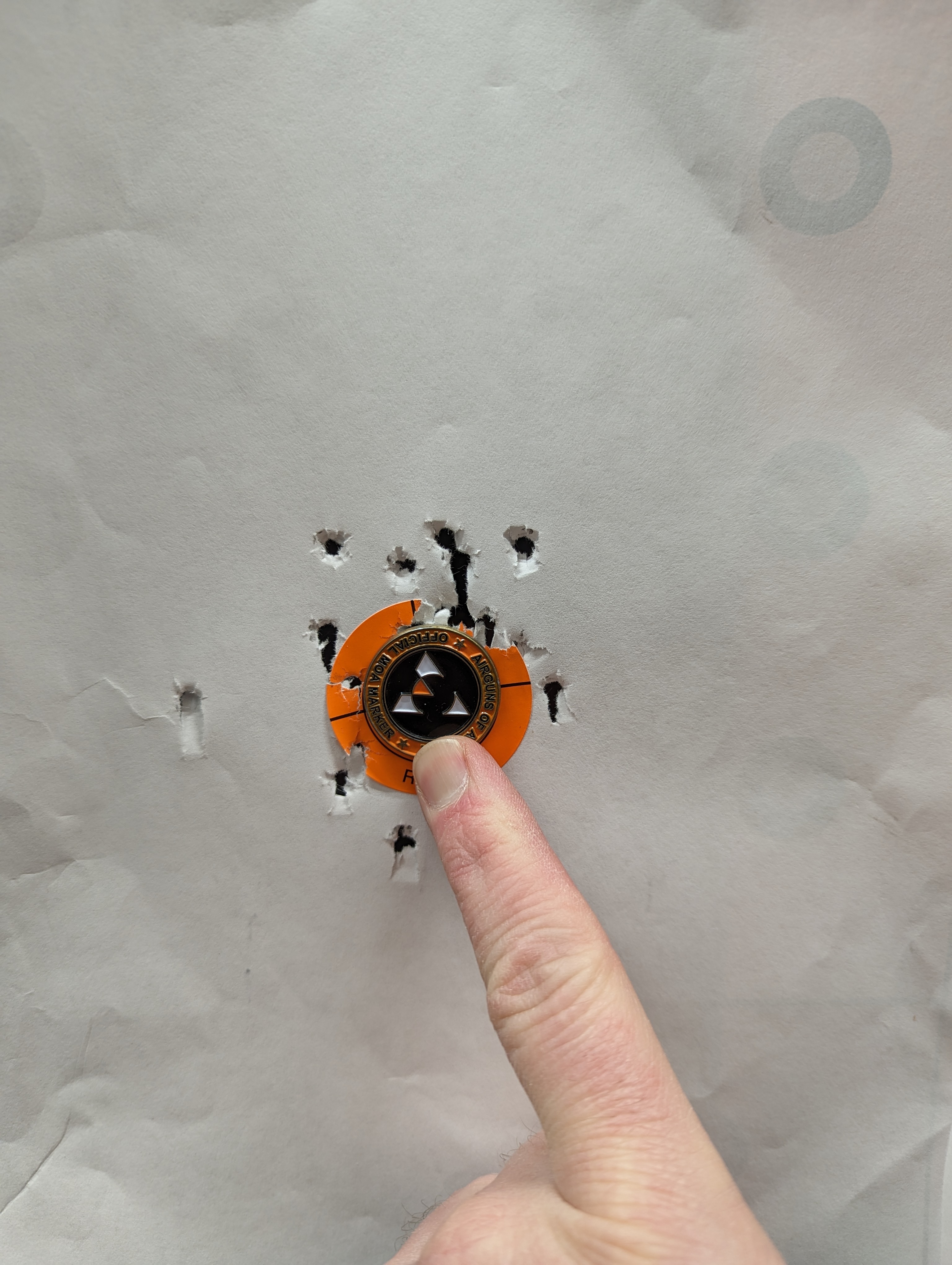

The last five cards that average 231 were shot with unsorted pellets. The previous 4 years worth of cards averaging 205-220 were shot with unsorted pellets, except for one sorting experiment. Sorting those couple of tins in that experiment produced slightly better results, but did not eliminate the unexplained flyers. If sorting was the answer, sorted pellets would not produce flyers.
Sorting is a bandaid with much better results in the psychological/confidence department than the accuracy department.
I compete (mostly field target) and don't sort pellets for competitions. I win my share of matches, always using unsorted projectiles. I also shoot probably 3-5 100 yard EBR cards a week. Granted field target doesn't require benchrest accuracy, but 100 yard benchrest accuracy is not 50 yard benchrest accuracy.
When a gun/tune/barrel is producing flyers with MRDs @ 100 yards, sorting will not eliminate them.

I tend to agee that sorting will not completely eliminate the problem, but it will likely help your scores. Pellet hole placement from a 9 to an 8 frequently can only be measured with a scoring plug because the difference can be so slight. Just a difference in 2 or 3 points can mean winning or losing a match.
