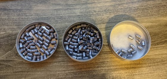

With the match tomorrow, I decided that I'd do a little look see at the pellets and maybe even sort some out. I have a scale, sigh. So I weighed them as I went.
Here are the results.
Left pileis about 45 "good ones" no divots in head, nice round skirt, weight of 25.3 or 25.4grains.
Middle pile is minor dents in head, maybe a slightly out of round or thicker on one side skirt, weight of 25.2, 25.5 and two that weighed 25.6grains. Didn't count these, but maybe twice or 2.5 as many as the pile on the left that is a known 45, so, call it 100-125ish.
Right pile is really bad divots in head of pellet, didn't even weigh these. 14 here.

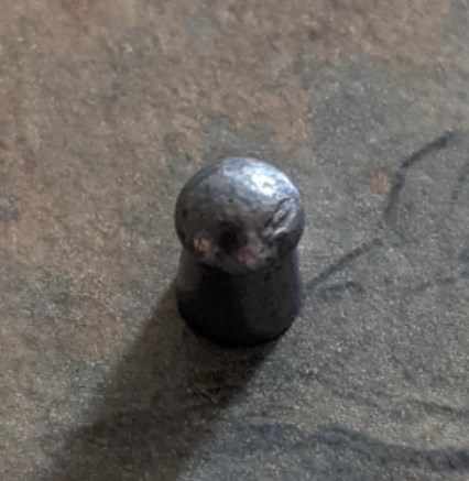

This was the worst of the bunch.
