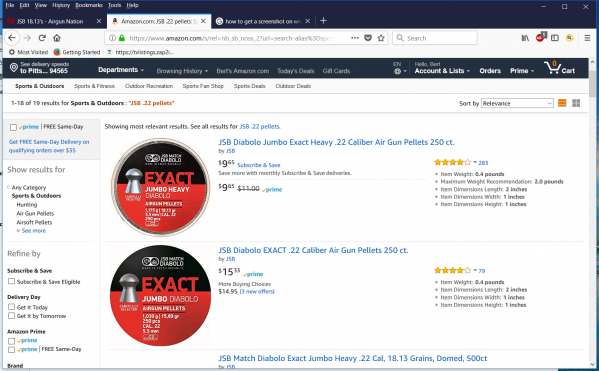

OK, so here's a screen shot of the first 2 hits from a search using "JSB .22 pellets on amazon.com
1528222963_4518253535b16d4f3a1ecd7.48708592_Screenshot 2018-06-05 11.19.06.png
Appears to be 2 different weights. 18.13 vs 15.89
"redcrow"Well now, this is interesting. I can't find any 'non-match' JSB 18.13 jumbo exacts. I have found some vendors that don't use the word 'match' in their title for them, but the labels all read the same, i.e., from top down, "JSB Match Diabolo Exact Jumbo Heavy .22 Cals, 18.13 grains". What am I missing?
Maybe that's all it is. Some vendors don't use the word "match", and are just overpriced. New to airgunning, and wasn't sure if there are match and regular 18.13 gr JSB's.
