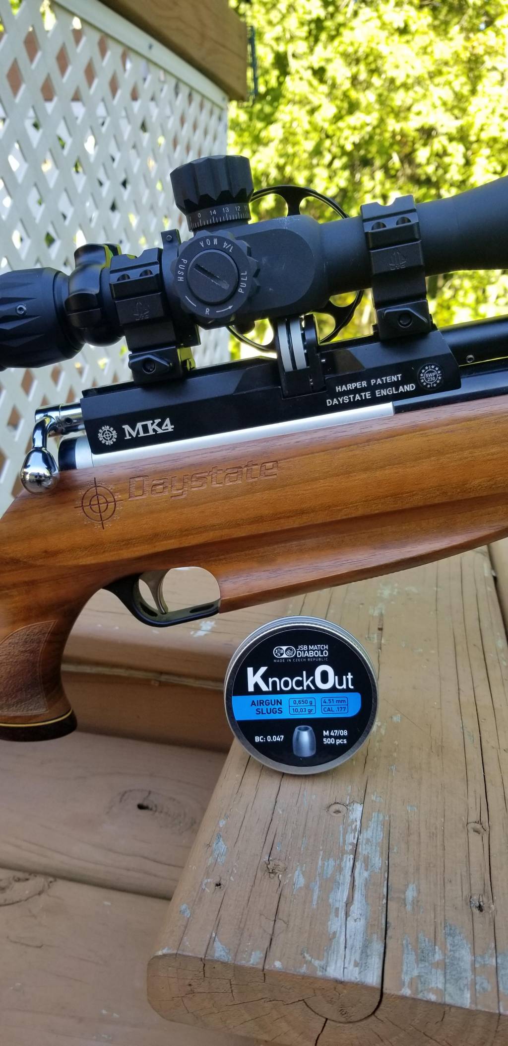

Jsb .177 knockouts in daystate

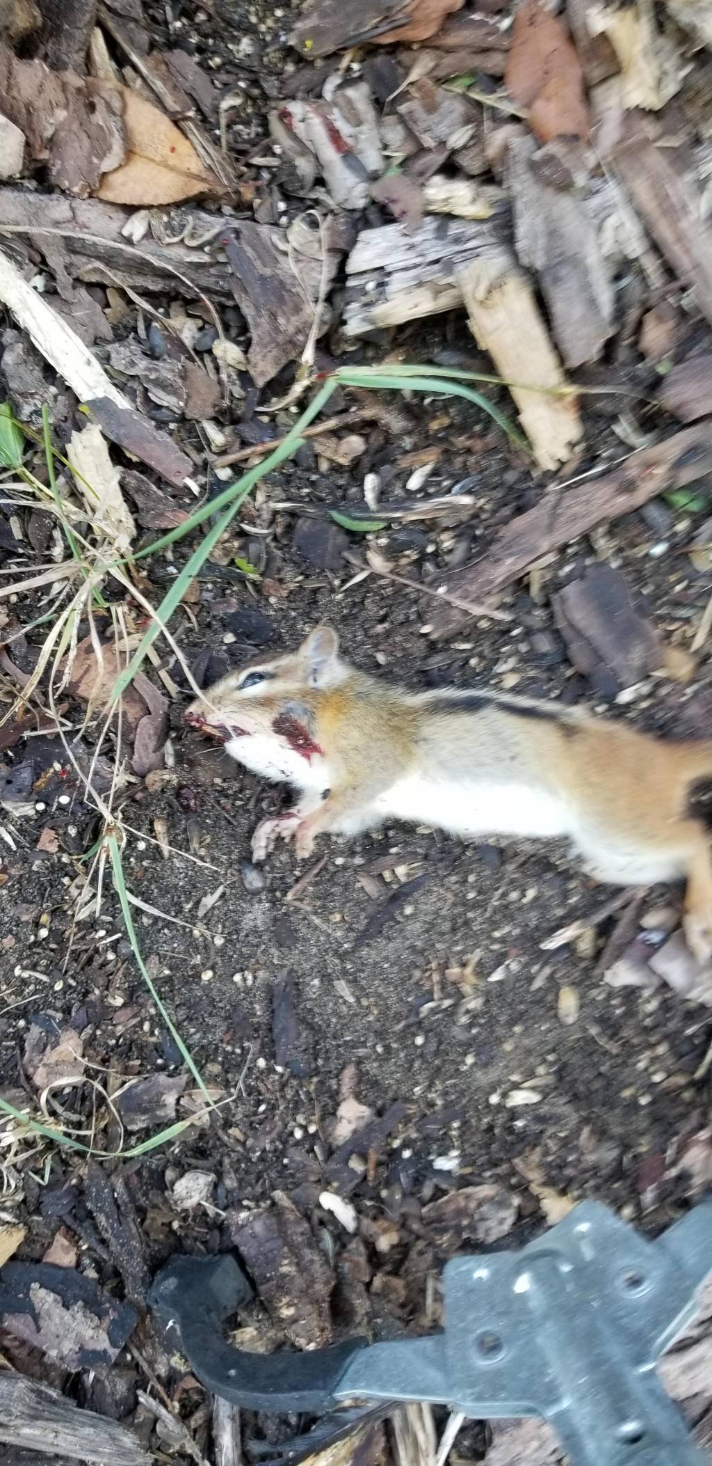

You never know how slugs are going to preform in a LW barrel but in my old and amazing daystate mk4 the new knockouts are a little under a half inch at 42yds. Definitely minute of chipmunk. I haven't tried chronographing them yet but I'm guessing about 850
