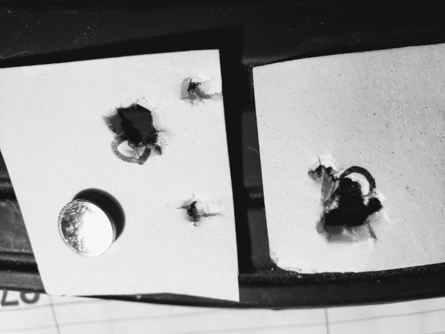

I turned the striker adjustment in all the way to a soft stop and backed out two turns. Then doubled the hammer adjustment to 6 turns in from when the threads first caught. That led to a louder shot cycle, not what I considered optimal. I backed off one turn to 5 on the hammer and just that one turn quieted things down a lot. At this point I decided to see how the accuracy was and below are the results of 10 shots, 5 on each circle. An occasional flyer due to wind or even me is a reality and that comes with every gun. I will hold these adjustments for now to see if they themselves hold for me. I didn't see what the chrony said because the results were too good, but I may fire it up later today.

So for now, the results of 40 yard shots are shown below.
