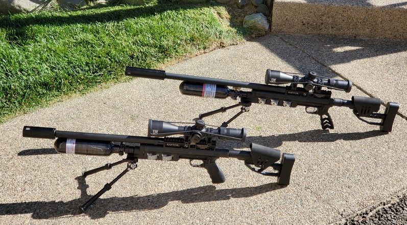

I have a Raptor HP .30 cal, as well as a Raptor mini .22 cal. I shoot them regularly and they are both a pleasure to shoot. I had issue with the .30 cal mags, but that was resolved. Other than that, I have had no issues with either.

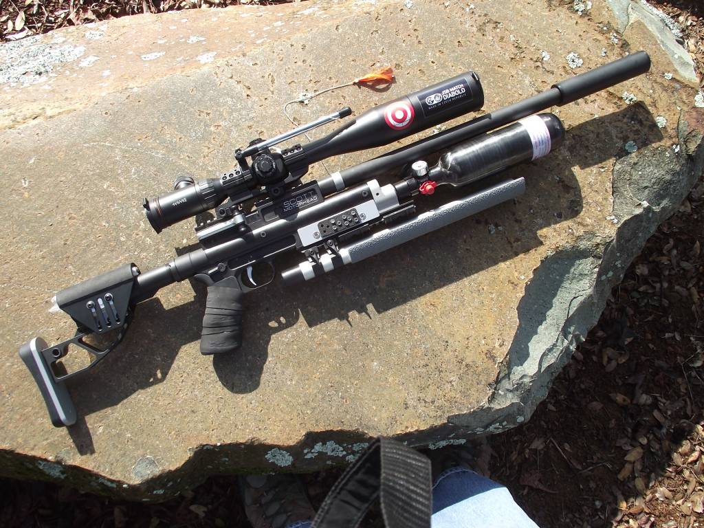

Still have mine ... been caliber swapped a few times ... heavily modified / massaged it now lives as my .177 slug shooter. 15gr NSA at @ 1040 fps gets it done !!
