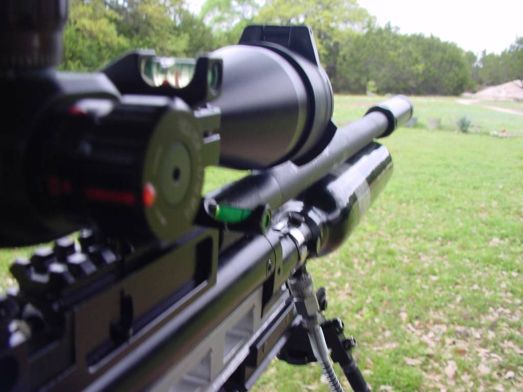

Jacob sent the updated trigger group for mine and it has changed it complet persona. I Had issues at first. as Ordered a slug shooter and rec's a pellet gun. I don't really shoot pellets. I ended up installing first a as yet back then FX Superior Heavy liner inm .22. It shot ok, but not stellar. Next I installed a Brownells Gunsmithing Supply Redmans .22 liner that came in at .2227. Man,it is a laser. I used heavy CF Twill tubing on both in double layers for a very still, yet very light Bull Barrel configuration.

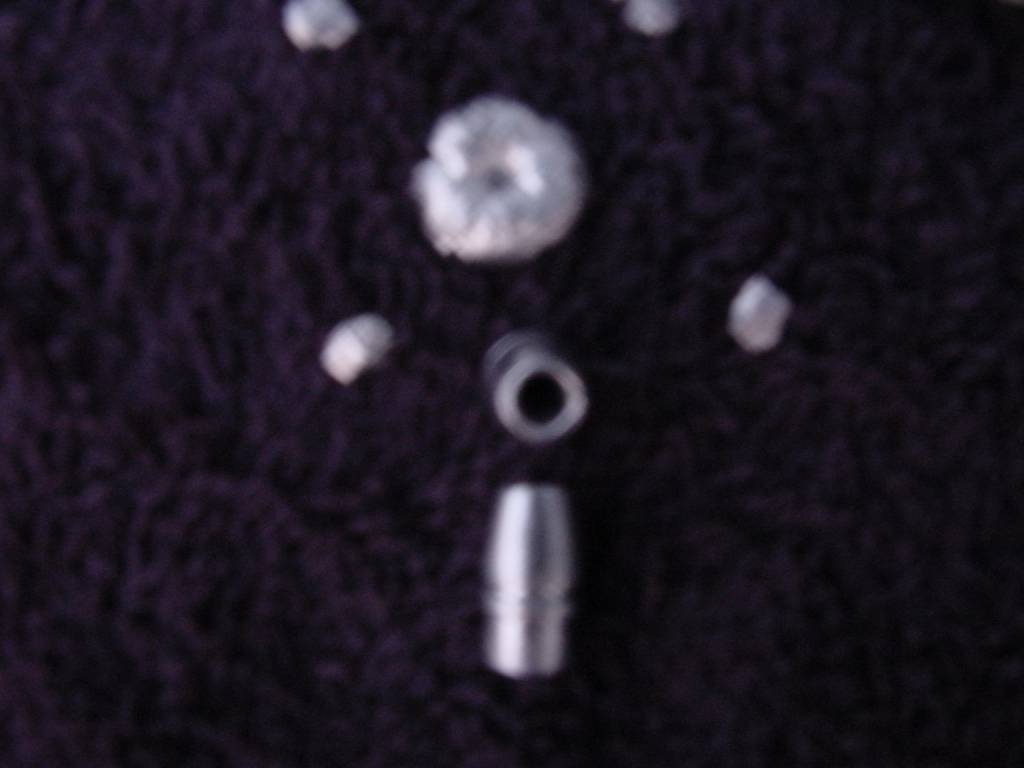

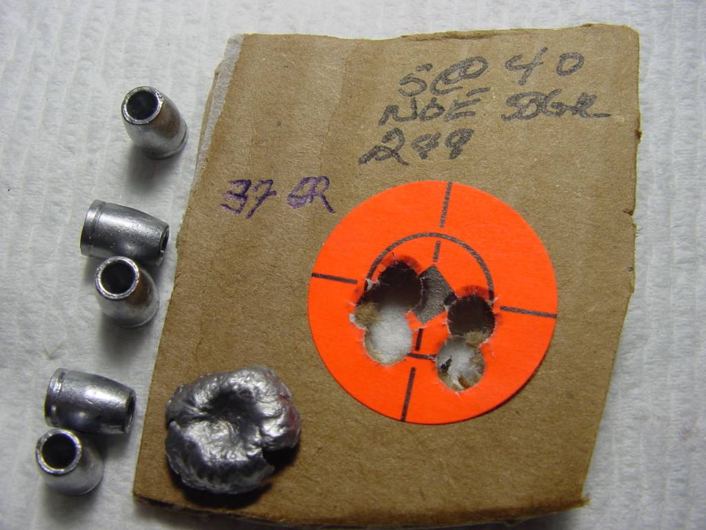

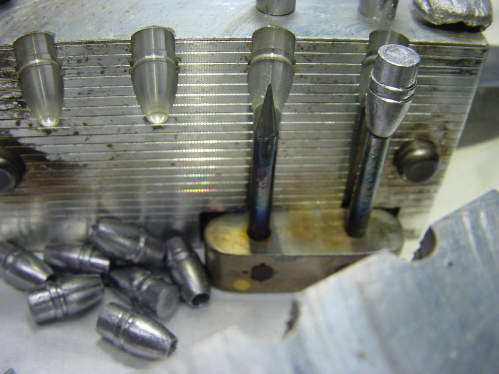

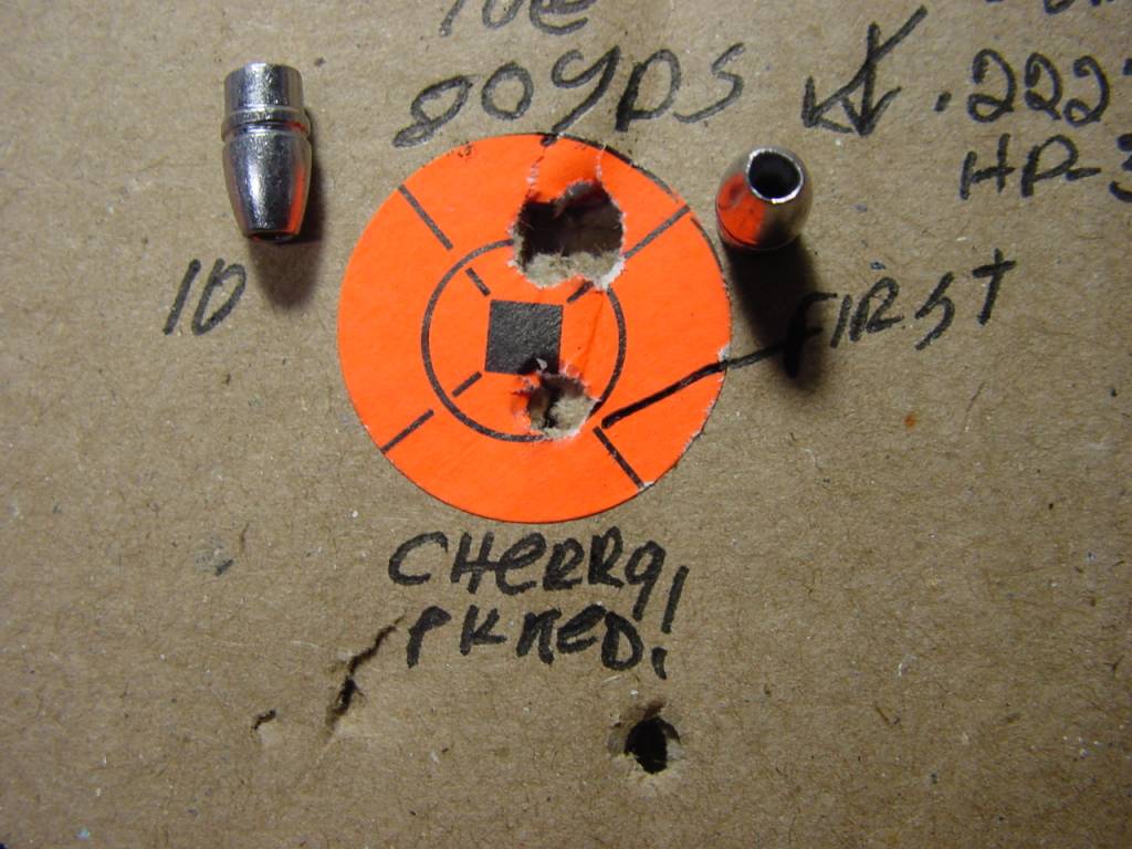

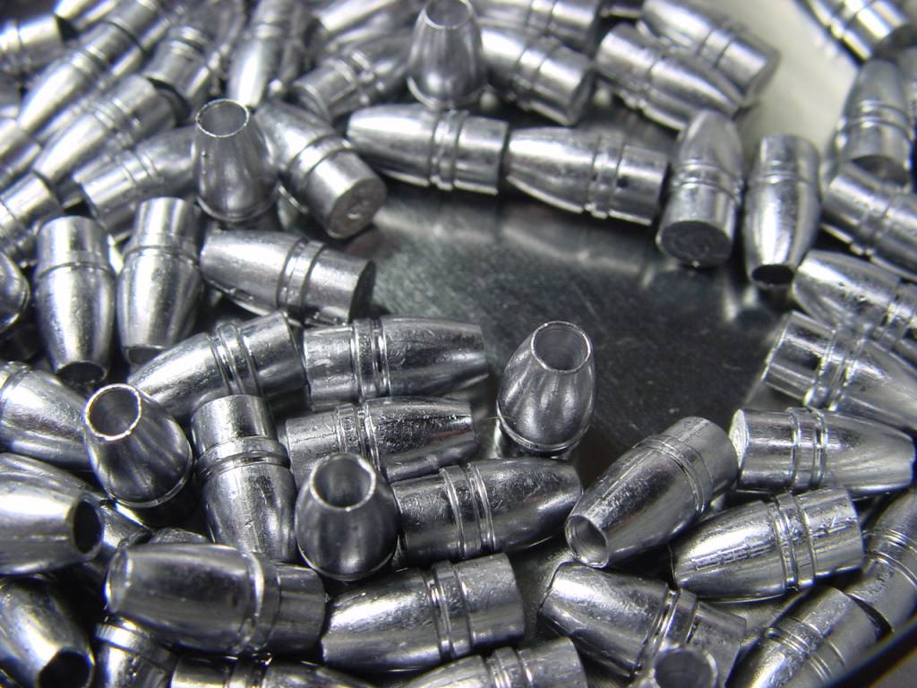

Cold front passing thru to day in Central Tx.. 25-26 north wind, wit up to 37 mph gust. But I had to try my latest creation out. A HP modded NOE cc-1 mold that I added a slider and hp pins. It was just an experiment. Woha! Most accurate slug in .22 wind and all I have ever seen. three shots, three hits on steel at 76 to 80 yards dead on and all touching. Iam including a pic of groups, one a 10 shot with 9 in
the same hole. Not a ragged hole, but one single round hole!. I will include a pic or two of the mold, slugs and the gun as it appeared a month ago. And a pic of the Removed choke and cf sleeved .250 barrel and my slugs. The
.2227 slg is going to defistating on vermin! Knife

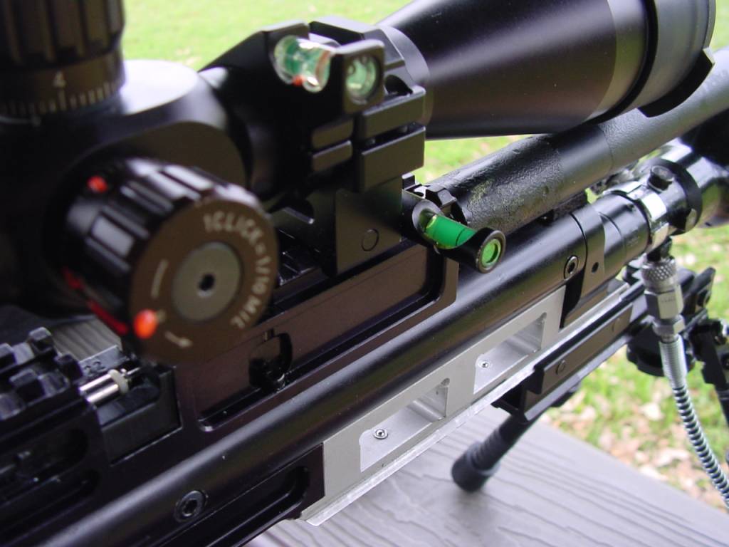

It now supports an Accu-Tac SR-5 G2 on an extended rail and a Zeiss Scope, so it is ever evolving. The shrouds are now silicone rubber clad and using both theN.Clague and Donny Fl, wichis theShoGun verson.
