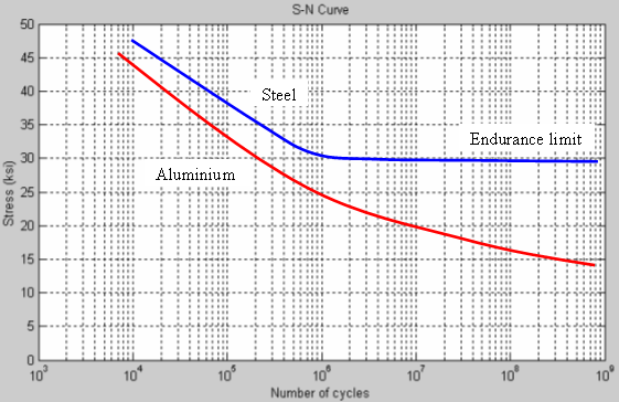

Properly designed steel tanks don't fatigue and can have a infinite lifespan properly cared for. I would trust them more than CF, but they are too heavy. Aluminum almost never has a infinite lifespan and will in enough cycles eventually fail. The key is to design aluminum tanks strong enough that for all practical use, the number of cycles at a given stress level never gets close the the fatigue limit. What does the curves look like for CF? I don't know, but the deep diving sub makers all use steel not CF, except for the one company in the news for a terrible fatal accident. That sub and a number of problems not only with the CF shell but using windows not rated for the pressure they were subject too. What idiot would get into the sub?

A long time ago I got my BS in Mechanical Engineering. I agree steel is a better material from a fatigue standpoint than aluminum. I don't know about carbon fiber. In theory aluminum never has an infinite fatigue lifetime but the number of our fill cycles on our tanks is not very high from a design standpoint. So from a practical standpoint aluminum can still have a higher fatigue lifetime than we can ever achieve. The advantage I see in the carbon fiber is in the way it is applied presumably because of the low weight. Instead of making the thickness 150% or 200% of what is needed to withstand the pressure it appears from the destructive tests that the carbon fiber is much thicker than this. That extra thickness will not prevent leakage but is likely to contain any tears in the aluminum liner so they cannot get to us. I also do not think moisture will significantly degrade the carbon fiber as it can aluminum.
