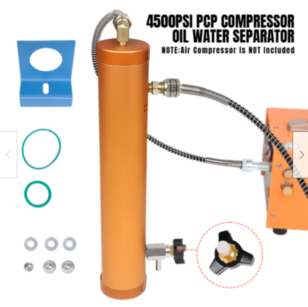

Don't see anything wrong with those Tuxing filters, just not seeing any coalescing action. If you search eBay, "Yong Heng filters," about halfway down page, you'll see the copper-colored coalescing filter from my picture for $149. Scroll thru the diagrams which explain how the coalescing filter works, then compare to the Tuxing. The cotton-filled cylinder would trap moisture, but I wouldn't consider it on par with the coalescing filter. WM
Awesome, thanks! I just ordered one of the copper filters. I also already have one of those gold Tuxing filters that is filled with cotton. Is it OK to use that downstream of the copper-colored coalescing filter, or should I really get one these? FWIW I live in a low humidity part of the county.

Nothing wrong with Amazon one, I prefer the M50 since it has burst disc protection. I'll include picture of Owner's Manual so you can see what it looks like. My system has the copper-colored coalescing and the M50 as well as two cotton-filled filters, one that came with Yong Heng (Black) and one leftover from my hand pump days (Blue). I included cotton-filled filters since they weren't doing any good sitting in a drawer, they don't hurt anything, and offer some filtration. Black YH filter used to get soaked before I added copper-colored one, clean and dry since. WM

Nothing wrong with Amazon one, I prefer the M50 since it has burst disc protection. I'll include picture of Owner's Manual so you can see what it looks like. My system has the copper-colored coalescing and the M50 as well as two cotton-filled filters, one that came with Yong Heng (Black) and one leftover from my hand pump days (Blue). I included cotton-filled filters since they weren't doing any good sitting in a drawer, they don't hurt anything, and offer some filtration. Black YH filter used to get soaked before I added copper-colored one, clean and dry since. WMView attachment 342539

I agree with WM and others on using the bronzish-colored coalescing unit, inline before final desiccant filters. My only comment would be in the picture of the blue filter above, the carbon portion of the filter tube is wasted space. The carbon is only useful to improve the quality of breathing air, which is irrelevant in our world. I have a similar but copper-colored Tuxing labeled cylinder that's loaded with molecular sieve.
