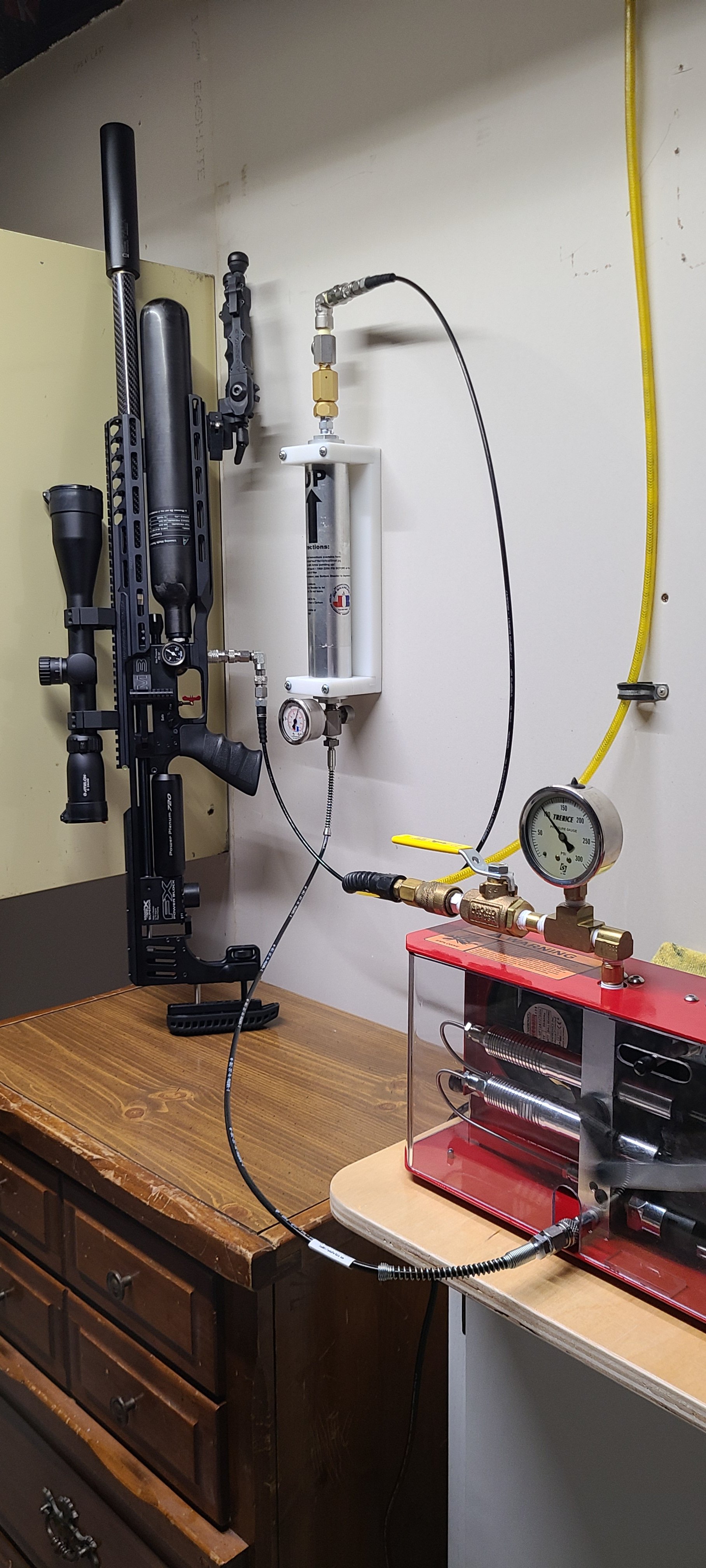

I've seen the video and agree both filters appear well designed and quality, however, IMO, you've already purchased the long gold filter why not just purchase a $125 coalescing water filter on eBay, seeing that the coalescing part is all you lack? The copper-colored coalescing filter in my set-up uses baffles to channel heavier water/oil molecules to bottom, for venting, while allowing dryer, cleaner air out top. WM

I've seen the video and agree both filters appear well designed and quality, however, IMO, you've already purchased the long gold filter why not just purchase a $125 coalescing water filter on eBay, seeing that the coalescing part is all you lack? The copper-colored coalescing filter in my set-up uses baffles to channel heavier water/oil molecules to bottom, for venting, while allowing dryer, cleaner air out top. WMView attachment 341901
The copper color coalescing filter on the left in worried man’s photo is the way to go. I use the same one on my yong heng setup and it works extremely well. I have a few extra filters downstream from it and have not found the slightest trace of anything in them. That coalescing filter is awesome, I highly recommend it.
