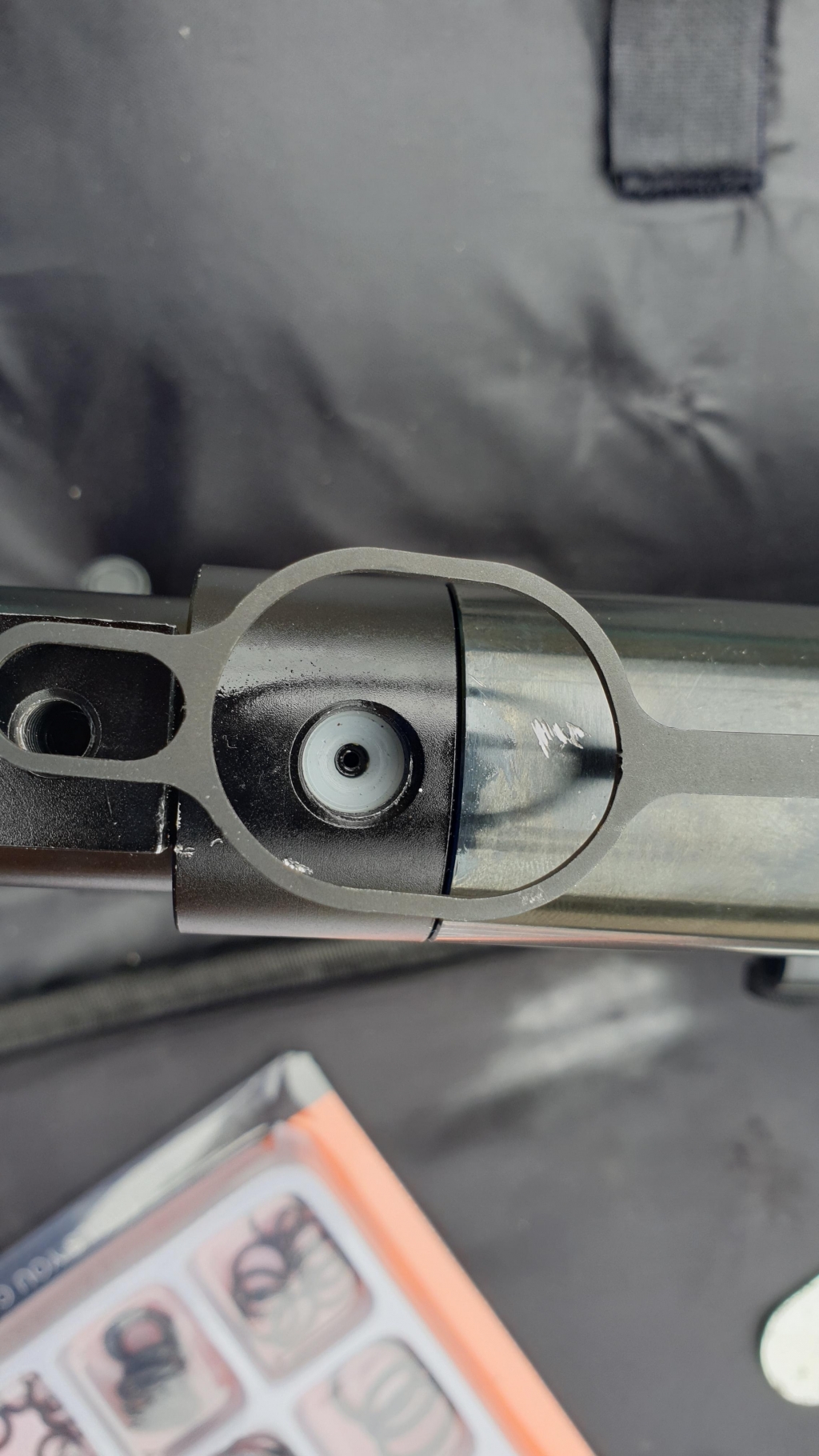

Hi guys I have just noticed a big leak coming through the fill guage, so must be the acetel o ring so I would like to know is it a case of removing it and getting a oem replacement and installing it. Has i noticed there is no extra rubber o ring above the acetel oring so that is the only pressure stop below the pressure guage. Anyone who has faced this problem and fixed it themselves please let me know thanks.

I took the rifle apart again today the acetel oring is the culprit to the leak has i did a balloon test then a water test and the leak is defiantly the acetel oring which is at fault has that is the only thing stopping the air due to no seal below the manometer .
I purchased a full oring kit should be here today. I also did a leak test on the cylinder and no exactly where the leak is. Also with having a huma reg installed you have the main cylinder oring removed due to the reg. So it's got to be the main reg seal so I'll swap them out once the kit arrives hopefully today and then post an update thanks..
Hi guys with alot off fetaling today i tried all the work arounds you guys suggested still with no success i'm afraid. I also noticed after doing a balloon test that my main oring on the cylinder was leaking fixed that and then putting one around the manometer the leak is defiantly coming from the thread of the gauge so that intern has to be the acetel oring. I'm hoping that someone on site has maybe replaced one and knows how to remove one to fit a replacement. Has i bought a full seal kit for my noblesse quite sometime ago and completely forgot about but in that kit is an acetel oring just do not know how to remove it to replace it any help would be great.
