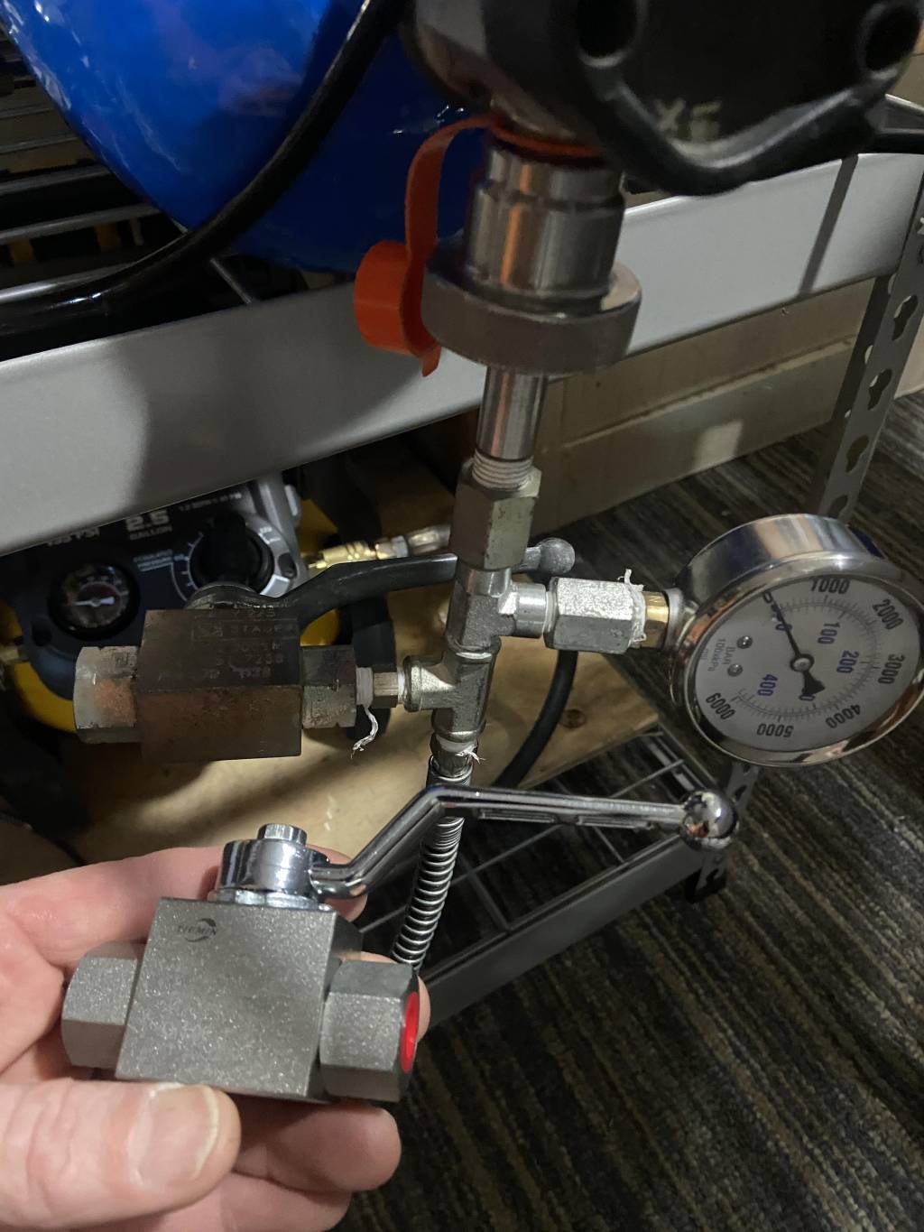

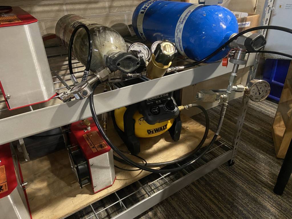

Do you have a pix of your fill station? Is the bleed part of the block or is it threaded on? I have a couple that I made myself. Took a T fitting, added a 2” gauge in the middle, a Foster fitting and hose on one end and a lever/ball valve on the other. simple flick of the lever bleeds the station. So much easier the turning a knob. The valves are related at 7250 psi.
