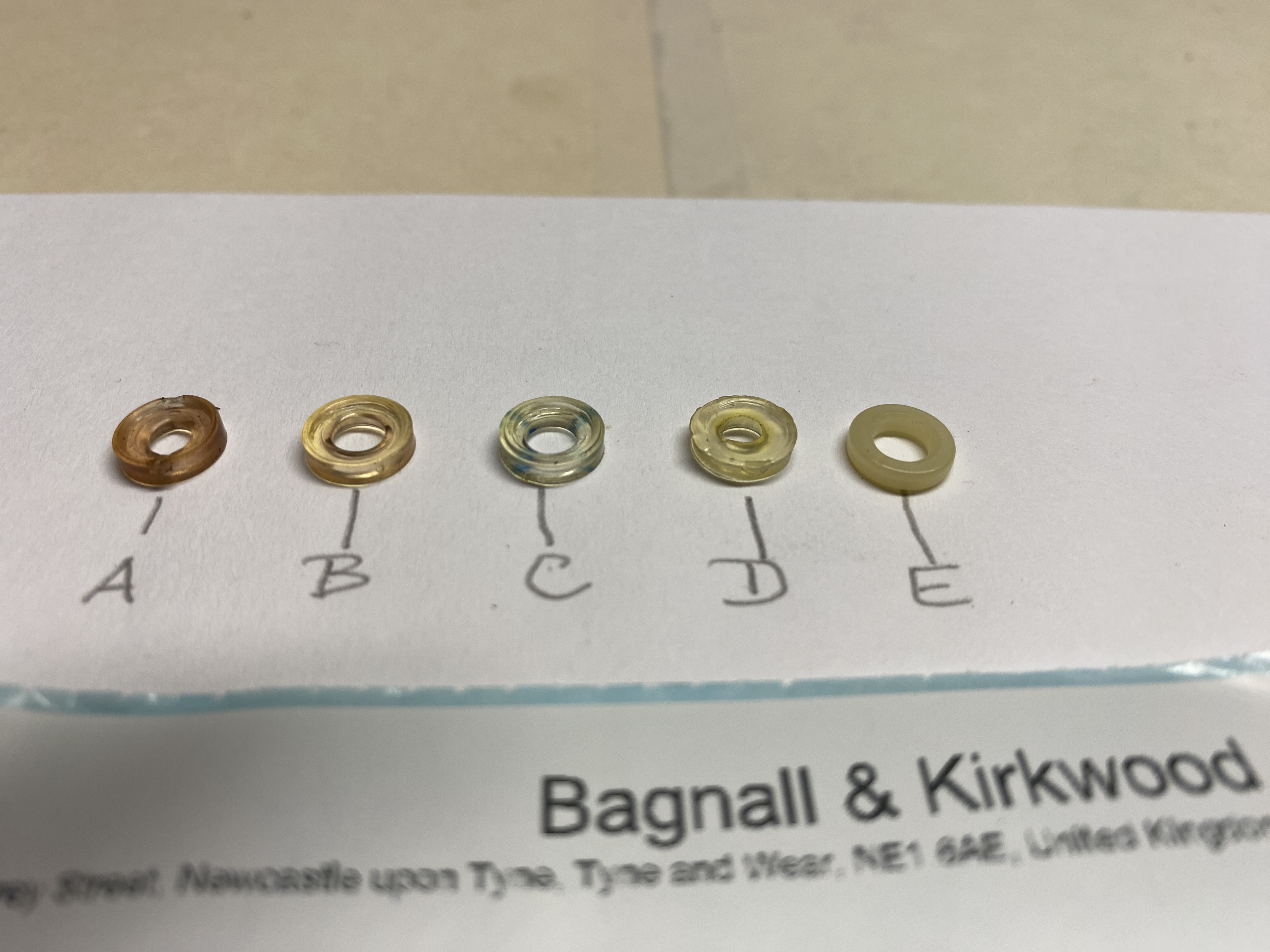

I got my shipment from the UK, Newcastle on Tyne, where they made the RMS Mauritania long ago, a long time holder of the Blue Ribband for the fastest liner to cross the Atlantic. Are you guys saying that the Crosman gaskets are the same thing as those sent to me by Bagnall and Kirkwood? The cost hasn't been finalized as it hasn't hit my card yet- with what exchange rate I got, but it's going to be close to $50 for three polyurethane "O" rings.
I tried one on my 2014 first generation PPK pistol and it did work but there was quite a loss of gas putting it in. Once I gave it a firm tightening it seemed very air tight and it had a very nice POP and firm blowback. I just checked after 24 hours and the performance is the same. I do think that these B&K gaskets do fit but are no better so far than the ones I've been making. The Gen. II PPK/S bb has a home made 8mm OD x 2mm thick x 3mm center hole. That gun has a deeper, more resonant bam when firing, which may be a product of the changes in hardware of the Gen II gun. I'm referring to a firmer trigger pull, and definitely a stronger hammer spring. With my home made "donuts" they often load CO2 in the first and second times with no hiss at all- The only draw back is that they last about 3-4 tubes before having to be replaced.
I'm attaching a picture of all varieties of the gaskets; A= An old original seal from a Gen.I pistol, note the reddish hue from Crosman Pellgun Oil, and the scooped out center indentation. This can be seen in all shown here except gasket E which hasn't been installed yet, the Bagnall & Kirkwood one. B= the gasket from my son's former 2014 gun which he only loaded one cartridge in. C= the gasket that came out of the like new Gen. II pistol I got recently, and looked like it had not been shot very much, perhaps never? D= My last successful homemade 8x3x2 80 durometer polyurethane. E= the B&K sold 8mm x 5mm x 2mm thick, appears to be poly of similar hardness to my DIY seals. They have a slight flat surface on the top and bottom of the donut. If they have a wonderful, long term durability, i. e., holding gas and the ability to be reused with numerous CO2 cartridges, I'll advise this forum.
In a post by me a while back I said I would put blue-medium hold Lock Tight on the brass collar to hold it place, and possibly to STOP air leaks caused by damaged threads in the airvalve. DON'T DO THIS!!!!! IT LOCKED THE BRASS COLLAR SO HARD I COULD NOT REMOVE IT!
