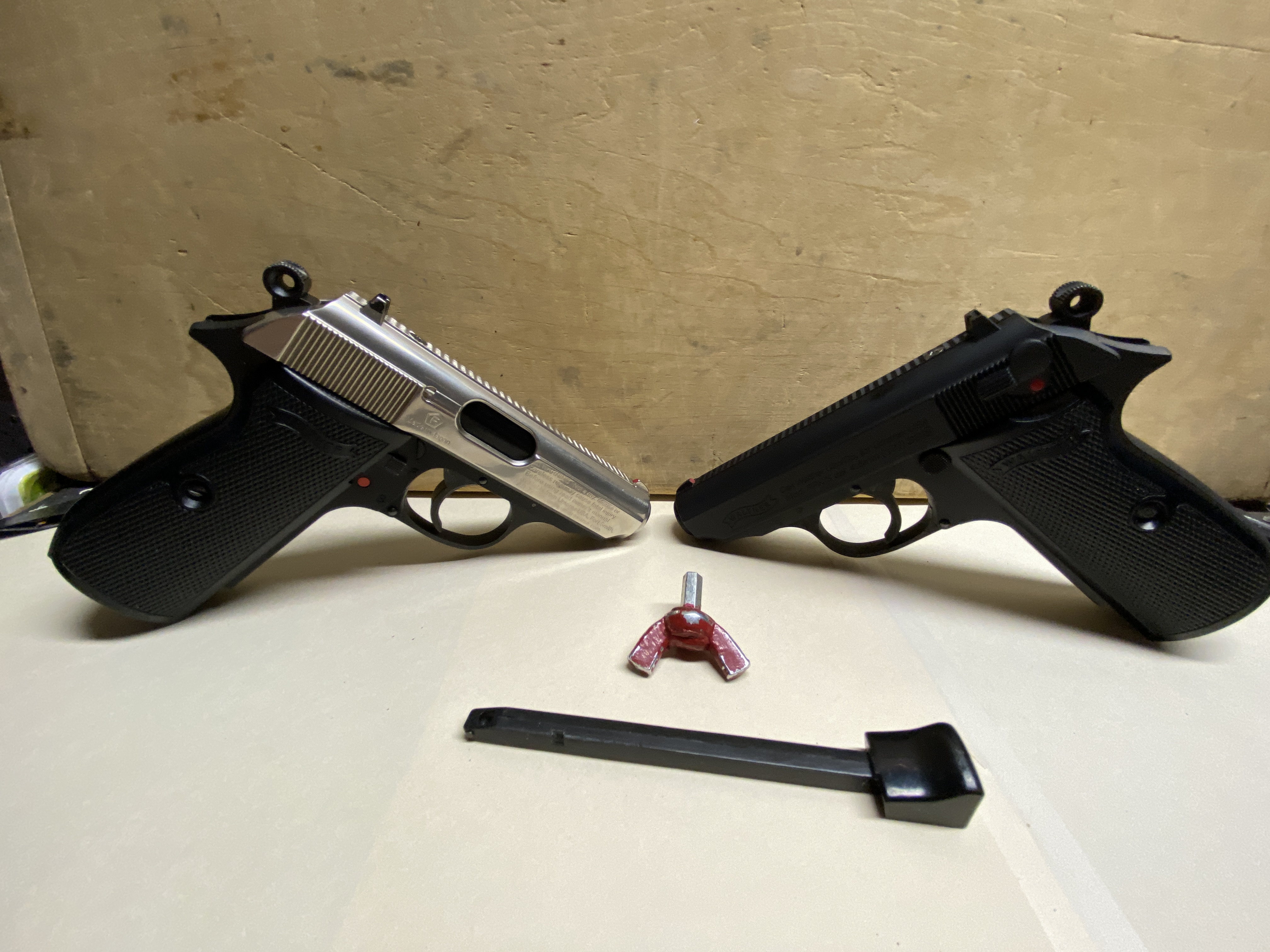

A couple of months ago I was thrilled by my newly found ability to make replacement CO2 seals for my old style Walther PPK/S pistol from Umarex. They cut and went in easily and the cartridges would last a good long time, and I could put two to three cartridges in before needing a new seal. Maybe I need a harder Polyurethane sheet- like 90 Durometer?
This weekend has been a disaster trying to load the above mentioned pistol, and an even newer one, a second generation (2016-23) PPK/S with the flush piercing screw. Both previous seals were not holding gas when trying to load a new tube. Each time once I heard the small hiss of a puncture, then I'd tighten the screw and things would quiet down a bit, then progressively the hissing would come back loader, until it was a full on discharge, with the frozen cartridge and all. There have been no traces of gas coming out of the barrel at all. I tried different inner and outer diameters for the seals, RWS Chamber Lube, Crosman Air Gun Oil, Silicone grease, Bars Leak auto transmission sealer, and even surrendered to trying Plumber's tape on the end of the tubes- all ending in the same hiss- Hiss-HISS, HISSSSSSS failures. I tried tightening the piercing screws on both guns, fast, slow, and as softly OR as hard as I dared for fear of damaging the bottom of the frame of the gun.
The only difference is the temperature in my basement now that it is fall. Instead of high 60's or even low 70's down there its in the lower 60's now. This has not been an issue last late winter or spring though. I am totally stumped. Any ideas? HELP!

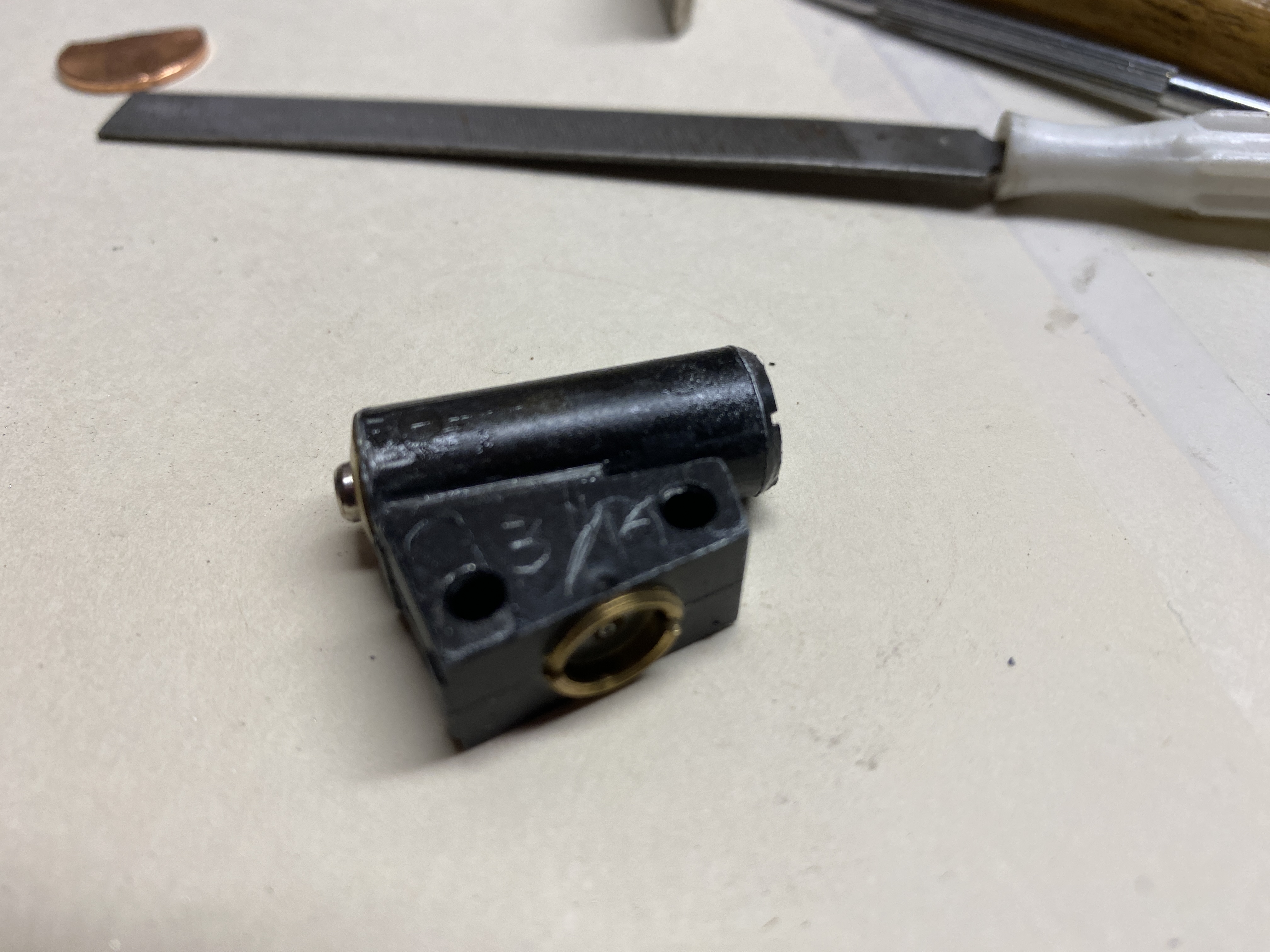

I got lucky on a hunch today and was able to repair both my PPK pistols. The cartridges went in easily and the 2nd series one was silent - no hiss at all, but when pulling the trigger there was an authoritative POP.
About 2014 or so the Japanese subcontractor who made the pistols for Umarex started punching the side of the air valves to lock the brass retaining collars in place. Prior to that they were only hand tightened, and these brass collars held the Cartridge gaskets in place. I found that I could remove these collars, but when doing so the threads were damaged a bit each time they were removed or installed due to the punches- see photos below.
Apparently this thread damage caused gas leaks and made it impossible to have a tight seal- and lose yet another CO2. What's weird is that both guns had the same cumulative failure at the same time.
Having bought my first Crosman/Walther PPK in 2002, I had accumulated several air valves to fix leaking gaskets. I saved the old parts and they did not have those troublesome punch marks. I disassembled two internals of the damaged valves and transferred the parts to the valve bodies that were punch free. It was still just a hunch... but I did both guns prior to testing- no big deal I could do it blindfolded now I think....(20 X?)
So it was NOT a gasket problem- they are fine. I've got bunch of partially used gaskets now, but more importantly, I finally solved the mystery leak, and I got both guns back!

The brass collar is the only chaser I could use and it doesn't stand up well to the steel of the valve body (I think?) It is a very fine thread and likely an exotic pitch. The inside of the valve when you look at the threaded area is devoid of threading where the punches are. This a.m. one gun was fine the other, the newer Gen 2 gun was almost out of gas. Today I'll cut a new gasket and put some BLUE (medium) thread lock on the brass collar prior to installing. This is my way to secure it while installing & uninstalling co2, but also to ensure that the brass collar that might be damaged is airtight. It's pretty easy to damage the brass collar- either by the threading or crack it at the narrow neck area cut in the piece to allow you to unscrew them. Finally figuring the big leak out was very satisfying!

There is an indentation lip that perfectly fits an 8mm diameter seal at the bottom of the retaining collar. That lip is like 2mm deep so the seal is flush with it as the seal is 2mm thick and makes it a possible gas leak point. If the seal were 2.5mm thick or even 2.25mm it would be better I'd guess.
