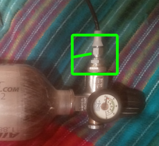

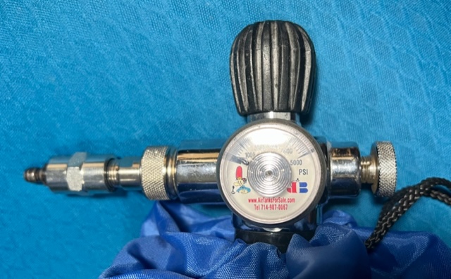

It it possible to re-configure this tank with a male foster?
It's a challenge to fill this tank from a Yong Heng, would be much simpler if it had a male foster with a check valve -
EDIT: no check valve needed, my bad!!

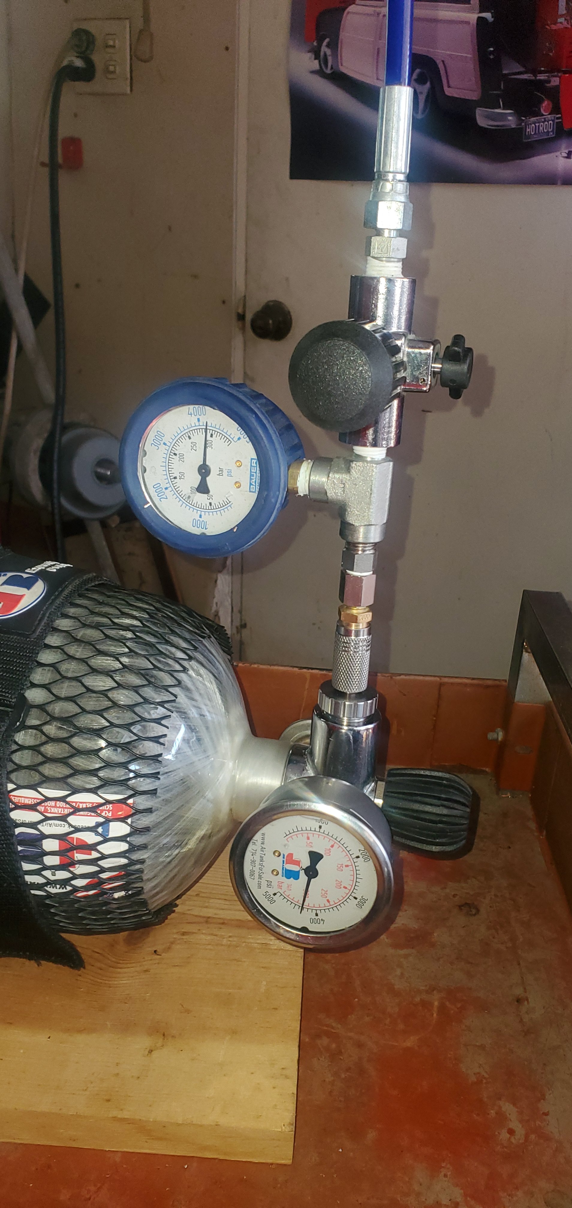

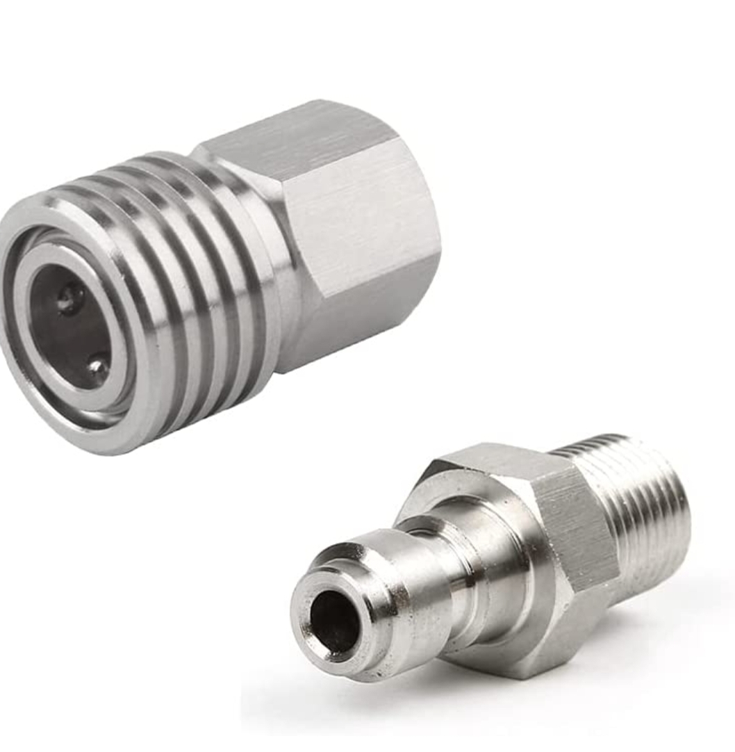

Do you mean like this?
This adapter will screw onto the valve where your fill whip connects.
This is the one I have, but I'm sure they are probably available from other vendors as well. I would think the threads are universal.

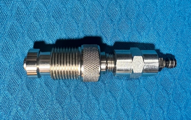

I just purchased a scba tank and fill hose from a member here,,, I just ordered this check fitting today,, male foster to male foster, one way flow
hope the fosters fit my fosters, we'll see,, it was cheap enough

You might be able to simply replace the whip connector at the valve with a matching thread male Quick Connector using a Dowty washer or a teflon washer depending on what is inside that fitting once the whip is removed. That is what I did with my fill station. There is nothing on it but the valve, gauge and the male QC with a rubber dust cover. Much easier to transport with no hose on it, and you can easily insert a one way valve as desired between the whip and the fill station.
You sound like you probably want something removable. Like a quick disconnect and a male foster.
Manloney LLC Universal 8mm Foster Quick Disconnect Adapter 1/8 NPT Stainless Steel Paintball HPA CO2 Air Tool Fittings https://a.co/d/0QwTcoP
