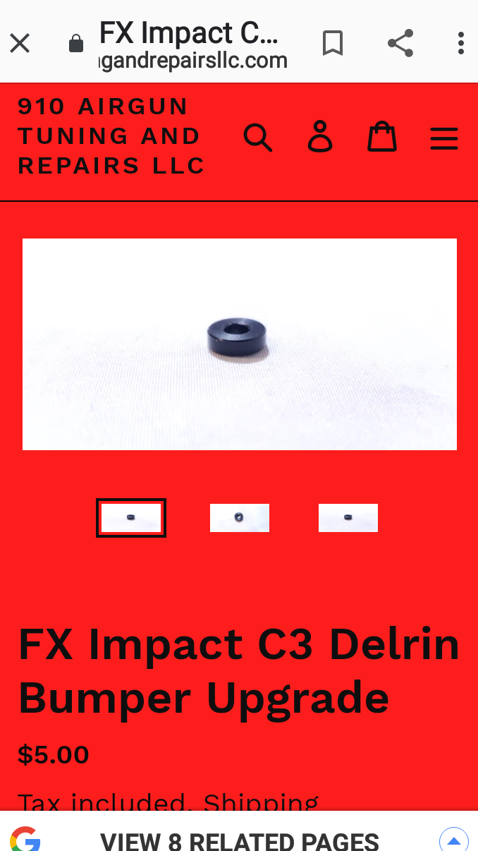

Does yours have a delrin c3 bumper? If not you should upgrade to one and it should last a lot longer than the older rubber ones. The New ones are supposed to already have the upgraded delrin C3 bumpers as a longevity improvement so it doesn't get squashed like the old ones. Good Luck. Yo!

now there’s the question where to get a delrin one as fast as possible, cause I’m located in Austria
Check your local hardware store you may find something delrin that fits too in the plumbing faucet and automotive and general hardware o ring section if you don't want to wait for shipping delay. You can always buy a bigger one and file or sand it down to fit perfectly. Be advised by upgrading to better longer lasting delrin you may not be able to lower your power down all the way. You can get a couple of replacement same size o rings while you're there so at least you can get that Impact shooting quickly and know that its very simple to swap out quickly anyway now that you know what is the weak link. Good luck. Yo!

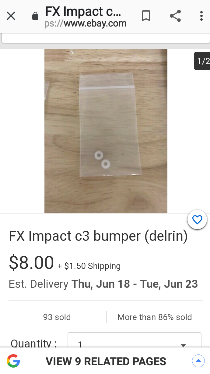

Found a seller on eBay and ordered in the meantime.
i think a have something similar at home to replace the broken one till the Delrin one arrives.
