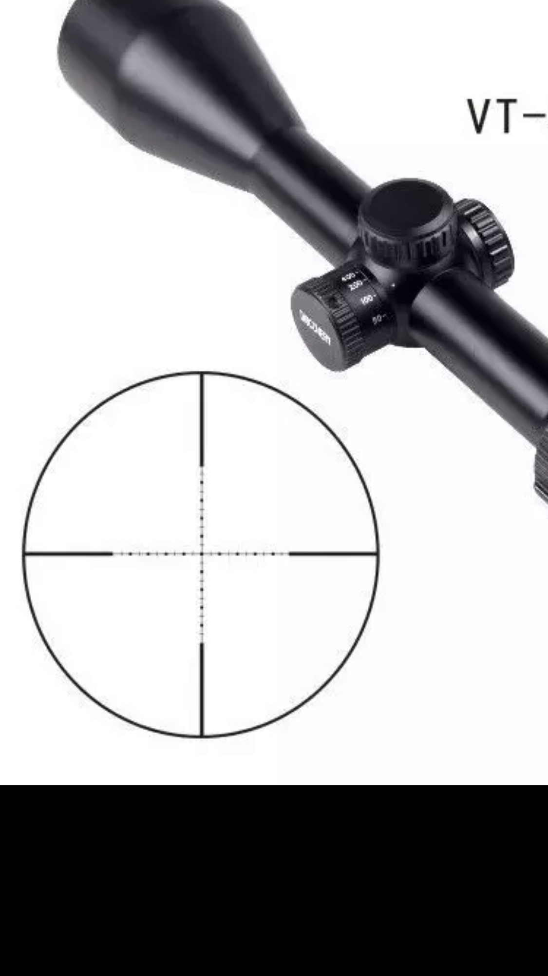

I have a 4-16x44 scope. Will this reticle be sufficient? Im used to MiL in my other rifles but would like to use this one if possible.

You can start with this scope, but will want to upgrade down the road. For FT, a big side wheel will help you range. If you're shooting Hunter class, 16x is the max magnification allowed. The problem with w a variable powered scope that maxes at 16x is that you're not getting the resolution that a 24x scope set at 16x does- at least in any scope I've used below $2k.
Imagine a car that can hit 150 mph maximum speed. At that speed, it's straining, working real hard to sustain that velocity for a long period of time. Now get a car that can go 200 mpg, and 150 mph is just loafing around. Having some headroom in your optics gives you that little extra bit of clarity at the top end of magnification. And that clarity is what allows you to range 45 yards vs 50 yards correctly with scope.
Imho.
You can also use target width or other techniques for ranging, but commonly, parralax is the tool most shooters use.

Looks like a MIL retical ... Fit a 5 inch or more side wheel to it, get it scaled to what you actual see at KNOWN distances your good to get started IMO.
