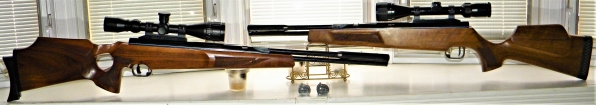

The Theoben SLR rifles were extremely well made underlever repeaters. They are not made anymore and are as pricey as a very nice PCP if you can find one for sale.

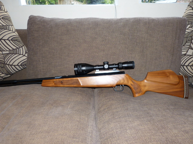

My first thought was the Hatsan Proxima, which given its origin is unsurprisingly accurate, solid, and heavy. It received some attention when it was announced shortly after the first Gamo Swarm actually hit the market, but hasn't made nearly the splash that the Swarm has made. It's a wood stock only, I believe, and is pretty much a bench shooter due to length and weight - though I suppose it can also be used from a hide or static hunting/pesting position. Accuracy seems really good from what little I've seen posted. Not a German gun, but one of Hatsan's highest-end springers so likely to be a lifetime shooter.

The SLR has a Ansultz barrels? I don't know much about them but from what I can remember they are good, correct?
OP asked about LW, SLR has an Anschutz barrel according to my manual
Correct. Some if not all had the Annie barrel. Especially like that you can completely rebuild the gas ram at home with basic tools. Only problem mine has is it will crack the mag window unless a slight bevel/clearance is made to keep the base of the pellet probe from whacking it during the inertia of the shot cycle. I made polycarbonate replacement windows with steel pins and they all hold up great now.
