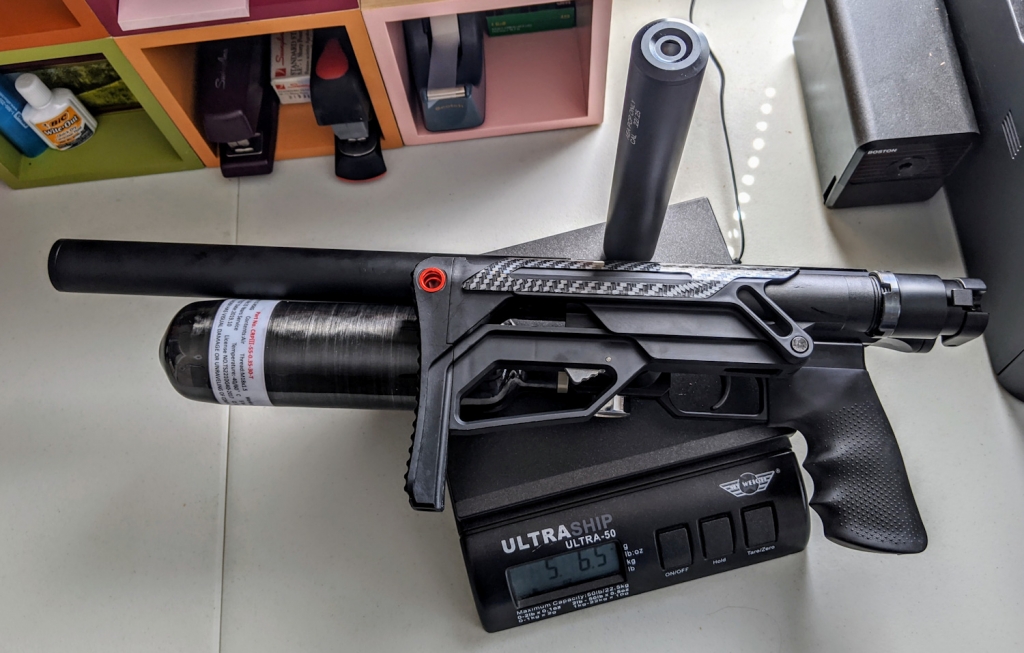

This is my packable toy; semi-auto AEA Backpacker. 19.5" with suppressor removed and stock folded. 50 shots with 35 fps spread. 25 if I keep it to 20 fps but that isn't necessary for my hunting. Shoots JSB 18.1's super accurately at 880 fps.
Any good? Reliable? Semi auto? Easy to back the power down and still shoot reliable??? Yo
