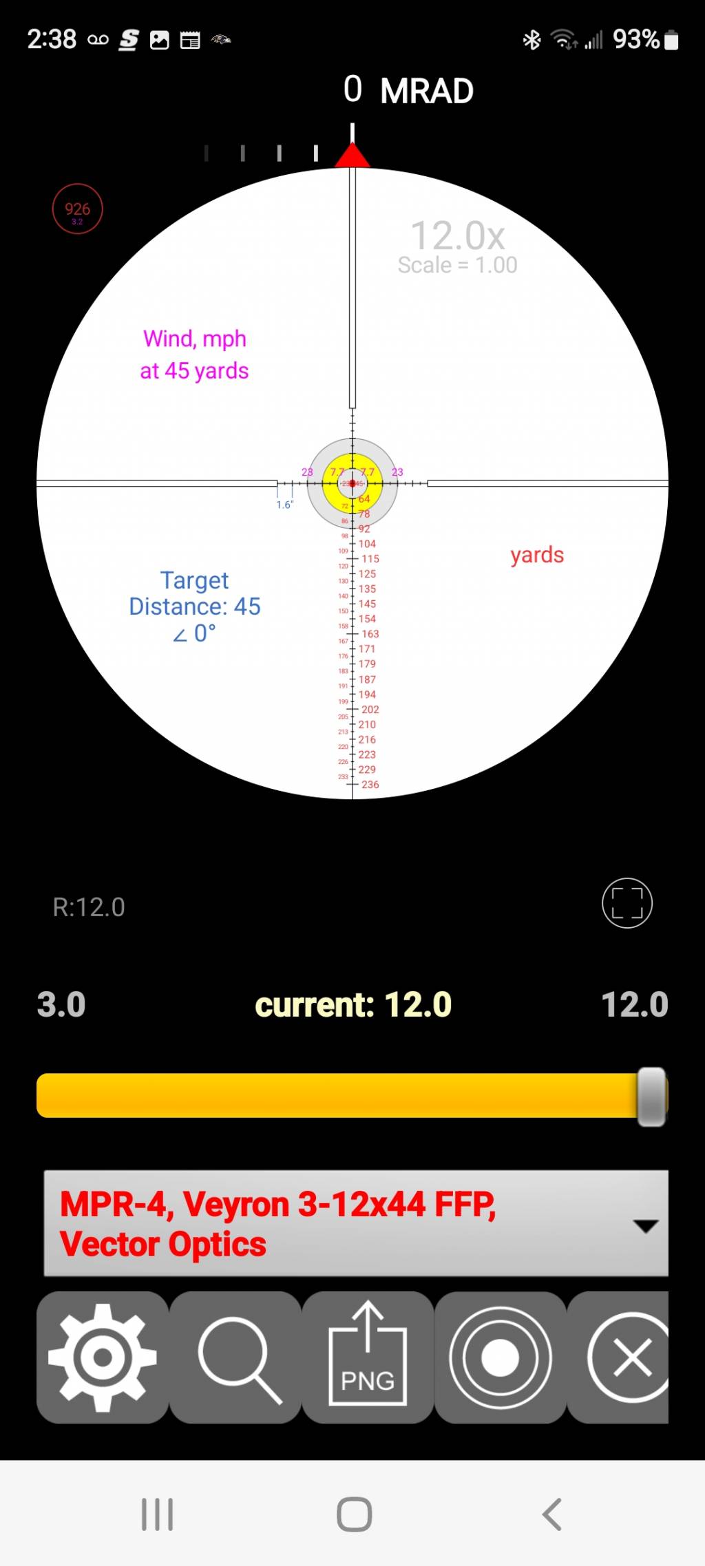

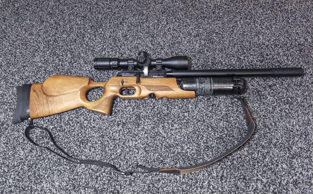

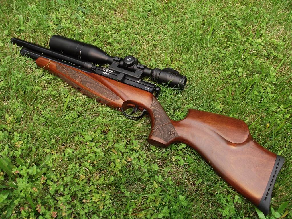

If you have to shoot to 75 yards, and have it be super compact, you're in bullpup territory. However... I can pull this off with my Crown. The gun doesn't seem all that small, but with compact barrel it is very comfortable to Cary. I also use a sling should I choose to not carry it in my hands. The real trick is that the barrel is extremely light. Making the gun feel about 2lbs lighter than it is. Now, I do have much more compact guns (usually tuned in the 550-700fps range) and sometimes I carry them, but as this is, this is super comfortable, maneuverable, and the most capable of my lot.

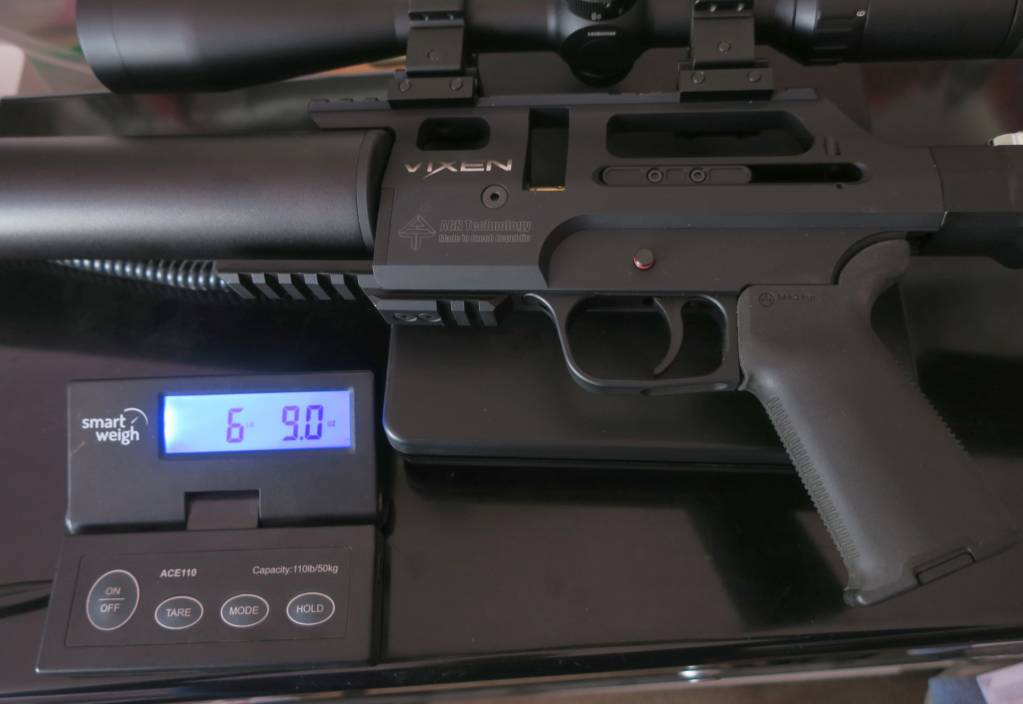

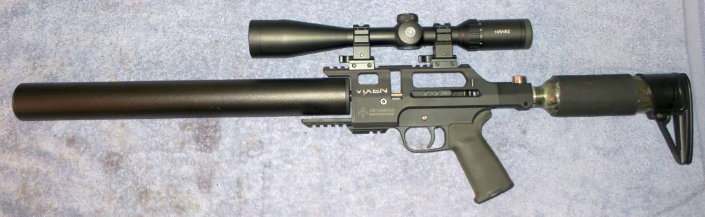

AGT Vixen - long or standard, take your pick.
One standard version currently posted on the AGN classifieds.
I have had both the standard and the long. I sold the standard when someone on this site posted a WTB ad. It was shooting a little soft for me with its short barrel (.22 cal JSB Hades at ~790), and the buyer wanted something he could actually tune down when pesting in areas of soft backdrops.
My Long version is a real keeper. Muzzle velocities easily in the 890's with .22 cal Hades or 15.89's. Incredibly smooth and pleasant shot cycle. Very accurate with a great trigger and robust + easy to use magazines. Light and easy to carry (as long as you don't install a big, honking, heavy scope.) Easily back yard friendly without need for any additional moderation. Reasonably priced.
Highly recommended.
Any downsides?
1) With its abbreviated butt stock you are limited in real estate how you will rest it on a rear bag, if that is how you shoot off the bench;
2) Goes through a lot of pellets! ;)

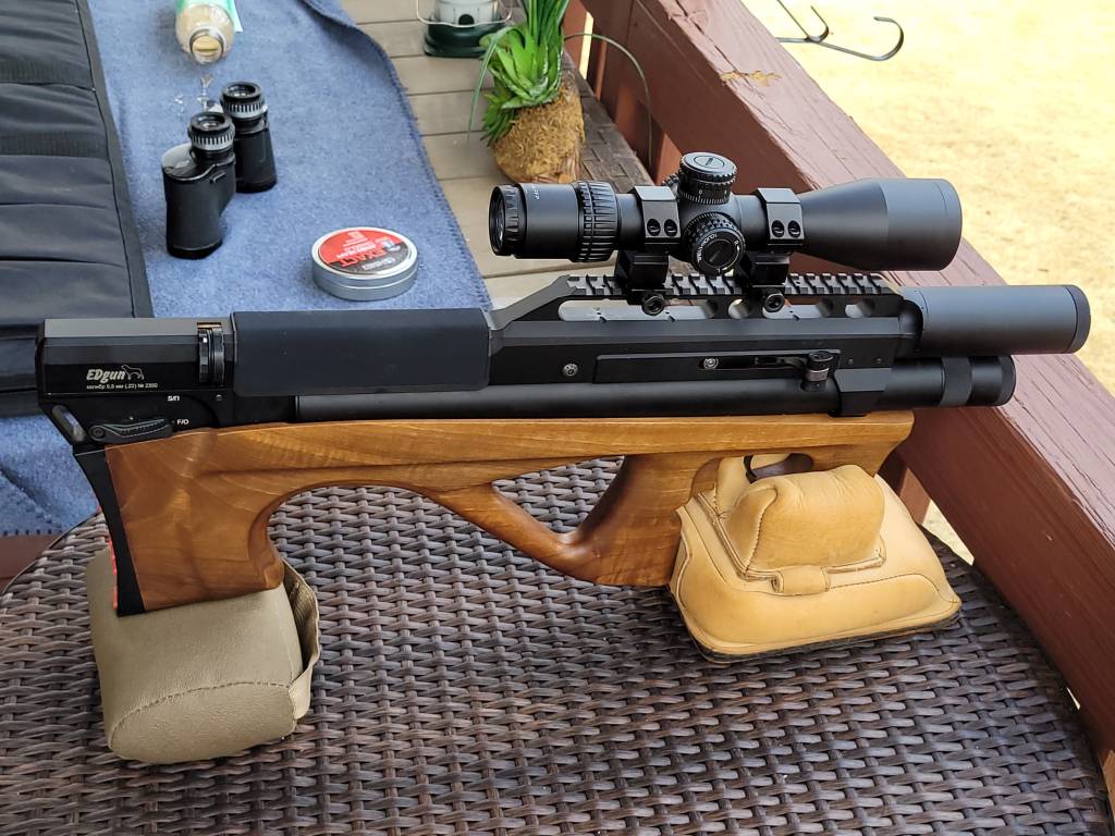

Anyway, thanks for the ideas. I might drive to AoA a couple of times as they are only a couple hours away and finger-fondle some of these. I'm not in a hurry and want to do this one right. I'm not going to lie, I am really warming up to that Edgun and that little FX has my eye now also. I still like the Brocock XR too. Maybe I'll swing something by Christmas. Who knows, maybe you guys will point me to something else...
