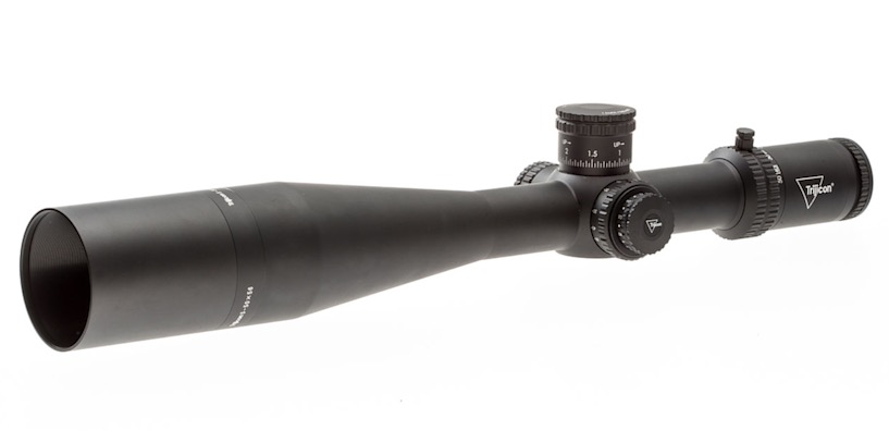

So many of the ones for 10- infinity have crappy radicals too, love one that show a pin point center dot like the Trijicon 5-50 that I have but looking for a second scope for a second Crown that has a better reticle then the 8-32 Hawke that's on there now and compared to the Trijicon that has no CA it's not as clear ether
