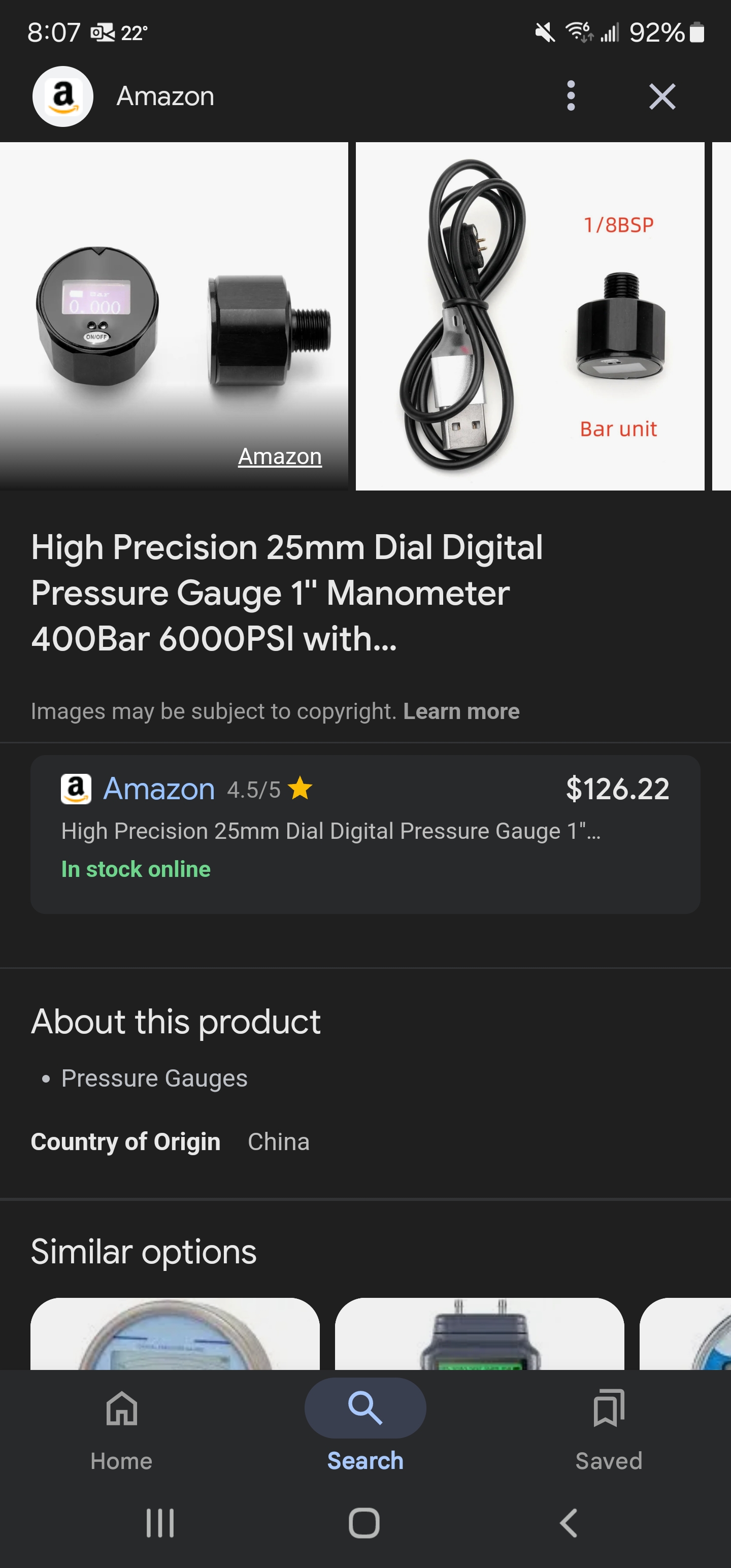

Sorry wrong one. The m8 one is on airguns of Arizona. 28mm omega digital gaugeAmazon has one.....I haven't tried it but was thinking about it after I financially recover from the custom carbon shrouded 24" Lothar Walther barrel im waiting to be delivered..lol

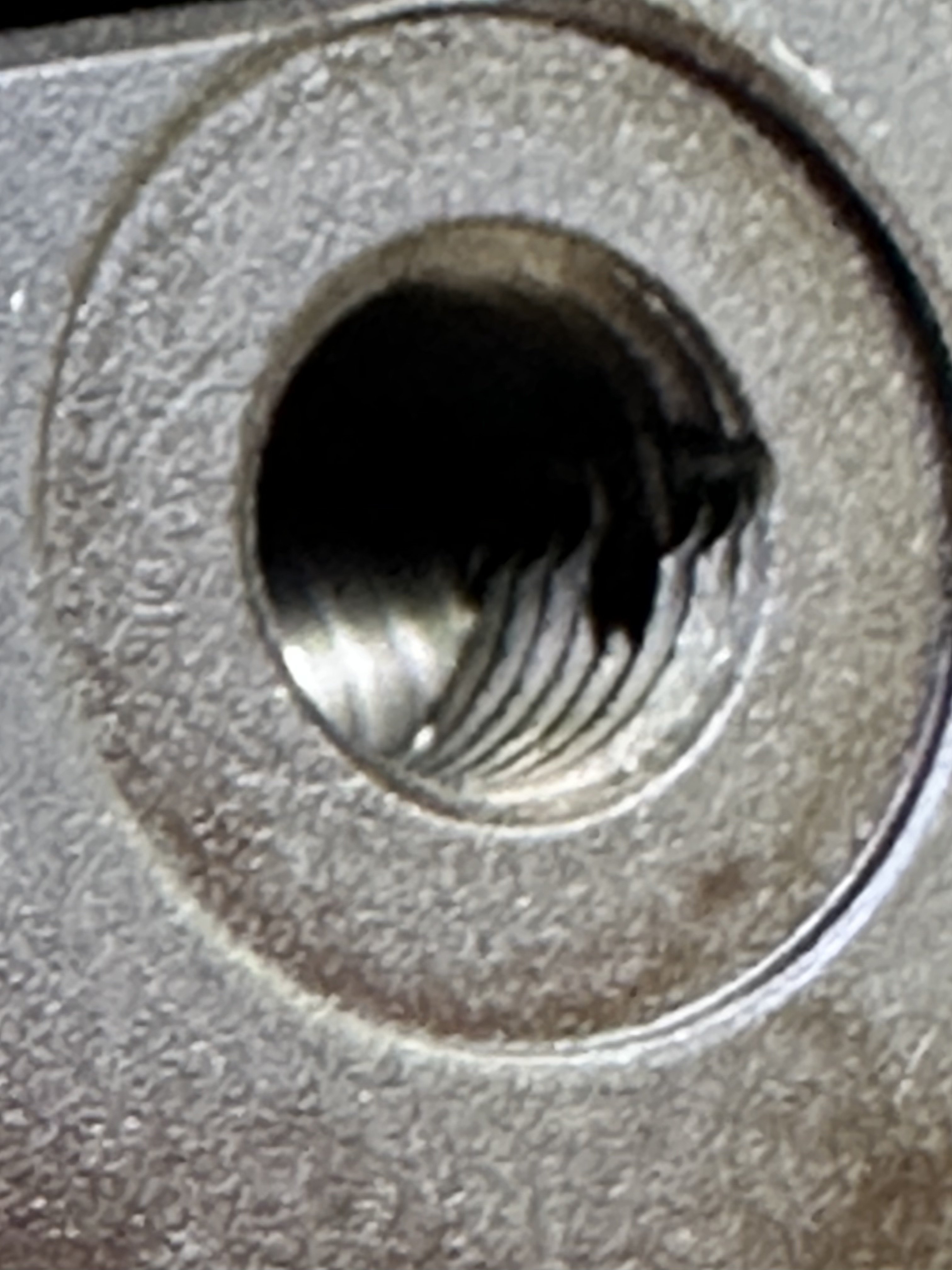

The email I got from Sekhmet said to use the Dowty seal and hand tighten, no wrenches. I installed it and still have a leak at the Dowty seal. Did you use the Dowty on your install? I also took a photo of the inside of the high pressure side, are these threads supposed to missing a section toward the outer edge or is this a blowout?There's a setting that allows you to change the amount of time before it shuts off automatically and also there should be a little icon that shows the level of the battery and of course you can change it from psi two bar or whatever your preference is
Are you 100% sure its leaking at that seal? Turn with a wrench slightly.The email I got from Sekhmet said to use the Dowty seal and hand tighten, no wrenches. I installed it and still have a leak at the Dowty seal. Did you use the Dowty on your install? I also took a photo of the inside of the high pressure side, are these threads supposed to missing a section toward the outer edge or is this a blowout?
No I’m not sure at all now. I spent about an hour on the phone with Ted at Air Venturi, explained my situation and one of the first questions he asked was whether I had changed the 3 orings on the axle. Of course I had, and had 3 old orings laying on my table. He helped me find replacement Dowty seals on Amazon, and after I got off the phone with Ted doubt set in. I took the gun apart and unscrewed the axle and saw the 3rd oring; nope, not replaced. I rebuilt the gun, noticed some leaking, cocked it, refilled and so far it’s holding 281 bar which was all my tank had left. I left a message at Air Venturi apologizing to Ted. Hopefully I have my fix, but ordering the Dowty seals anyway.Are you 100% sure its leaking at that seal? Turn with a wrench slightly.
